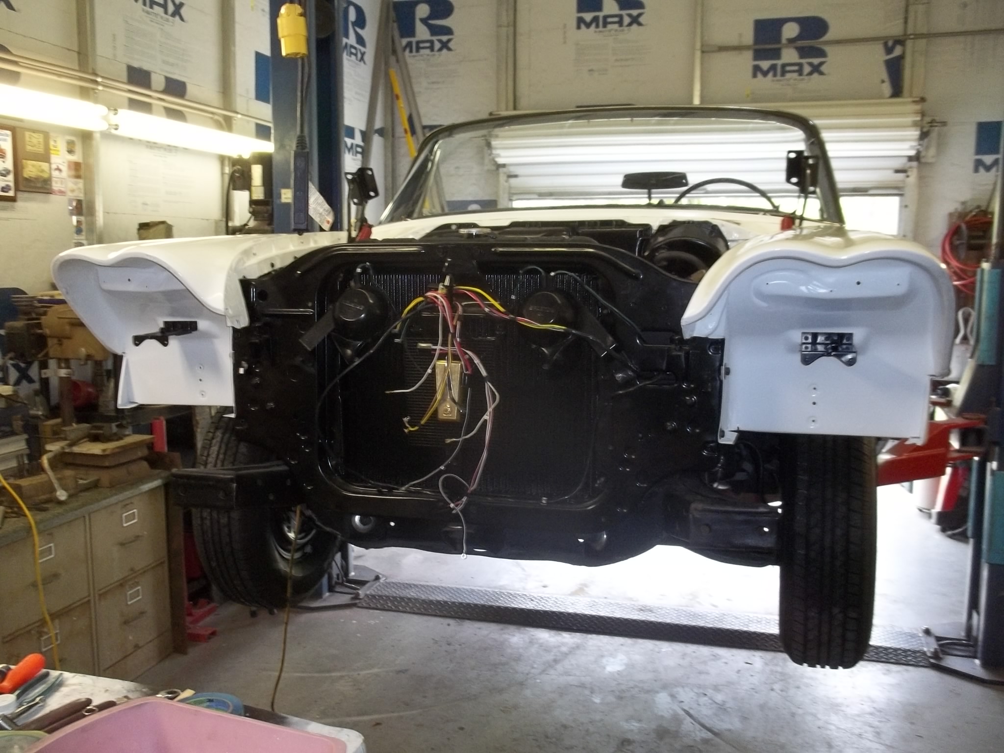

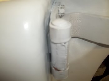

PUSH, PUSH, PUSH. Took the driver door off AGAIN, elongated the holes in hinges to get top of door closer to windshield stainless and will glue 1/8" spacers to back of hinges to move door rearward. Pray for me. Messing around with the doors really screwed the paint up on the hinges, door post and bolts, sanded the area and tried some Rust-o-leum rattle can appliance white epoxy and Walla an exact match for the Eastwood Pure White. How lucky can you get, gonna thank GOD tonight when I say my prayers.
Ahhh shucks Dick, glad I can help....oh you were not thanking me...My bad. :lol:

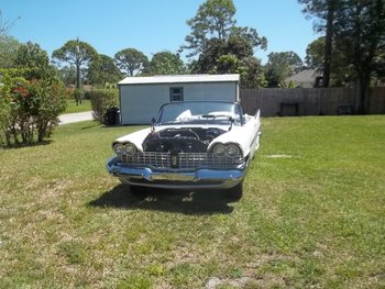

Computers still in the shop so no pictures. Got the drivers door back on and it's a lot mo better. Not as close to the windshield stainless as I would like but I can live with it. Got the steering better but needs a little more adjustment. That little control valve on top that the hoses connect to slides back and forth for adjustment left or right but man it's super sensitive. I took it for a ride yesterday around the neighborhood without fenders and hood and a quilt over the front seat. Nice smooth ride and very quiet, has a lot of spunk for a 2bb. Next is the fenders, hood, grill and bumper. Then off to the upholsterer.

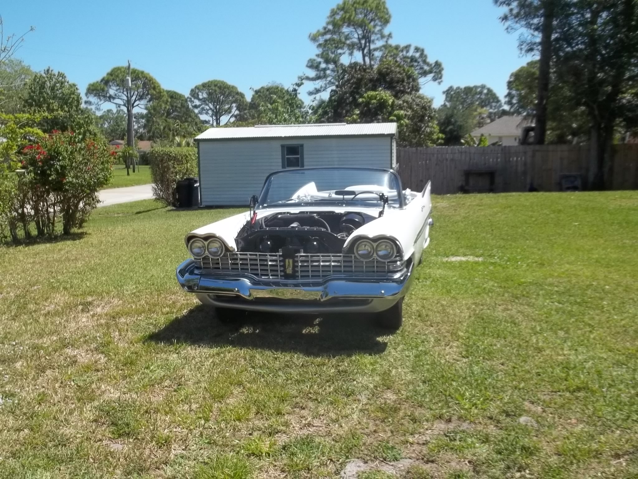

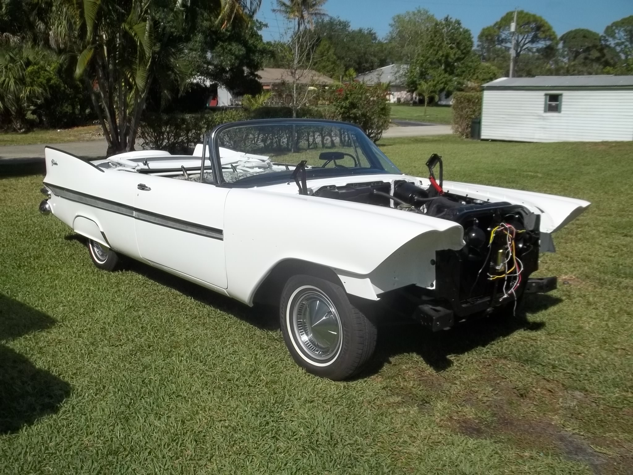

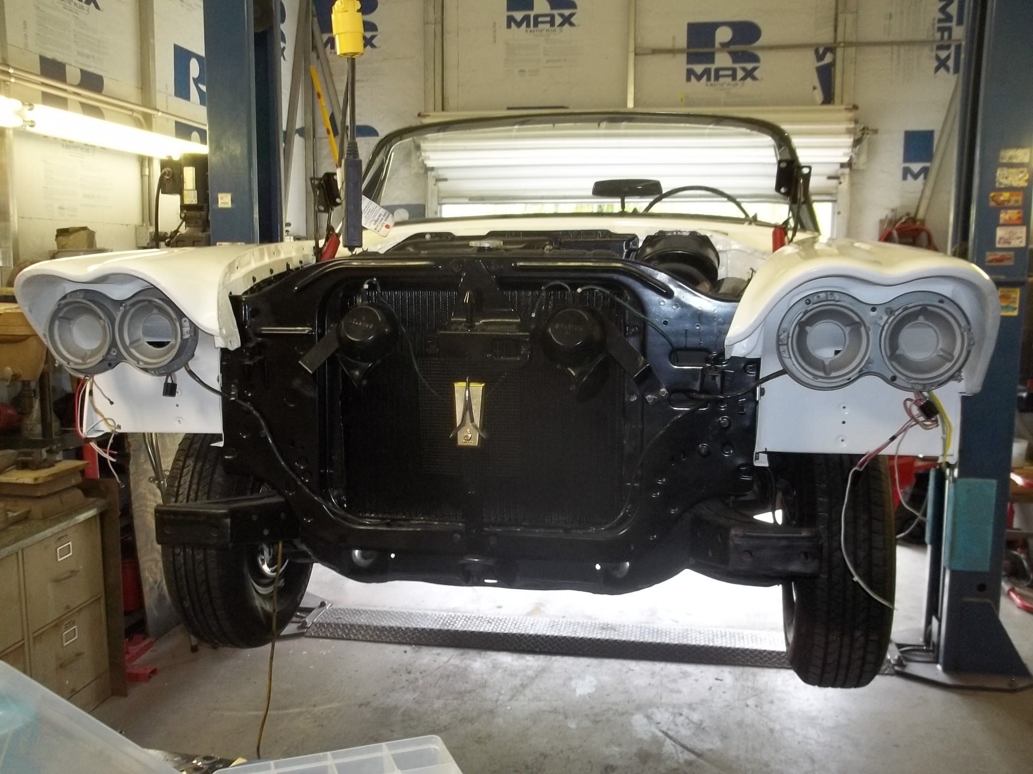

Got the fenders on today, not as easy as you would think, I was wondering what those 4 studs with the nuts on them were for, I finally figured it out, they go in the top of the radiator support, threaded from the inside, then a washer and nut go on after the fender is on. Got my computer back today, so as soon as I get all the pictures back in order I will send some.

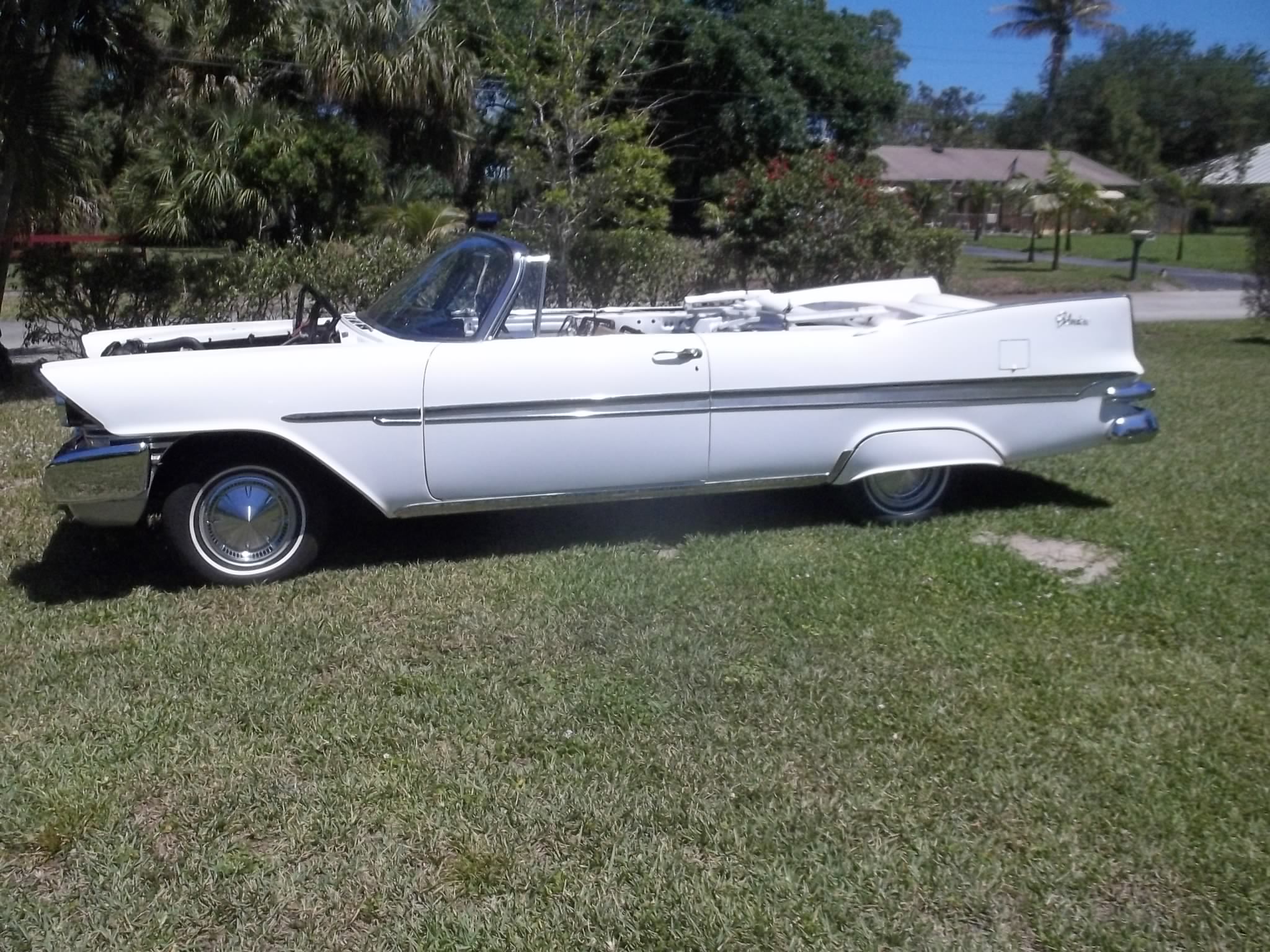

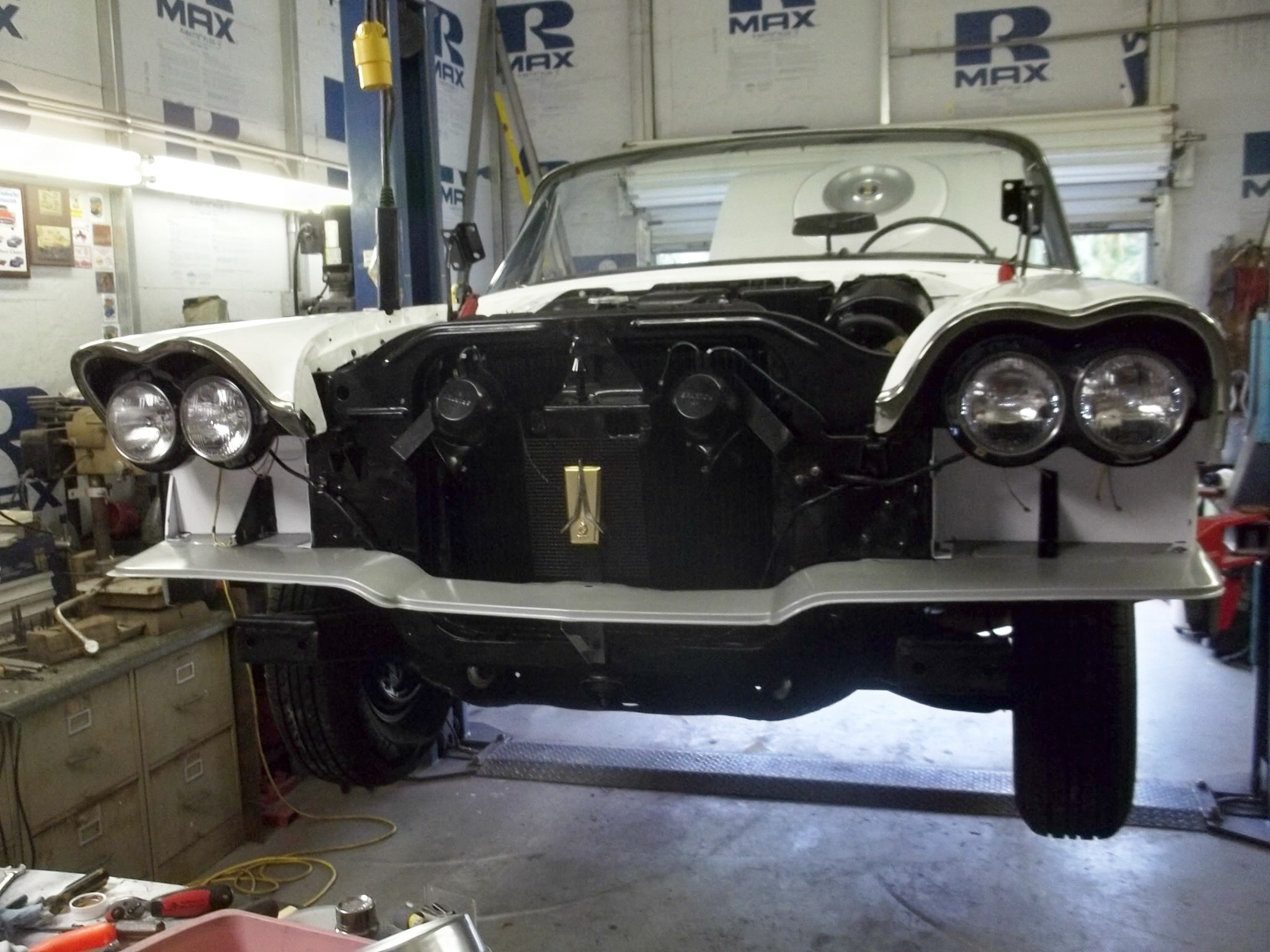

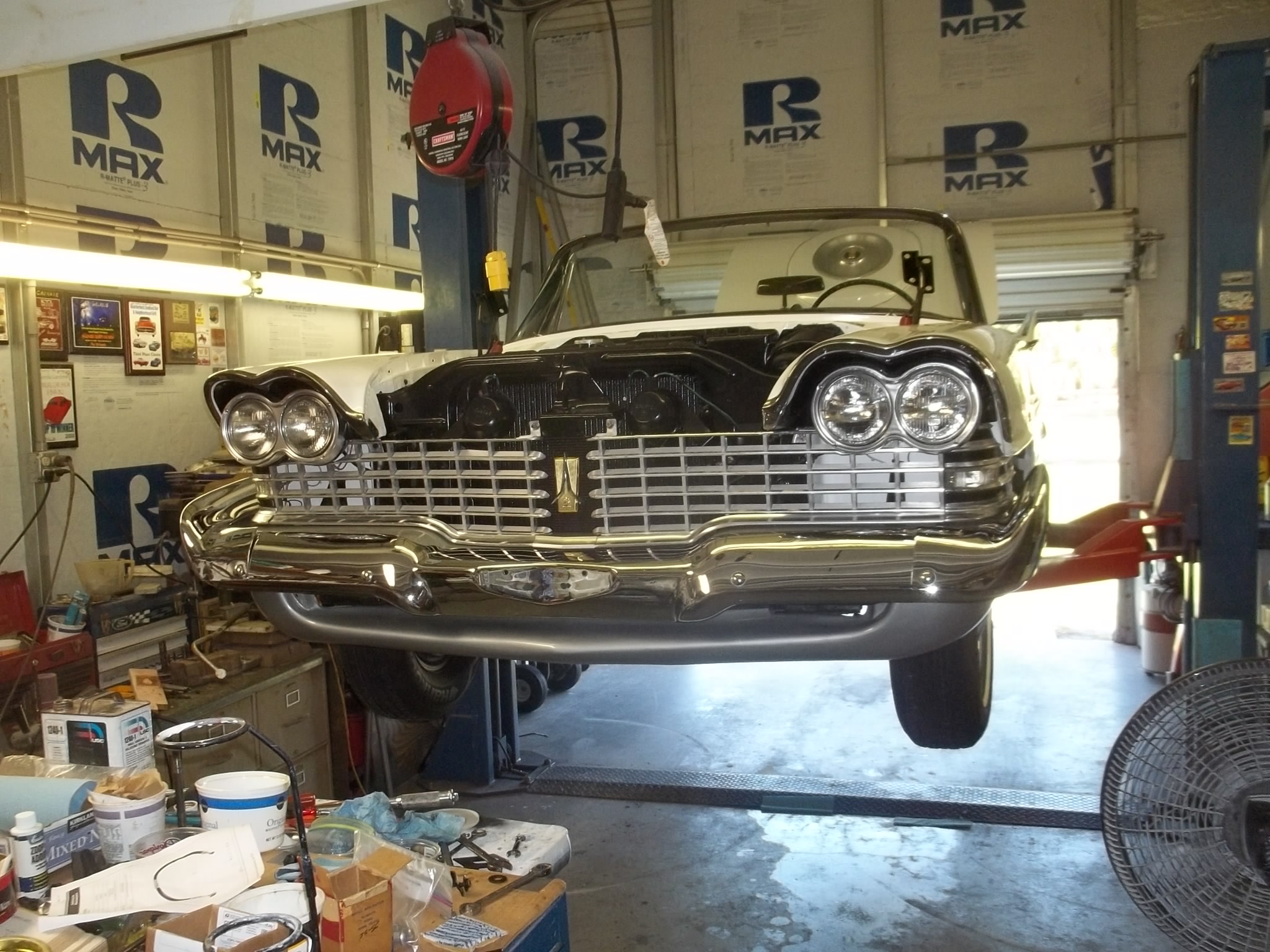

OK, where wuz I at? Thats southern for "let me continue". Got my computer back, they updated it from Vista to Windows 7. Big difference, the only thing is I lost about 2,000 pictures and the rest are scattered all over creation. It will take a long time to get them back in albums like before. Made great progress on the Convert. If I repeat myself I'm sorry. Got shims on the door post hinges and made all the difference in the world, now I have to do the passenger side. Got the fenders on, splash pan, lights, remaining trim including rocker mouldings, Valance, front bumper and wings. Took it for a spin today runs great and quiet. The steering is still not quite right, I'm going tomorrow to have the front end aligned, hope that will straighten it out.

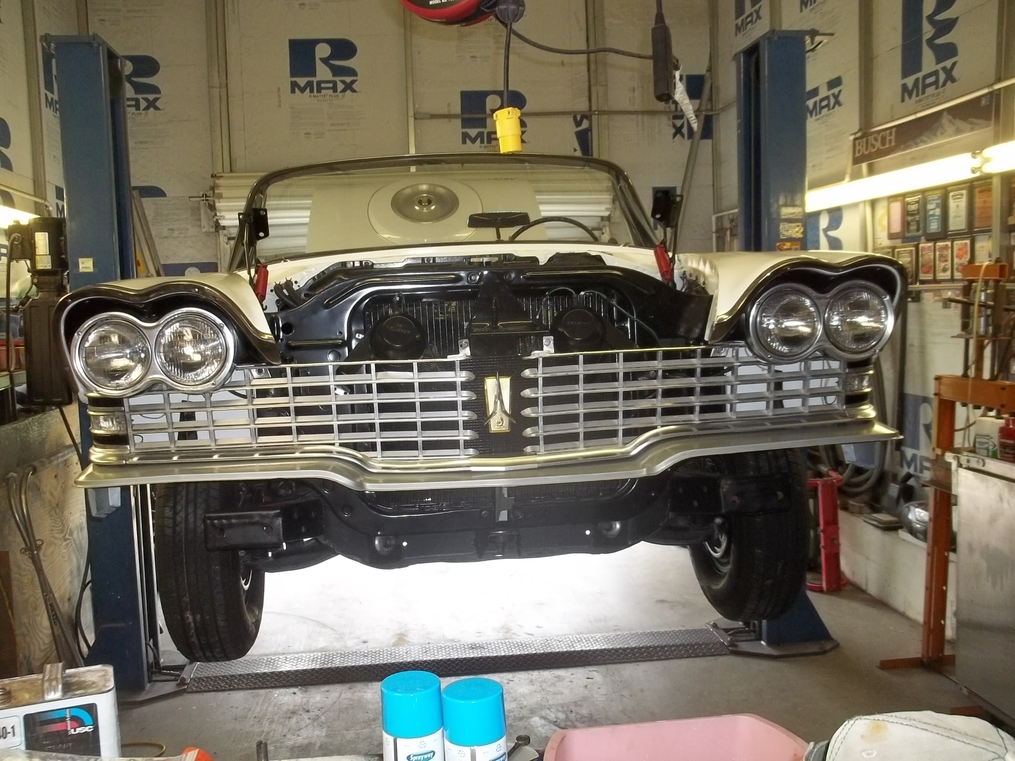

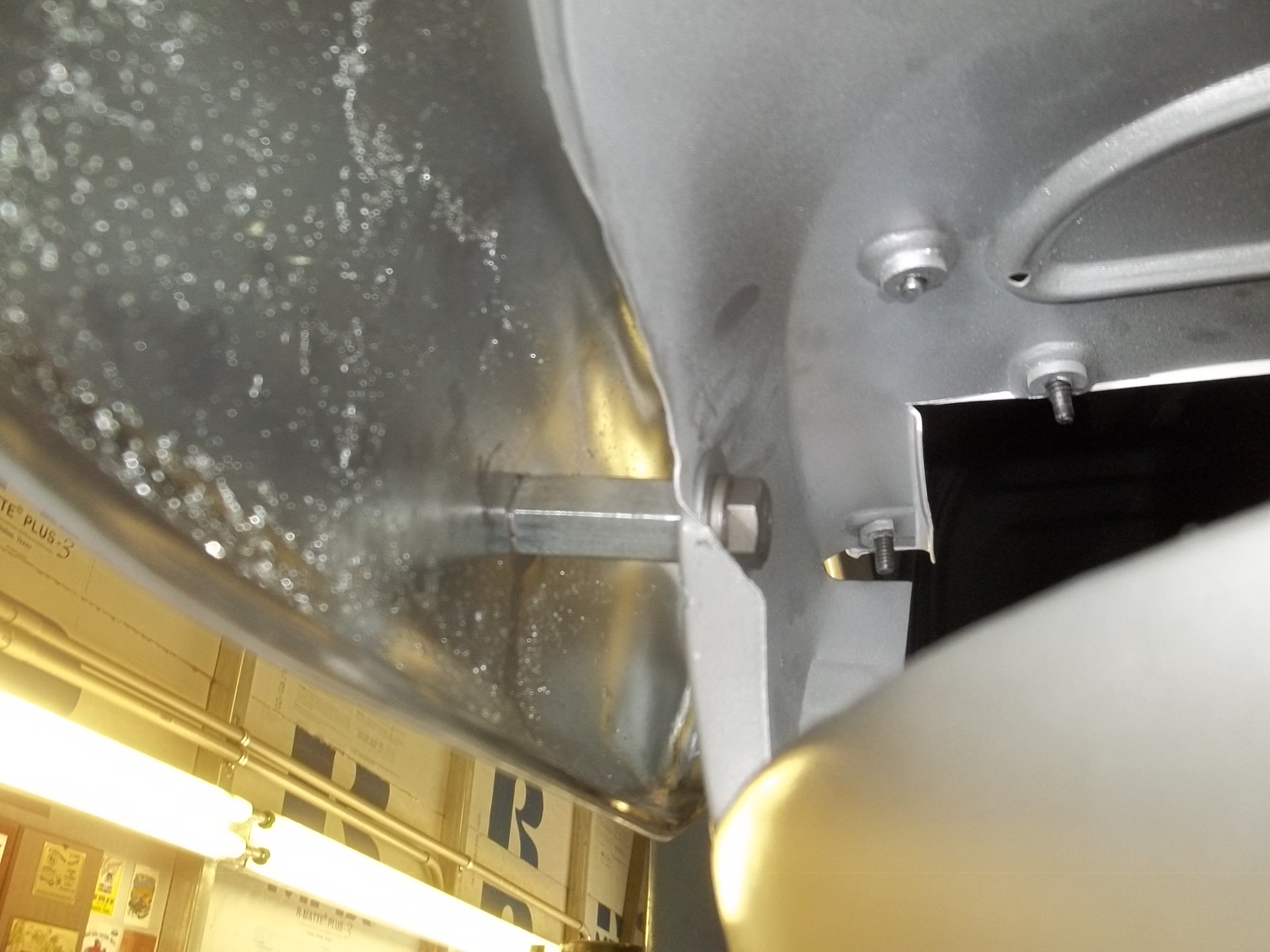

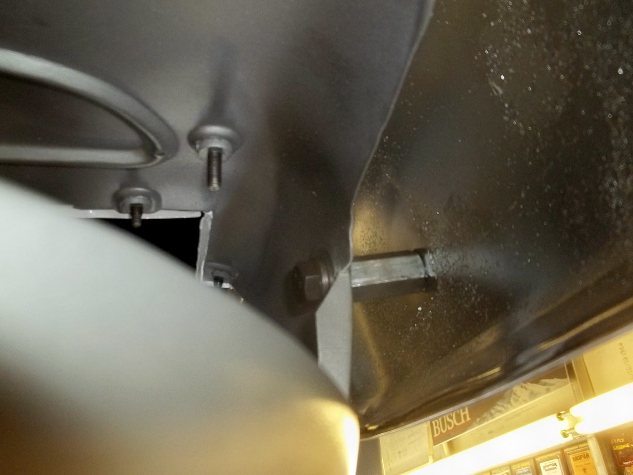

John - Regarding installing the wings on the front bumper. When I did Charleens wings I have a Jury rig for the attachment to the Valance which I have never been happy with. Problem solved, The carriage bolt in the wing bracket is 1/2" - 13 thread x 1" long. Home Depot has 1/2" -13 x 1-3/4" coupling nuts that you screw on the bolt in the wing then a 1/2"-13 x 1" bolt thru the valence into the long nut. Fits perfect and is solid as a rock. I have included pictures. It's ready to have the seats done and the top installed hopefully next week. SMS is jerking me around on my door panels, It's been one year and 3 months and I still don't have a firm delivery date. Oh, I forgot, I still have to install the hood and fender braces. If anyone has a pair of outboard braces that supports the splash pan and valance I sure could use them.

Dick - fabulous pix! Matthew and I both love the fender skirts! :lol:
