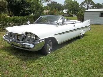

Dick Koch's convertible
I am not partial to fender skirts, but the rest the the beast looks way better than Factory Fresh!

Thanks Guys, It's getting there.

Looks great Dick! You do great and quick work in comparison to me. I like the use of the nut extender for the Bumber Wings, that may help me out.

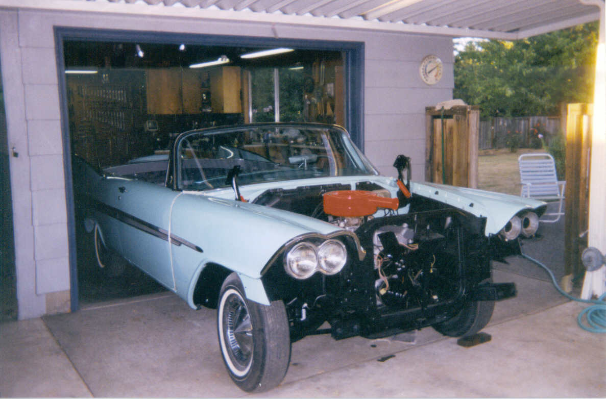

Don't forget( if not to late..) to spray some flat or low gloss black below the headlights area (above too if you can) at the front facing of the fenders so you can not see the white paint thru the grill. Just a detail point you can take it or leave it.... I picked up this point from Tom Fox's restoration on his Belvedere...

Here is a picture of Tom Fox's blacked out area for those who wanted to know...
blacked out front fender area

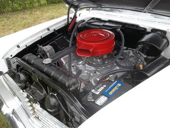

OK, Bertha Irene is more completer, whach'all think. Still some gap problems at the left front fender and hood. Took the 1/8" shim out but didn't make much difference. Looks like crap but don't know what else to do. Well there goes my 100 points car. Yea, as if. The only major stuff left is Upholstery, Top, Top hydraulic system and door panels (It's been a year and 4 months since I sent SMS a check). Oh! I forgot about the gazillion other little things that will pop up.
