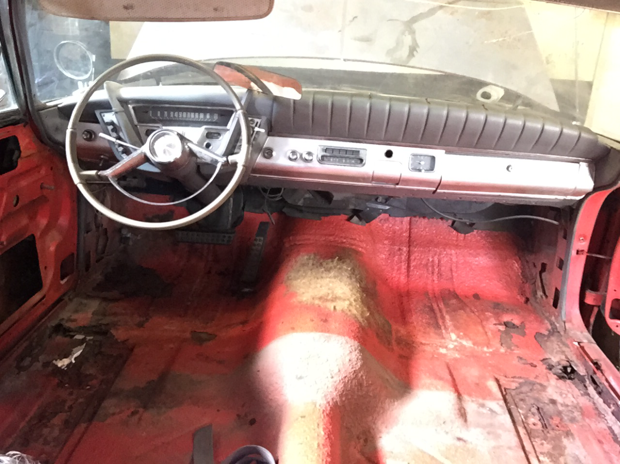

Dad had stripped paint before he passed away 6 years ago. I've had her in storage ever since. Finally decided to start the restoration. Got her to run and drive down the block then I pulled the carb and had it rebuilt. Dropped the fuel tank and ordered a new sending unit from classic car auto parts Item #: S-CRPD5759 (hopefully the gas gauge will work). Had to replace ignition cylinder lock as I lost the keys. Had lock smith make new key for doors/trunk. Bought some por-15 to clean up the under side and paint it before re installing gas tank. Tank didn't look bad inside, will clean it real good before coating exterior and re installing. Then I'll drop the carb back on and fire her up again.
[Did a little image cropping - Editor]
Trailered her to my house.
Removed seats and carpet to assess rust.
