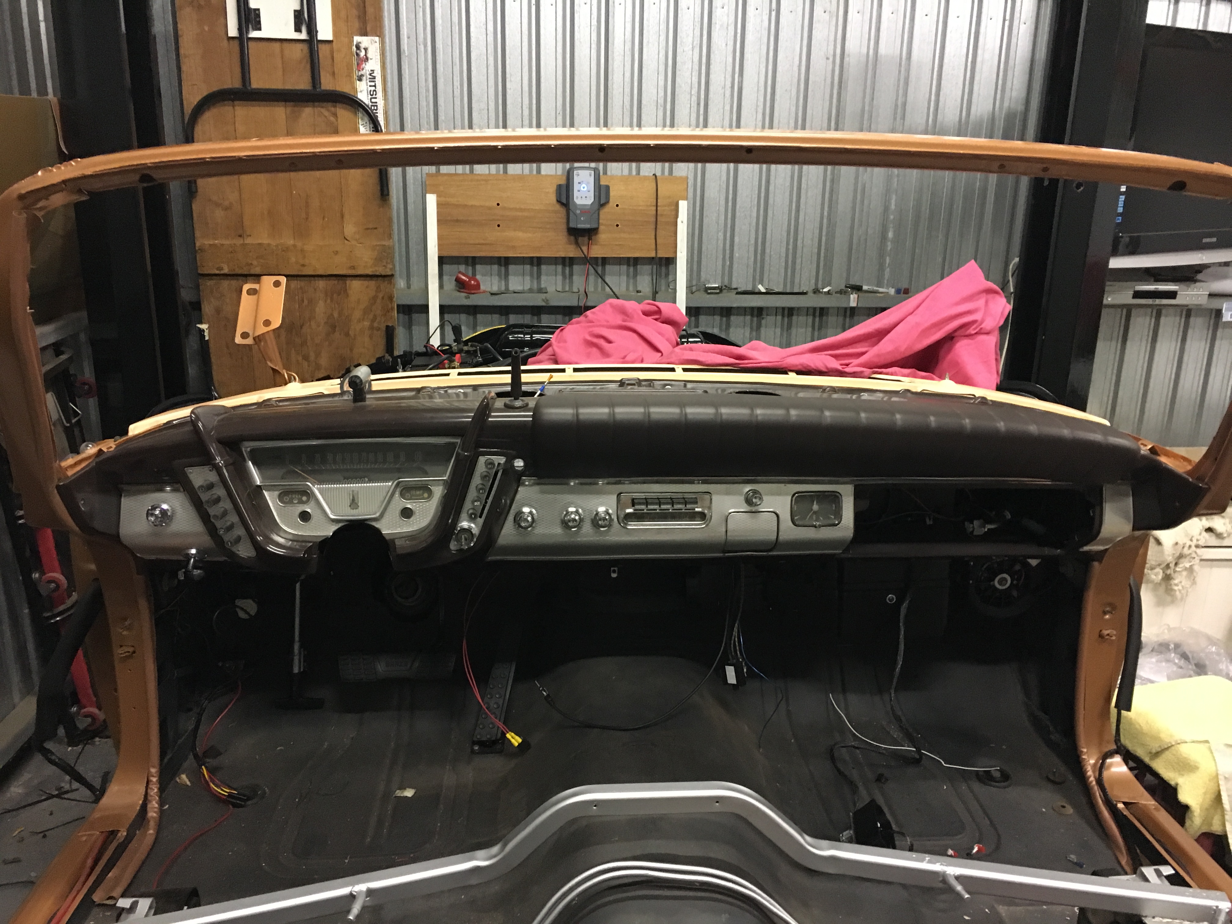

Some minor updates
Wiring pretty much complete and dash installed
Re: little by little
Wow! That's damn good looking :shock:
So clean, Vic. Puts me to shame!

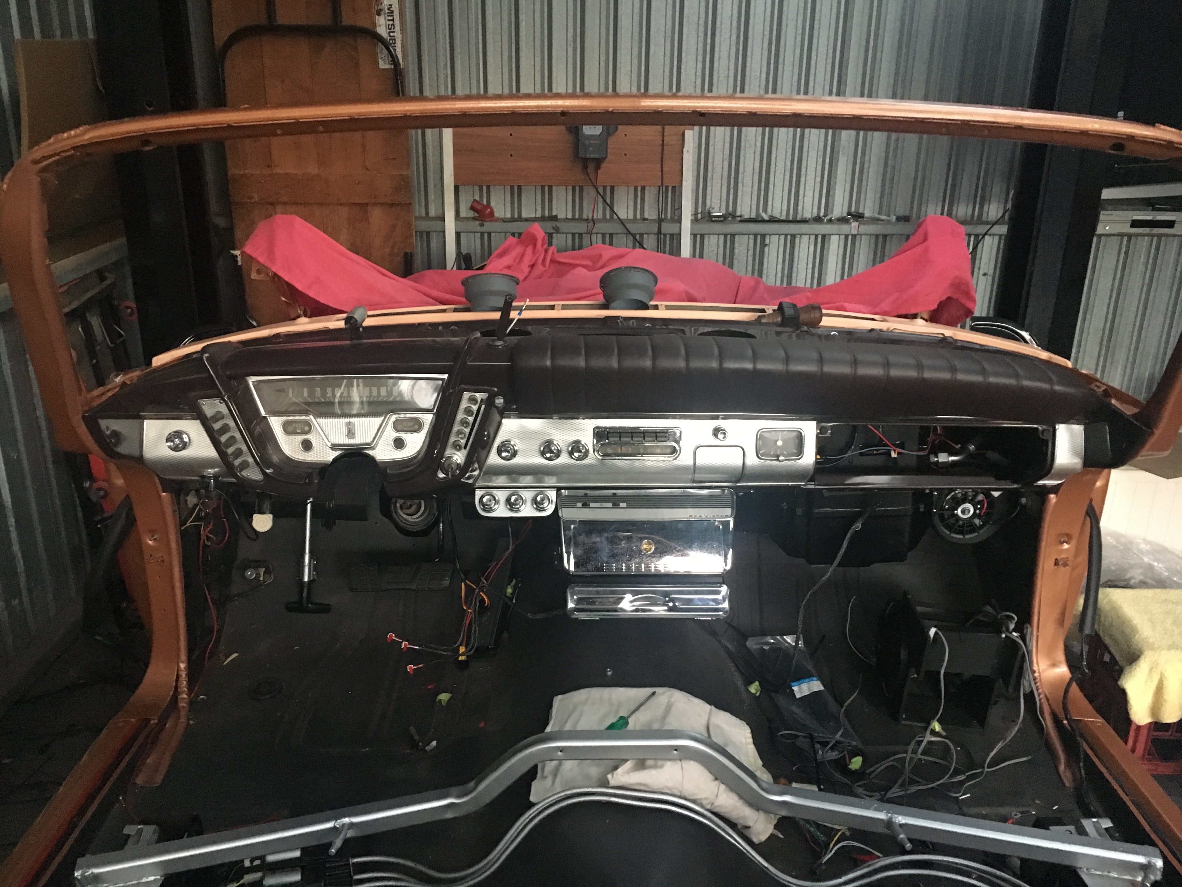

Hi again
An opinion if you please
Made up controls for the air freeze a/c unit to try and blend in with dash- thoughts ?
Record player - should I mount it level with floor or
Mount it at the same angle as the base of the dash
Any criticism truly welcomed- not sure if it's going over the top
Also I'm unsure how to wire up the windshield washer pump wiring to the windshield controls
The controls are variable speed and only leave two connections once you connect the motor
The foot controls have 4 connections
Any idea? Can't find the details in any of the manuals
I assume that if connected when you depress the foot pump it automatically controls the windshield wipers?
Record player level with floor
Record player inline with dash angle
Customized a/c controls
I'd say level it with the floor. Looks better.
It looks like there is too much going on when you put it in the dash angle.

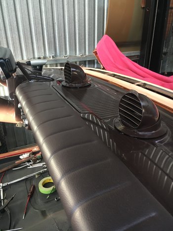

Got my mirror back and its working
Also installed the speaker grille and ac outlets that came out of a desoto
Pretty happy with the airflow from the Vintage air unit
Ac outlets pop up and swivel
