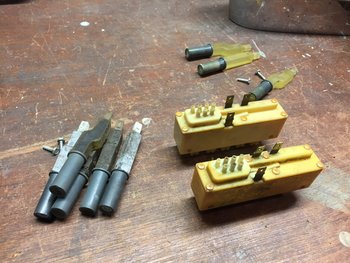

I've attached pix of two units I have, I think the first is better than the second, but I'm not sure what might be going on in the inside. Both have all their pins, and no sign of melting. Should I send them both to you to evaluate? Do you need me to send the female connector as well?

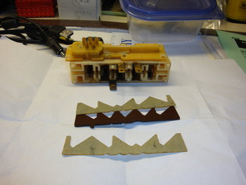

Perfect, what goes wrong with them is the fiber board cams they use break down over the years due to the grease inside getting hard. Then the cams will not slide and they get destroyed. We CNC [computer numerically controlled] machine new cams out of delrin and clean out the vacuum ports and electrical contacts. See attached for an idea of what's inside. The button extensions you should be able to pull off with a slight side to side motion. If you want to send them along I will open them up to confirm but normal rebuild without vacuum nipple replacement is $85 plus shipping.

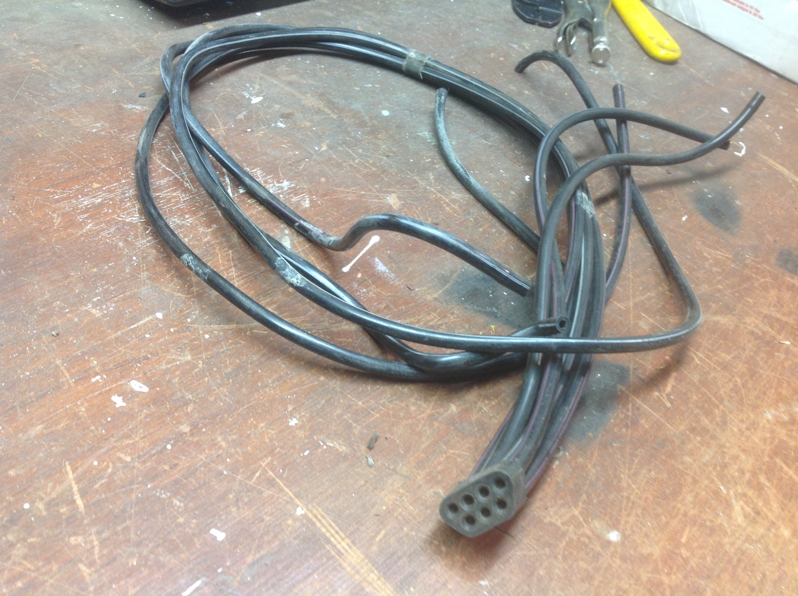

Will do! I'll be testing the switch like in the video, with all the vacuum motors, and using the transfer pump that came yesterday. The black tubing on the left is what came with the pump, the one on the right I snipped off of a spare connector - I'll need to get a coupler at Ace or AutoZone to test the motors.

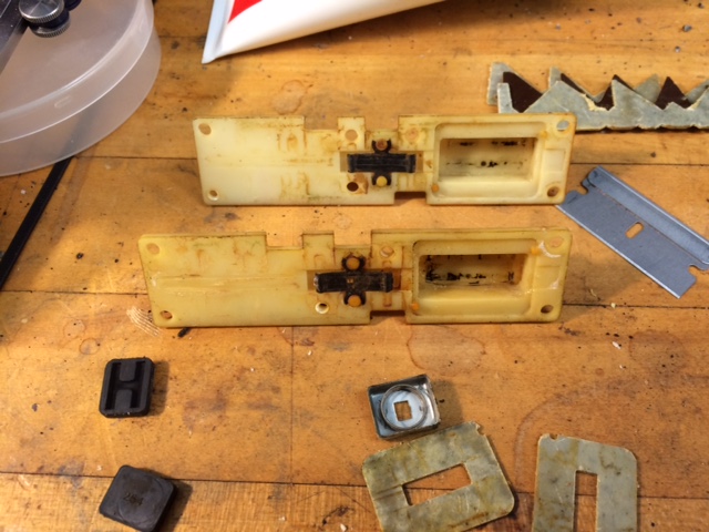

(Note to self: This is how the buttons go back!)

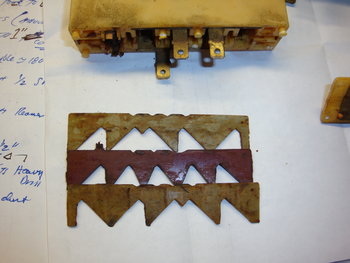

Your switches are complete and will go out in in Friday's mail and you should get them Monday. No surprises, a few of the vacuum ports were clogged and some of the cams were worn and the typical hardened grease that makes them hard to move. I am attaching a few inside photos so you can see the inner workings. If you have any problems do not hesitate to ask.
