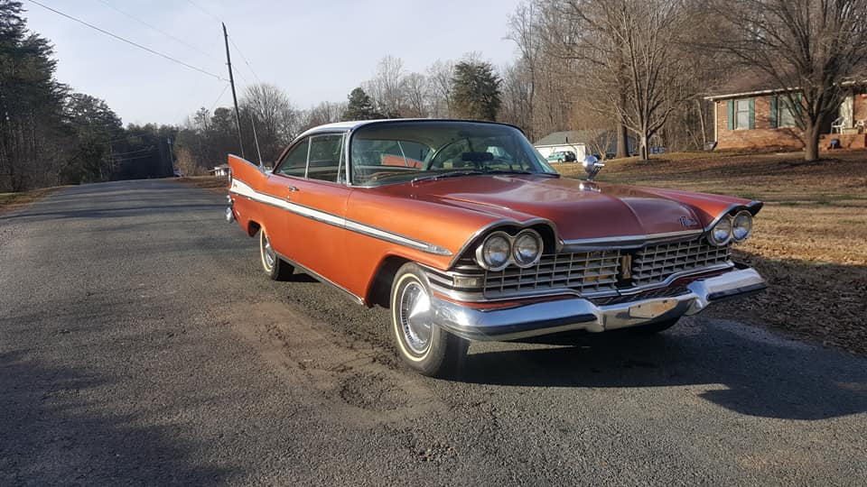

Thanks for the info.Here is more pics of the car. You can also follow the project on youtube.
https://youtu.be/byUAdDYW9gU
Does anyone have a bell housing for sale?
Re: IBM Punch Card Info...
I just checked out your vid!
The fabric inserts on the seats and door panels are non original and it’s missing the buckles. Dash pad has been replaced too as it needs to be black to match the black dash.
The clock and ash tray + lighter are standard equipment on the Sport Fury.
It’s looking really good though!! What are the plans for it?
