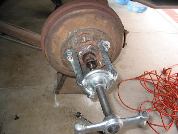

So the first question is, "How do I get the drum off this thing?" This is where that "tool" comes in. Below is a picture of the special puller required to remove the drum/hub assembly from the axle. These pullers are still available through Miller Special Tools (Universal Wheel Puller # C-844), but many times they can be found on eBay as well.
You'll need a good sized sledge hammer as well (the first time you remove them anyway). When the hub is reinstalled, a little anti-seize will make this process much easier if it ever has to be repeated. Sometimes it takes patience, fortitude, a big hammer, some penetrating oil and a little heat to get one of these things off, especially if it hasn't been removed in 20 or 30 years. However, if you keep at it, you will eventually be successful. The trick sometimes is not only to smack the wings of the tool with the hammer (which tightens the puller) but also to smack the end of the puller to "jolt" the hub loose. One side may come off quicker than the other. Patience is the key.

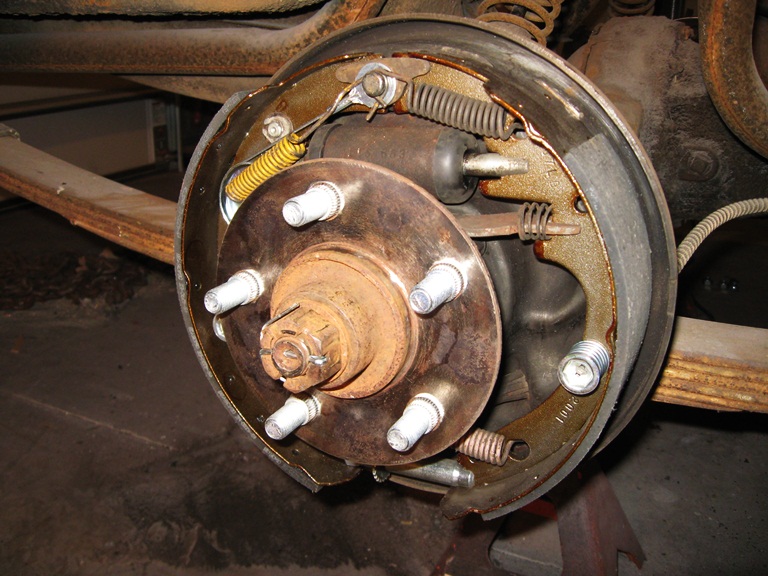

As you can see above there is literally no brake material left on these shoes. The difficulty of removing these units is why people tended NOT to service them as often as they should... and never in some cases. As you can see in the picture below, the hub is "keyed" in position on the axle. Although this is kind of an "old" way of doing things it still works very well. Don't lose this key...they are very hard to replace. The brakes are pretty much typical for any Mopar 8.75" rear end so there will be no surprises there.

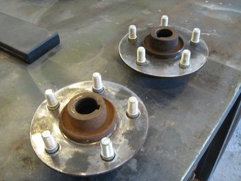

On to the hubs. When the hub/drum unit is removed it will look like the photo below. This unit is all one piece because the lug bolts are swedged onto the brake drum. This is a procedure where the hub and drum are assembled, then the lug bolts are expanded where they contact the drum. This, for all intents and purposes, rivets them together.

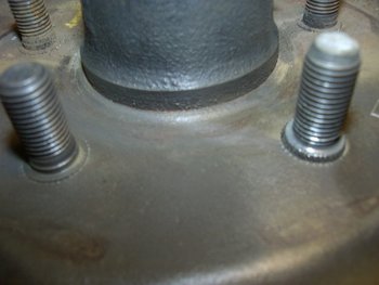

Below is a picture showing what a swedged lug bolt looks like when compared to one that has not been swedged. The lug bolt on the left has been swedged and the one on the right has not. You can see how pressure has been applied and the lug bolt has been "riveted" to the drum. Certainly not the way to do things if you want to make servicing easy.

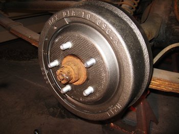

When you reinstall the hubs on the axles, it will save you some work if you clean the axle and inside surface of the hub with a good solvent. This will get rid of any rust or other contaminants that might make it more difficult to remove the hub again if you ever need to remove it or the axle. You may also choose to coat the axle with a little anti-seize compound. The nut is torqued to 120 ft/lb and is held in position with a good sized cotter pin; this is not all that different than how front hubs are held on- and they're full of grease. So a little anti-seize can make disassembly a lot easier if the axle ever has to be removed to service the pumpkin. Below is the installed unit ready for the brake drum.
Now for the best part. NAPA lists the rear brake drum for a tapered axle car (in this case a 1964 Dodge), part number ND 4401056 for $92 each. You no longer have to use these expensive drums. You can now use the 1965 and later drums, part # ND 4401129 for $37 each. All that's left to do at this point is to adjust the brakes and slide the new drums on. If you ever need to do brake service again, just slide them off... it's that easy.
