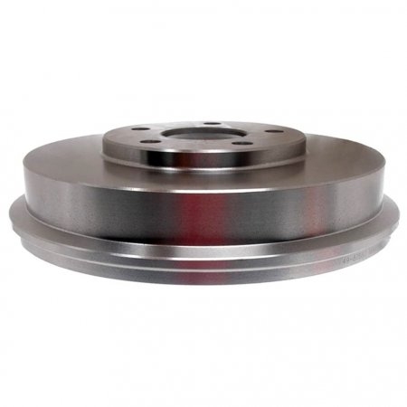

Re: Tapered Axle Rear Brake Conversion
2955R from Raybestos.
They don’t have the hub in them. The drums are a bit wider so you need to have the rear lip cut off or make the backing plates fit.

Center (Axle hole) bore on the Raybestos 2955R worked fine? I can't seem to find that information anywhere I loom.
Mike, is your question does the hole in the center of the 2955R drum clear the hub as outlined here?
The answer to that is yes. However, what doesn't fit is the drum itself, without alteration. The depth of the drum is deeper than that of your original drum. Matthew suggests that it might be possible to trim the backing plate where they collide, or cutting the lip off of the drum. I don't know which path he took, or how easy it is to do the latter - perhaps he can advise here.

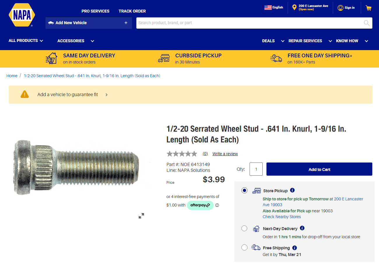

Where is the loose fit? Is it in the holes in the drum around the studs? This from the article:
Here's where the fun begins. You now need to press in new studs. The stock lug bolts on these old Mopars are 1/2-20 UNF thread with a 0.622" knurl. The knurl is the ridged part of the stud that fits into the hub. In order to have a good tight press fit you need to make sure whatever stud you use has a knurl size of at least 0.622", but it can't be too large either. If it's too large, it will be difficult to press in and you stand a chance of damaging the hub. NAPA has studs that have a 0.623" knurl (part number BK 641-1128) and these work very well.
Is it possible that the threaded portion of the studs you pressed into the hub is slightly undersized? Did you use BK 641-1128s?
Then again: Those studs were recommended for the 10" drums. So I guess that is a question for Matthew - I'll try to get him to comment.
