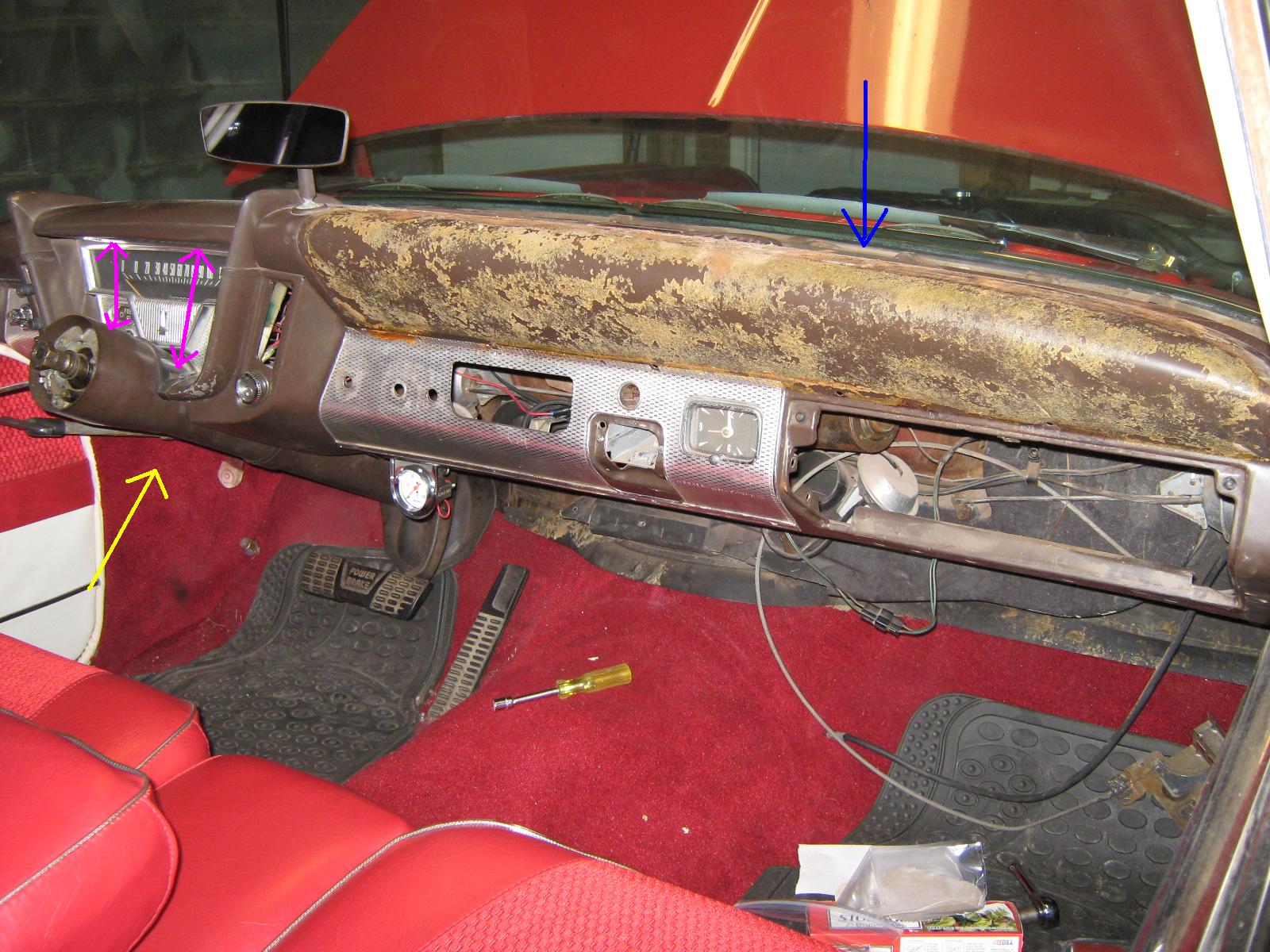

Secretary :lol: - anything else that you are missing? A Cuban cigar and a drink or so? The time you are thinking about taking the dashboard out is longer than it takes to remove it! It’s easy and you have already done ¾ of the work. Why quitting now? From what I see on the picture you can remove the hole dashboard in less than 1 hour.
- Disconnect Battery (if you haven’t done it already)
- Remove/disconnect the Clock,
- Remove the mirror from behind (or you risk breaking it)
- Disconnect push button cable and the speedometer cable
- Remove the cluster (screws and bolts on purple arrow)
- Remove the 2 piece trim under the windshield (blue arrow)
- Then remove the screws underneath and ask Marie to hold it up
- Then remove the side covers (both sides) (yellow arrow) Underneath is 1 big bolt on each side
- Remove it and the dash comes out.
- The cigarette lighter comes out when you remove the big sheet metal nut behind it.

OK, OK!! So maybe I'm convinced to pull the sucker out. I better get a lot more zip-lok bags to put pieces parts in...
Stefan, if I don't get this put back together by Carlisle, you'll have to deal with a bunch of angry Dutch people!! I am The World's Slowest Auto Mechanic, doncha know.

OK -- so, I started feeling guilty today about neglecting Faulkner, after seeing all the hard work that Ron and Matthew are putting in on Chrissie. So back to the garage today...
I removed the ashtray this time, and now was able to get a good grip on the cigarette lighter housing. It was snug, but finally gave way -- I removed the lighter, and the last piece of trim dropped off. The lighter element itself is disintegrated; anyone rebuild these, or make replacements? I don't plan to take up smoking, but there's all kinds of good stuff you can plug into a cigarette lighter.
It's starting to get warm enough to paint, so I have to get my butt in gear and sand, clean, mask and paint the dash. I'm going to order a "Just Dashes" pad too -- I've already got some special black plastic paint from Eastwood. (And Stefan sent me a black plastic steering column shroud in excellent condition -- thanks again, Stefan.)
I got silver plastic paint too, to paint the Dodge Caravan bows that fit '59's for the headliner. I've already removed the headliner panels; I'll comment in the other thread about those headliner clips -- not sure I'm getting it. But as far as getting the upper interior chrome rails off -- it looks to me like I have to remove the track for the weatherstripping to get those off. Is that correct?
Now that I've got the clock out, I'm going to want to try Tom Fox's trick for cleaning the points. But, how do you take it apart, Tom? I see little detents on the bezel -- do I just pry those back to remove the cover, and extract the works from the front?
I'm pretty good when it comes to taking stuff apart. Now, if I can figure out how to put this all back together... I might even make it to Carlisle :?
