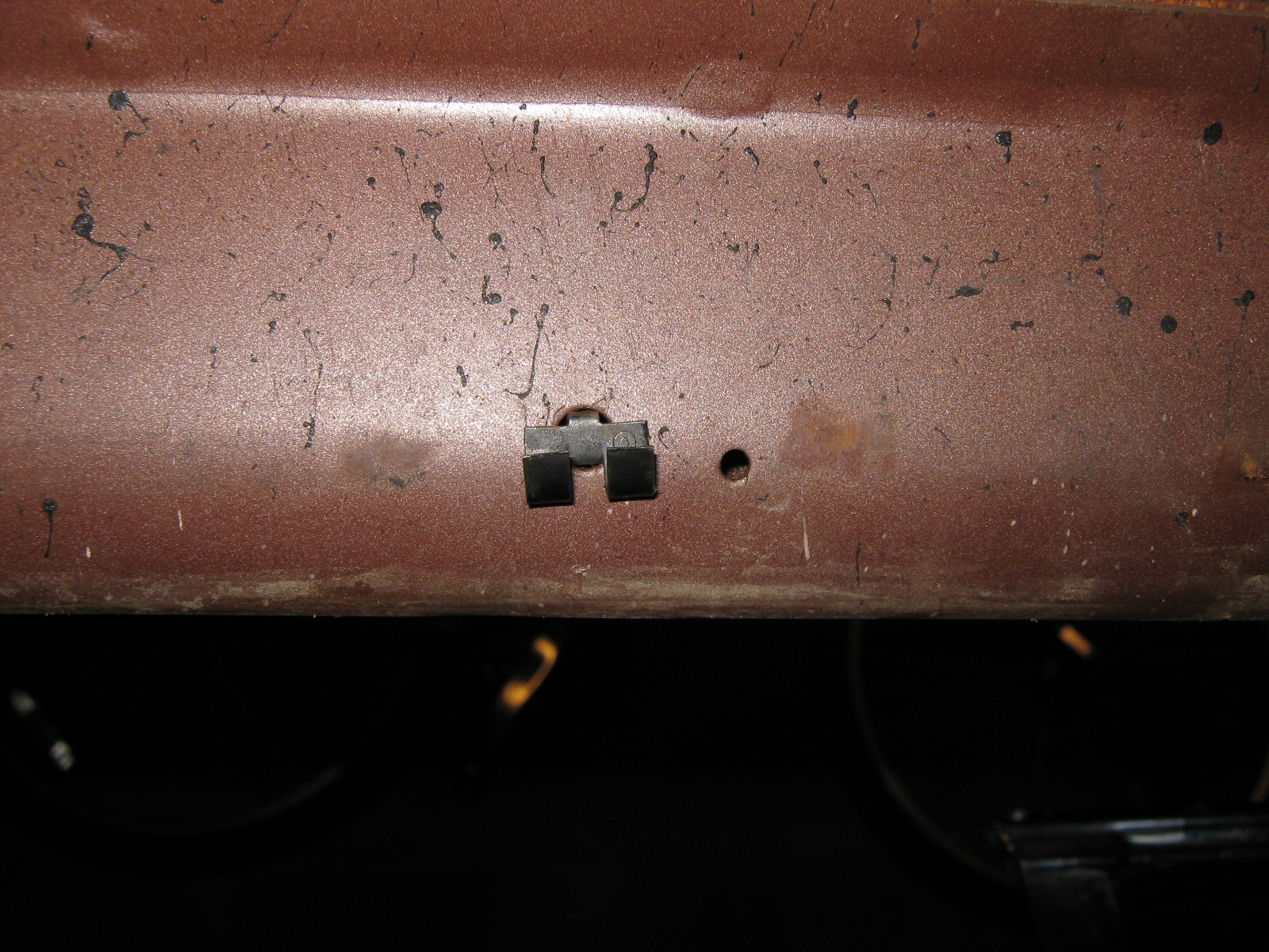

Tonight I dropped one of the inner chrome rails from Faulkner. Yup, the three clips are there. Here's a pic of the front one:

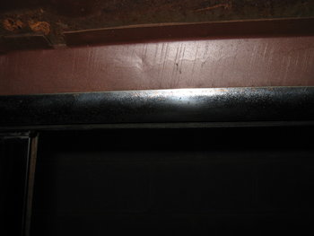

Here's a pic from the other side of the car, with the rail still up, same relative position:
You can see from the first pic, that the clip pops into a hole in the roof frame. But, from the second pic, the rail covers that hole -- and the clip.
How can the clip hold up the cardboard -- if the clip is covered by the rail?
I'm thinking it must have some other purpose. Is it to springload the rail to keep it away from the roof frame, so that the rail always forms a ledge for the headliner?
Speculating now. But I don't think the clips come into direct contact with the headliner, at all...

Trust Me - The outer edge of the outer cardboard headliner rests in the clip then the inner chrome rail covers the edge of the cardboard and the clip. By the way if you do not have the three piece headliner in your car and don't need the clips I would very much like to purchase them from you.
