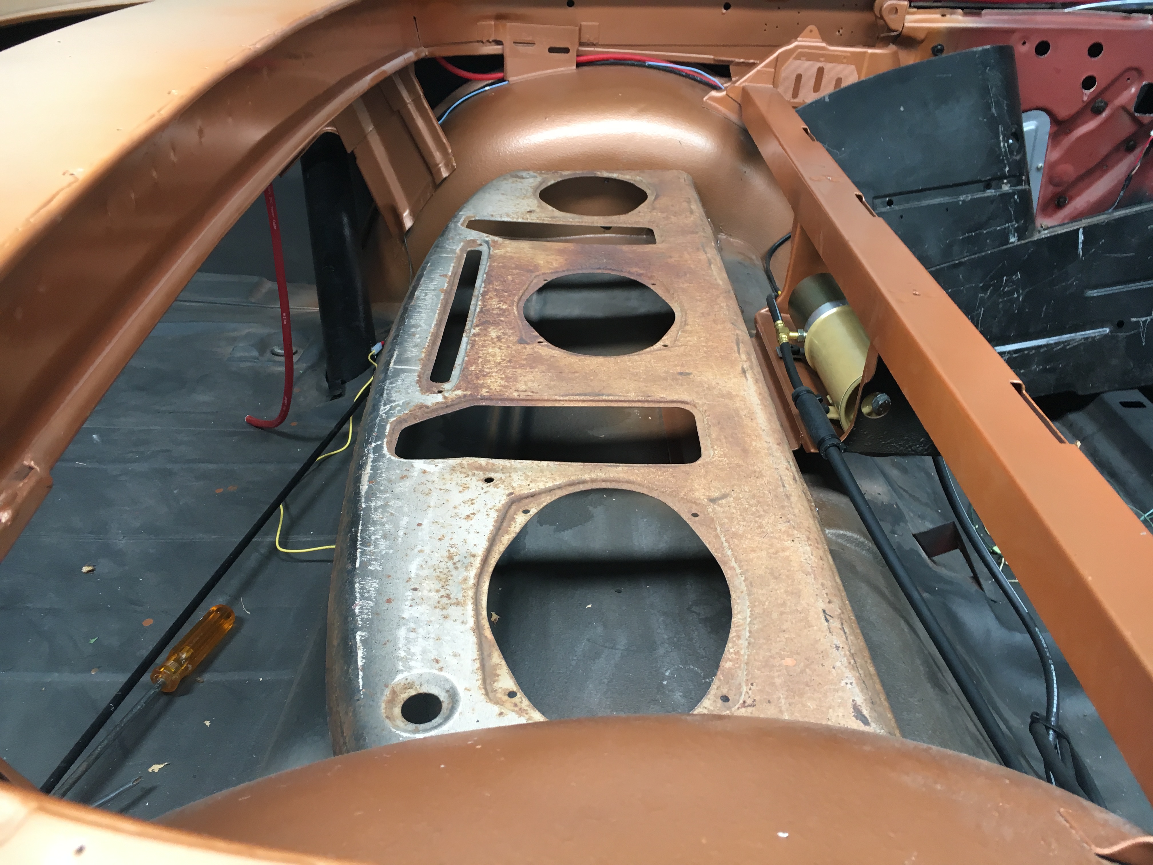

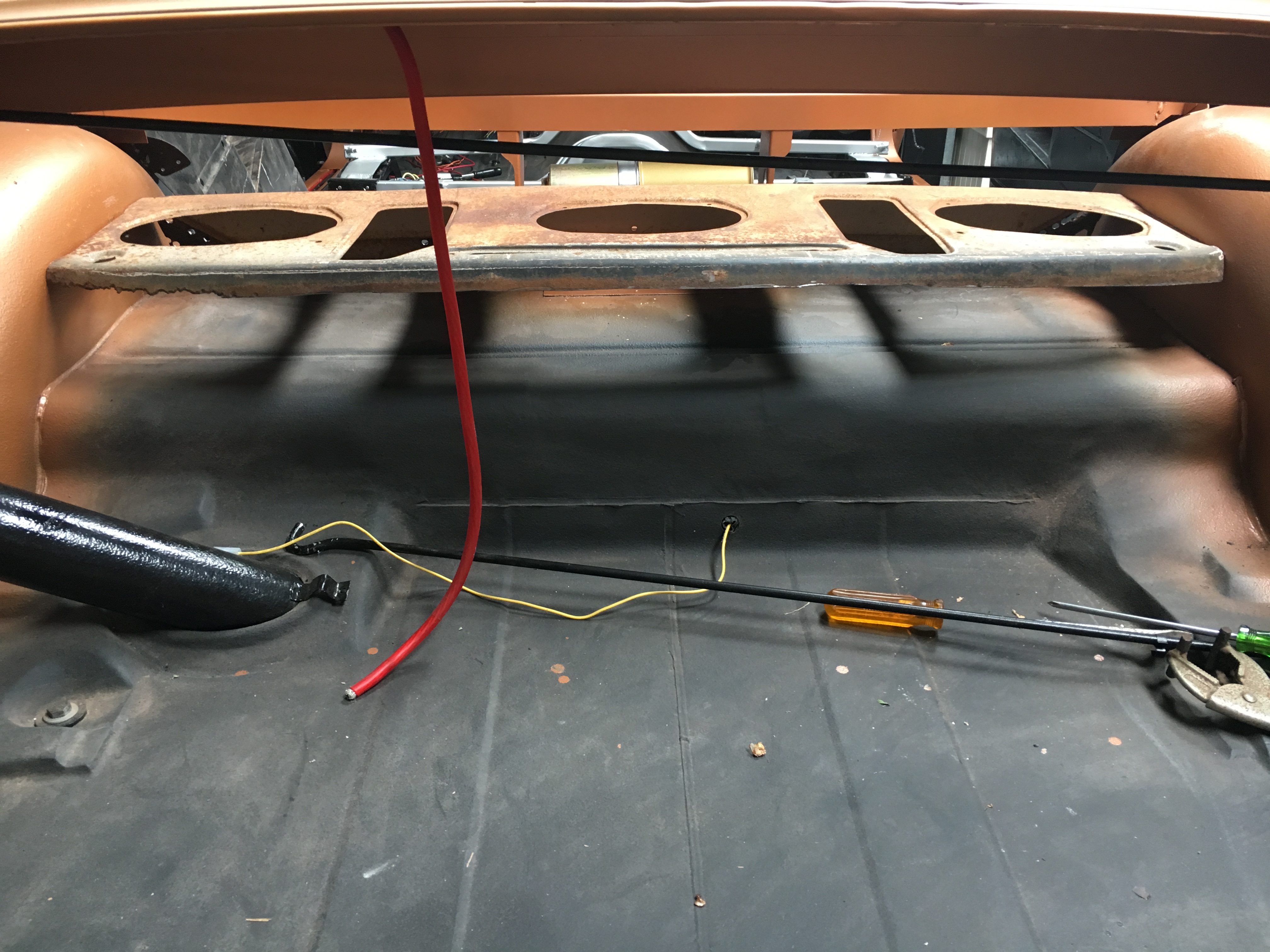

I managed to trim down the parcel shelf and have it sitting at 4inch above the well floor
Now just need to work out how to finish it off cosmetically
Thanks for the input

Nice job, that should do it. I don't know if you have considered or made poivisions for a drain in the top well or not but l do not have one in my car and so far haven't had more than 3 or 4 ounces of water, it's easily taken care of with a towel.

Ive seen discussions on this topic but i must say im not sure exactly where it goes
I assumed that the drip channel that runs along the bottom of the rear body frame to which the soft top connects onto (i.e. base of window) is there to collect the water which then runs to the sides of the car and down the front of the wheel arch - hence why its a typical rust spot
I tend to agree if water does get it ill soak it up - it will only happen perhaps when washing the car or getting caught in a shower
Cheers
Re: little by little
Vic - Try this on. Four small angle brackets rivited to the underside of the shelf and once painted will have a clean look, then stainless steel machine screws thru the wheel well. That way it can be removed if necessary.
Yes, any water that gets under the boot button strip runs in that channel and down the front of the wheel well to drain slots below the rear window and then to the rockers. Make sure those slots/holes are clear.

they say great minds think alike :lol:
Thats exactly what i was thinking in relation to fixing it in place
I reckon i will still use the boot well liner to make sure no water gets onto the speakers/amps, i will then close off from the trunk side with grey boarding to match the inner linings of the trunk panels

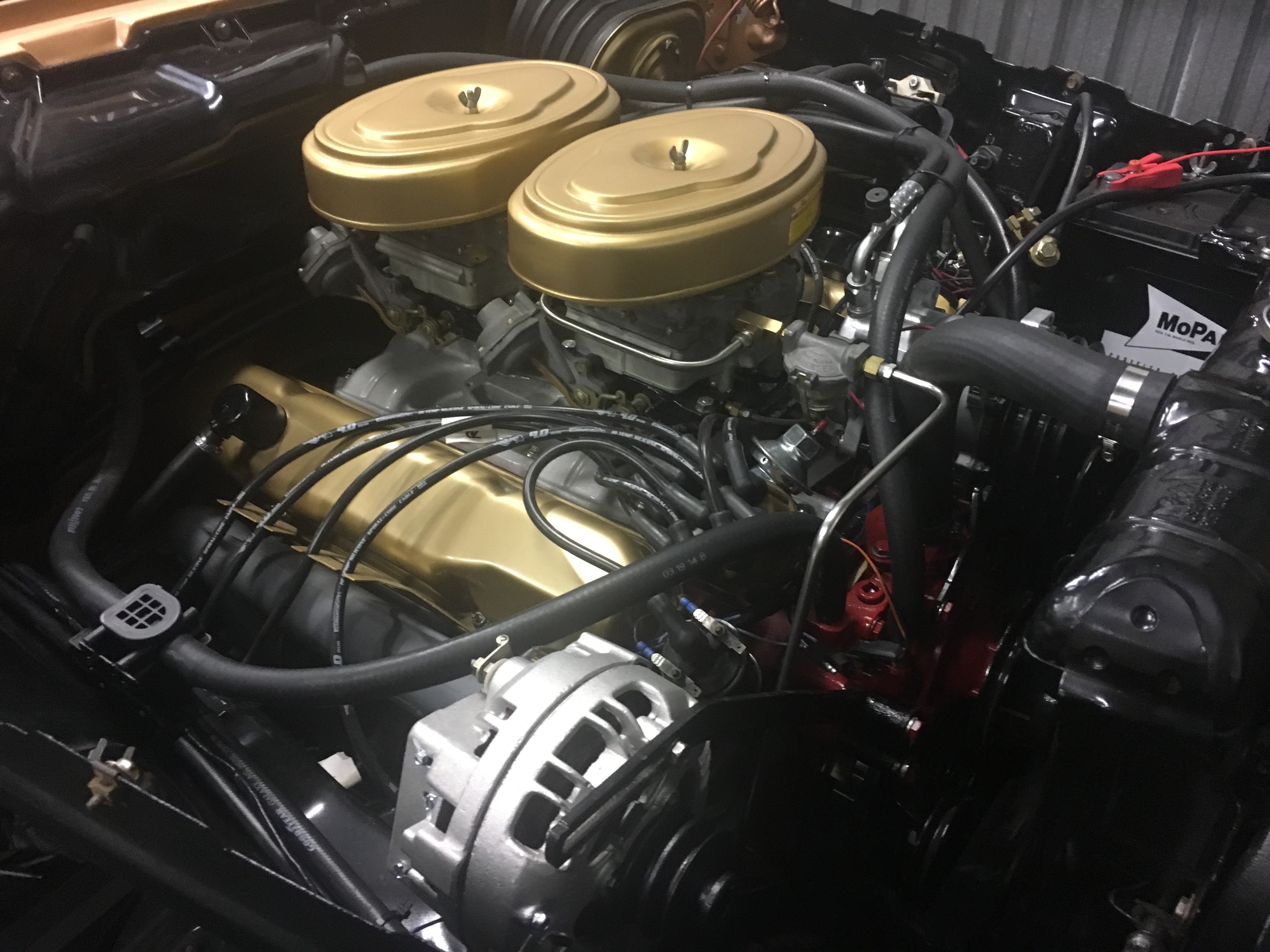

Hope All are well
I've ended up installing a vintage air a/c in lieu the under dash unit as I thought it was getting to crowded with the record player
Finished it up over the weekend and now getting ready to install the dash
I have also made up a matching control panel for the a/c switches with some spare dash trim I had
Not sure where to mount it as I'll need to set up everything first to see where it fits and if it looks good
Need to take some engine bay pics as I thought I had some
Also got my brothers 59 out of my parents garage over the weekend
Hadn't been started in years
Had to replace fuel hoses as they had gone brittle
Stay safe

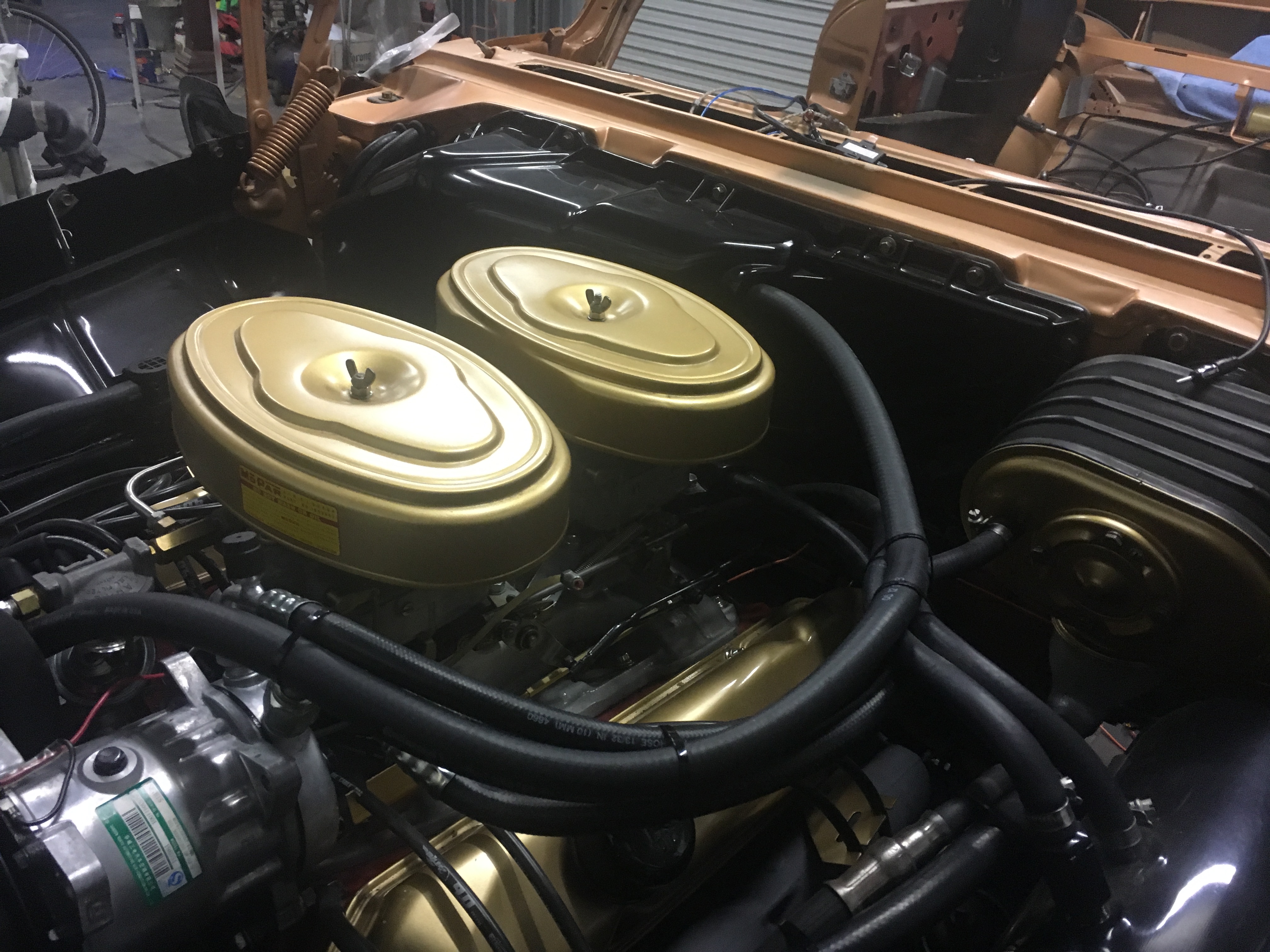

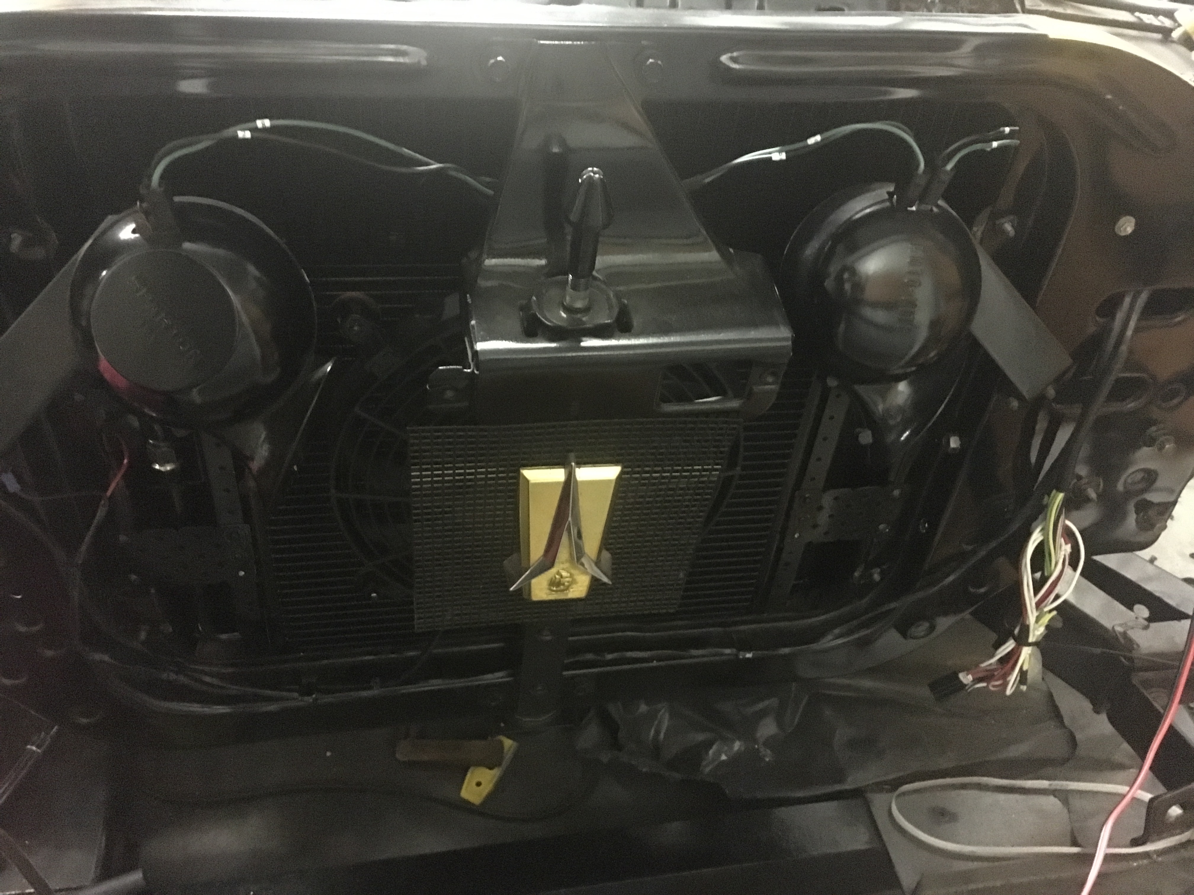

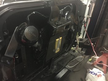

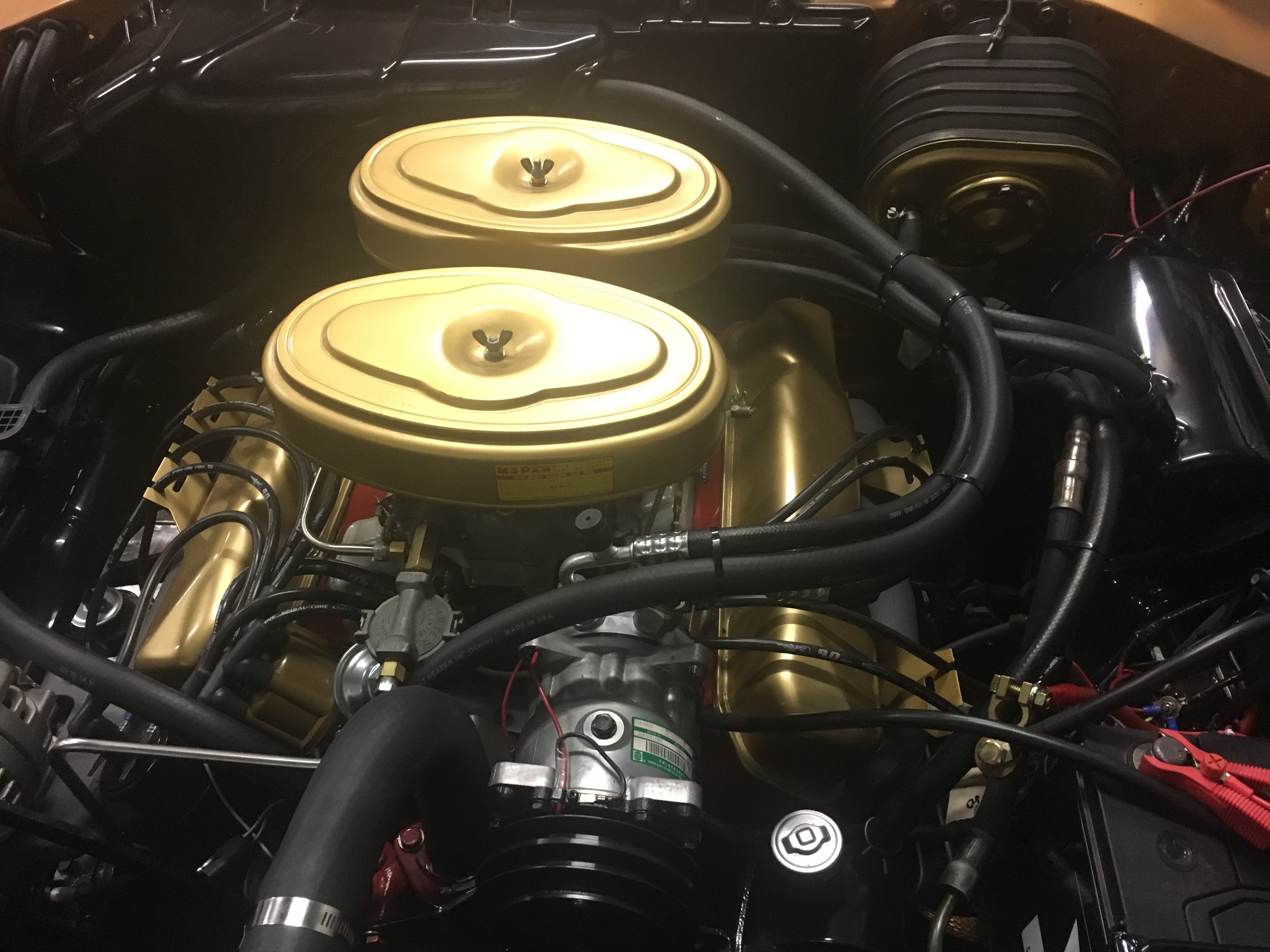

Attached are some pics if the a/c install
I've used all the original outlet from the firewall and heater box so as to cut any any new holes
Pretty happy with the way it's turned out
Even managed to keep the horns - had a concern that the fan and condenser would get in the way
Used the bottom and side heater outlets for the new heater hoses
I've had to remove the original core
Fan and condenser fit nicely
Managed to use the inside bracket of an an original heater control valve to hold the new a/c hoses
