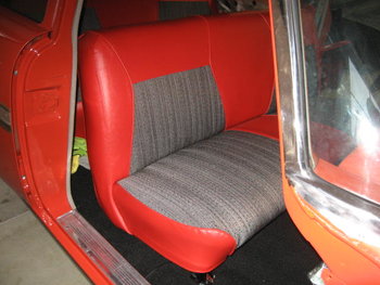

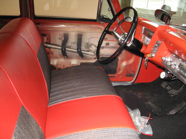

Did A little more this weekend, like I said A little more. Steering wheel back on, seat bolted down, kick panels on wiring /horn/dome light complete. Everything is now functional. Still looking into door weather strip. Talked to Mopar Mel the other day. Anyone deal with him? He say's 57,58,59 strips are the same and are sponge not rubber,compresses easier. I may have him send A foot to check it out.55 looks close as well. Later Mark

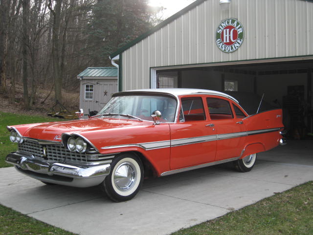

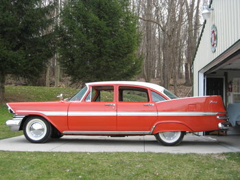

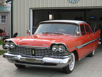

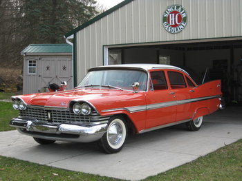

Got the doors on, lined up,striker adjusted etc. Nice day today it was 75 degrees. I had trouble with removing the striker plate screws at the rear doors. It is easier to line up the door with the striker off. I had A couple of rusty threaded screws, had one snap the head off so I had to take the back seat out and get access to it by taking out the small panel below the rear stationary window. I ran A tap through all the threads (12-24) and ordered new screws from restoration specialties part #5178j 12-24 x 5/8. Worked out good. Still A ways off but it is getting there. Mark P.S. Hey Dick, what is that thing in the last picture,ever seen one of them. That's the old one,semi retired to the pole barn.
Re: Marks winter of "59"
Great pix, Mark! I gotta get up to that corner of the state so I can see your car... Unless you're bringing it to Carlisle some day.
Yeah, I never shoveled once this year, and today I was outside in a T-shirt. Craziest February on record. It won't be long, I guess, before Dick has a beachfront property.
That's looking gooooooooood!
Bring it to Carlisle 2017!!!!

Mark - What a beautiful job and car, makes my work look poor, wish l had the patience to achieve perfection like you. Regarding the last picture, yes l see those every winter they show up when the Snow Birds do. Waste Management advertises all year with big signs on thier garbage trucks. "FREE SNOW REMOVAL".

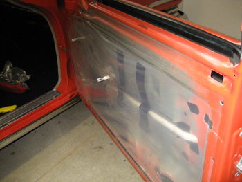

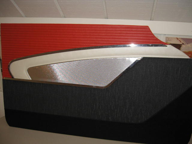

Still picking away. I put the trim on the door panels.The little bend tabs were not too rusty and the cleaned up and went on ok .I put plastic over the doors and will be behind the door panels, don't know if it is needed but I don't think it would hurt. I used heavy plastic sheets and double backed carpet tape. Does anyone know what door panel clips to use or A source and part number? I have A restoration specialty catalog and I think it might be #2607. The things aren't cheap I need about 60 of them. I have some originals to compare, the rest of them were missing or toast !! Still looking for door handle escutcheons 2" outside with A 1/2" hole in the center. I need 8. I only have one that was original and it is metal. Worst comes to worst I will make something out of plastic and A hole saw. Mark
Nice Mark - l used plastic behind the door panels to keep any water off the panels, you never know. You can source white nylon escutcheons at ACE hardware. On the panel clips, make sure you get the flat metal clips not the ones made out of wire. I used the wire type not realizing how much they show.
