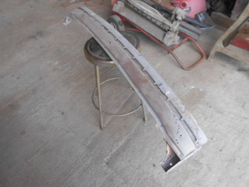

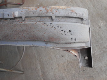

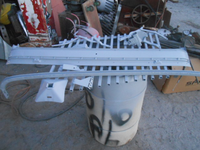

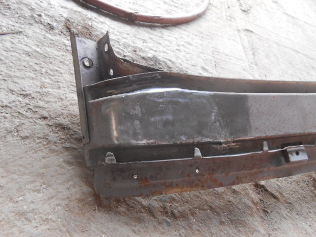

The nice summery weather allowed me to complete some more sandblasting and painting, but found a few more things to repair first.
The header bow after blasting revealed multiple pinholes, so I cut the weak metal out, fabricated a patch panel, carefully welded it in and metal-finished it.

Re: Getting a start on the convertible project

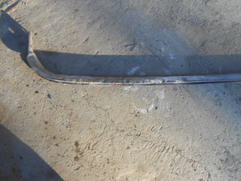

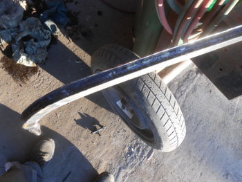

The rearward bow was a bugger, I never could find a replacement, so weak sections had to be cut out and replaced, thin metal was brazed back together to regain rigidity.

Heavy primer was then shot on both pieces, then sanded off with 600 grit paper. This will fill the remaining pits in the metal for a better finish.

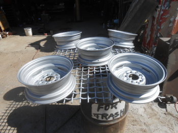

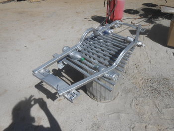

After sandblasting, the swivel seat frame and five wheels were painted argent.

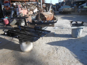

Seat tracks, convertible top components and some other pieces were all painted black next.

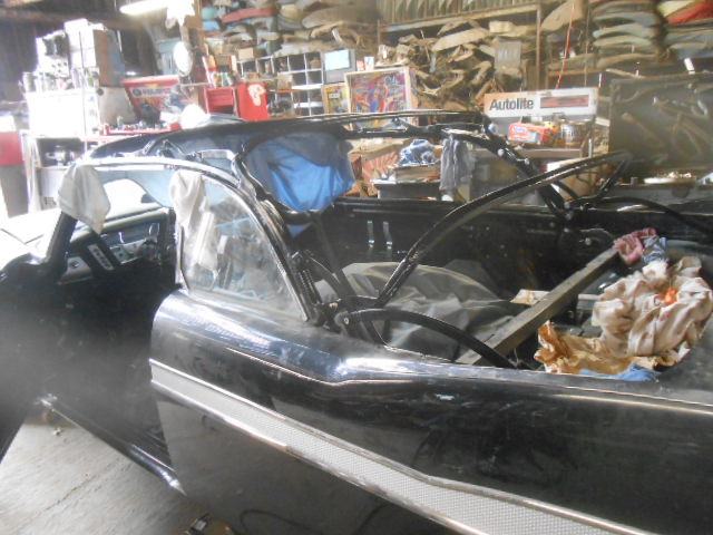

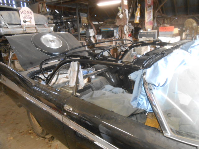

The top framework is all fitted now, aside from some minor adjustments. Next will be the hydro-electric lift system.

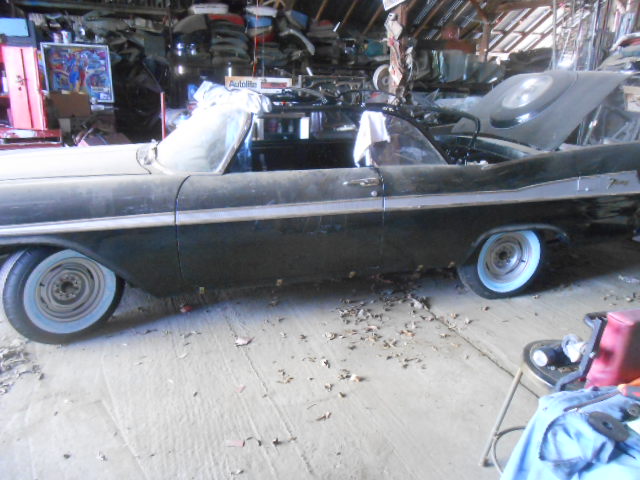

Got the Goodyear Super cushions mounted and balanced, and on the car.
Last Saturday I fired the engine up, Sunday I hooked up the shift selector cable and keyboard, installed the driveline, and took a short drive on the property, using a milk crate for a seat. Sprayed off some of the dust over by the well.
