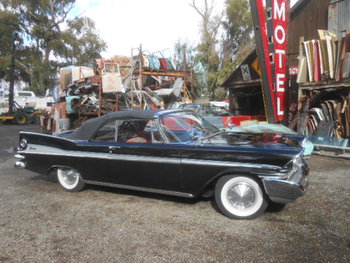

I've now put 11,000 miles on this car since completion.
Just south of us there is a big car show just before Halloween every year, it usually draws 300 hot rods and classics, but this year rain was forecast and many stayed home. It was clear on the drive there, and rain didn't hit until a couple hours into the show, so people had time to look the cars over. Small crowd, just 60 or so cars. A few even left when the rain started!
I was surprised to be awarded People's choice award, meaning that the '59 will be on all next year's T-shirts at the show.

Awesome, John - congrats! Your car would have been People's Choice, if the usual crowd of 300 showed up.

Yes John, it's beautiful and the cars looks and your hard work deserve the award. Next year l want two tee shirts, ex. Large. Let me know the cost.
