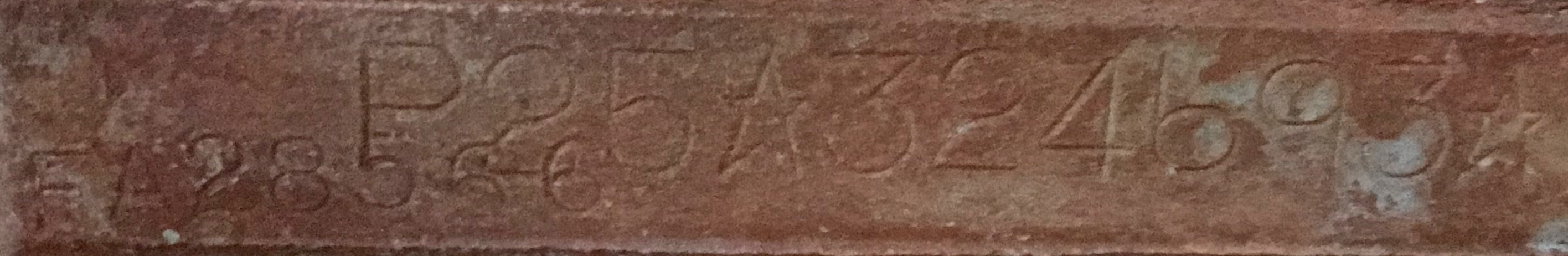

I had a bit of a scare with Martha, as John Fowlie, Ray Ward and a couple of other folks know. I compared the VIN on the A pillar to the VIN on the title, and they didn't match! Same number of digits - the first two, middle two and last two match, but another digit was transposed, and one differed. Oh no! I went back to the seller, but he's gone incommunicado... John mentioned that Ray knew of a way to get a "lost" title through the state of Vermont, and Ray provided a couple of YouTube links. I was prepared to go that route, and then I had an e-conversation with Christopher Housecat Neapolitan, who once owned a '53 Plymouth.
He told me that Chrysler titled cars from the factory with the block number!!
VIN on A pillar
block number
So Martha's street legal. Now, to figure out which number PA wants to use. As Chris pointed out, people swap blocks all the time - I'm lucky that Martha has the original block.
And speaking of which, she's firing up now. Drexel Auto told me there's sludge in the tank, so I have to drop it and get it reconditioned. They blew out the line and cleaned the filter, and the pump is fine - but the carburetor accelerator pump is shot, so I've ordered them a rebuild kit. But she's running! She rolls now, too - the emergency brake was locked. They've got a new band, and a cable is on its way to replace the kinked one. And don't you know, after a nearly three week vacation to California and back, the rest of my brake parts are scheduled to come home today. The drums on the car seem to be OK. With any luck, Martha will be parked in my driveway by the end of next week!
Oh - and that star symbol between the P25 (the model number for '54 Plymouths) and the remaining digits? According to Jim Benjaminson from the Plymouth Owner's club, that means it's a 230 and not a 218. Raw Plymouth power, doncha know!
P.S. - there's an overstamp on the block in a smaller font, "FA28566". Jim didn't know what it was, he speculated that it might be a state number of some sort. Anyone have any ideas?

Faulkner wrote: Sat Jan 05, 2019 9:06 am Oh - and that star symbol between the P25 (the model number for '54 Plymouths) and the remaining digits? According to Jim Benjaminson from the Plymouth Owner's club, that means it's a 230 and not a 218.
...er, not quite right. This is the symbol that means it's a 230:
So, Martha's not the powerhouse I thought she was. I guess the top speed is 70, instead of 75 :D
