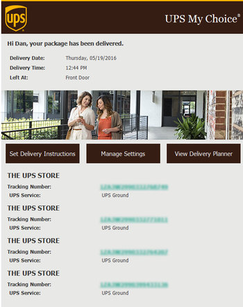

Mystery - I didn't have your phone number or email address to give to ups.
Re: Faulkner gets a Redo
Yeah - but you had my street address! :D I registered my email address with UPS to my street address, and they give me a headzup whenever something is coming. Pretty neat, huh? It's called "My Choice", and it's free - you can sign up here.

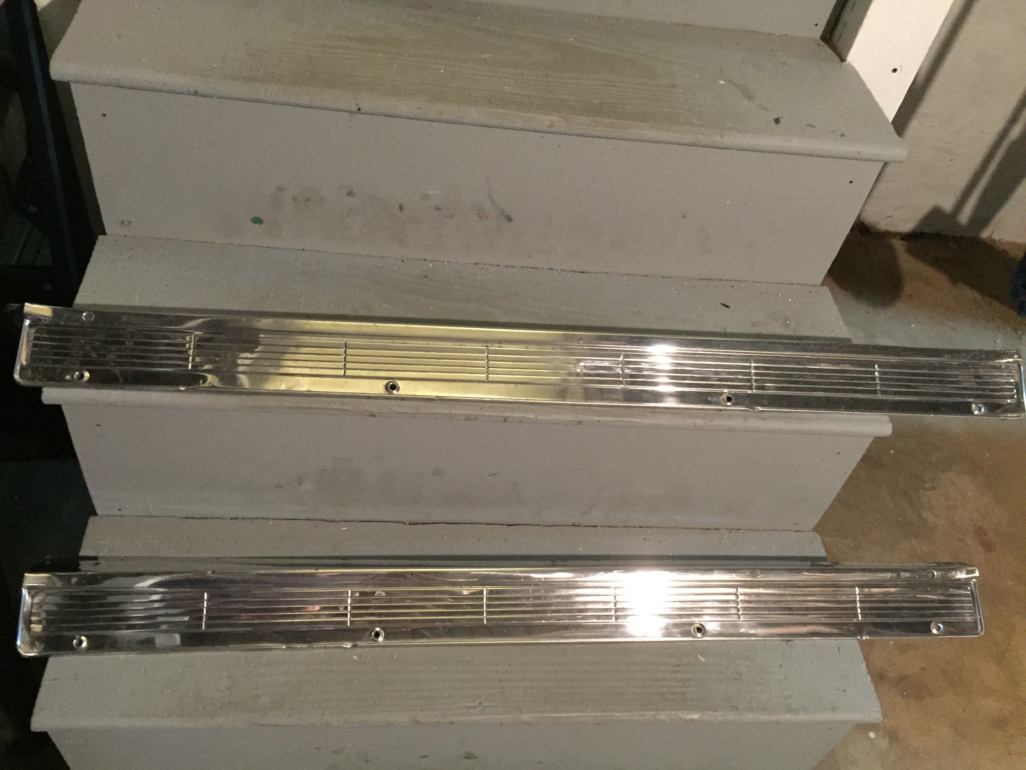

Dick! I sent you boxes and tubes of banged-up trim, and today I got what you sent back. There's been some kind of mistake!! What you sent me is...
NOS!!!!
How can this be what I sent you?! The craftmanship is unbelievable...

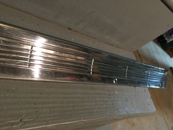

Look at these sill plates! They were trash - I hoped they'd brighten up somewhat, but...
This is incredible! And you even painted the turn signal housings for me, which also came out beautifully
But the topper: You charged me half of what I was expecting. All the time, effort, sweat and ibuprofen you put into this could not have been worth it for you. But, I'll take the savings and put it into a decent paint job for Faulkner.
Thank you, Dick Koch. You are a craftsman, and a gentleman. And I am indebted to you for your kindness.

Dan - Thanks for the kind words, the most important thing to me is that you are not dissapointed.

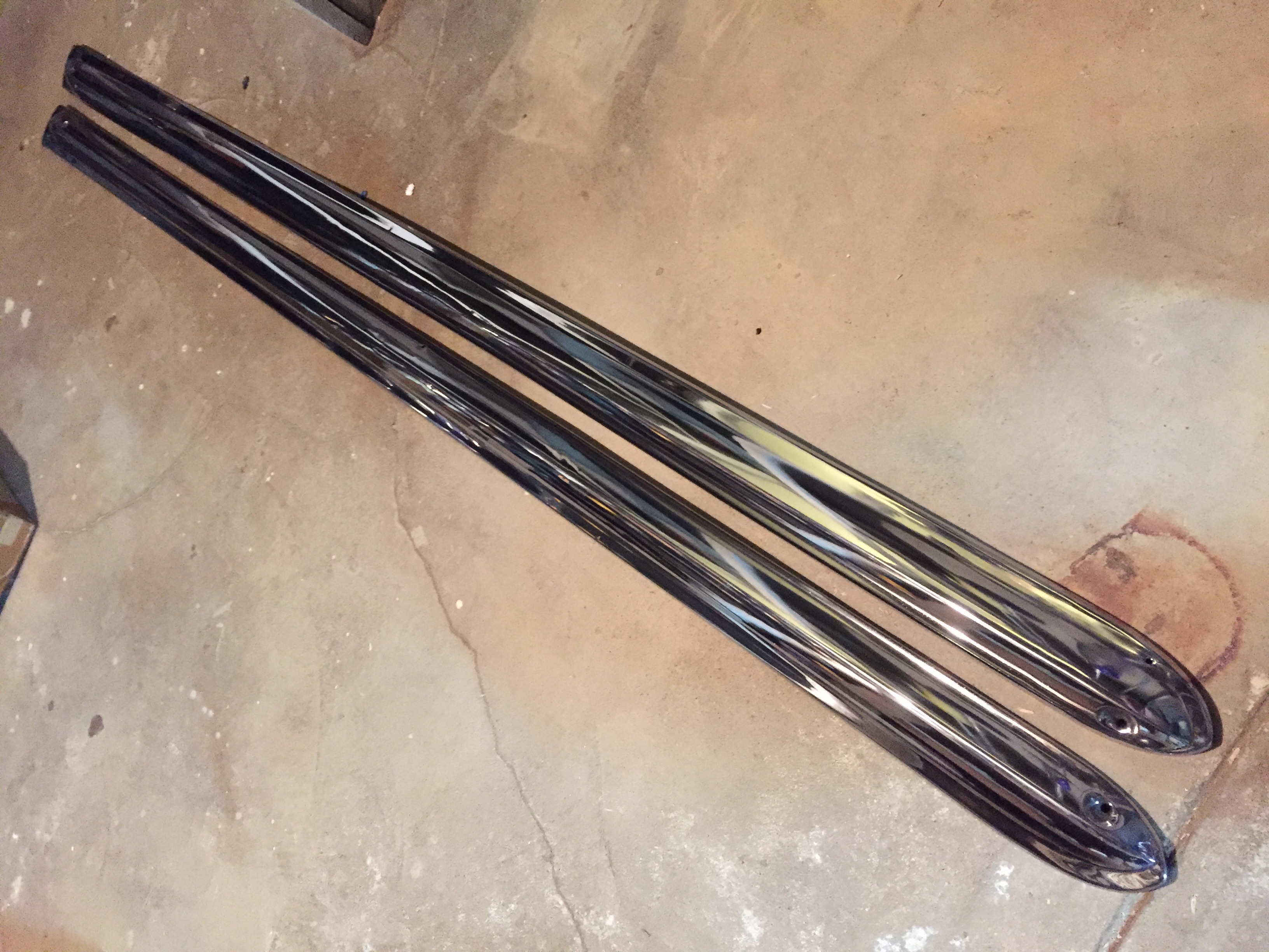

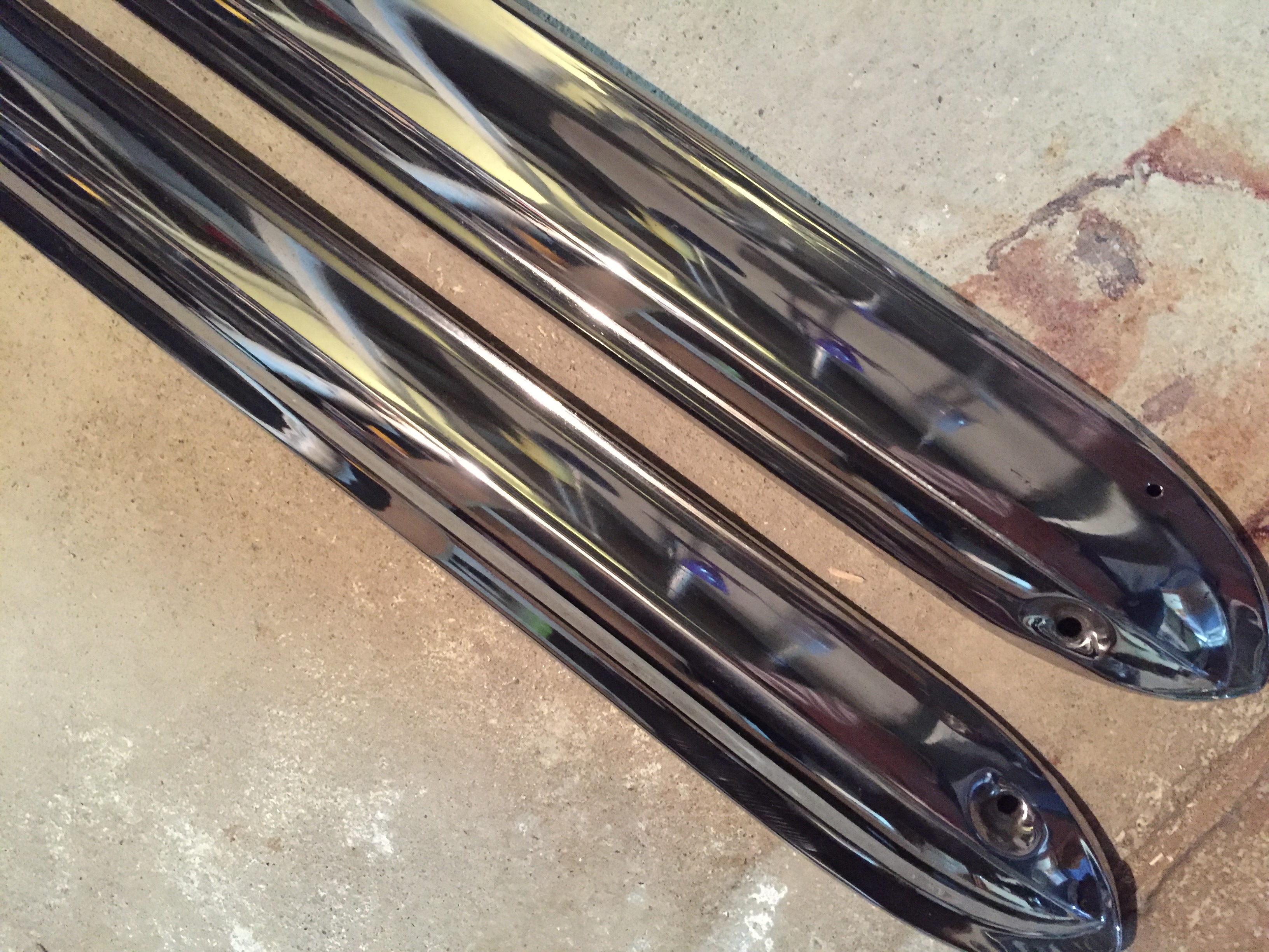

I finished scarfing down my dinner, and made small talk while my brain was elsewhere... Finally got back to unwrapping my Christmas presents:

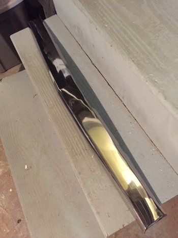

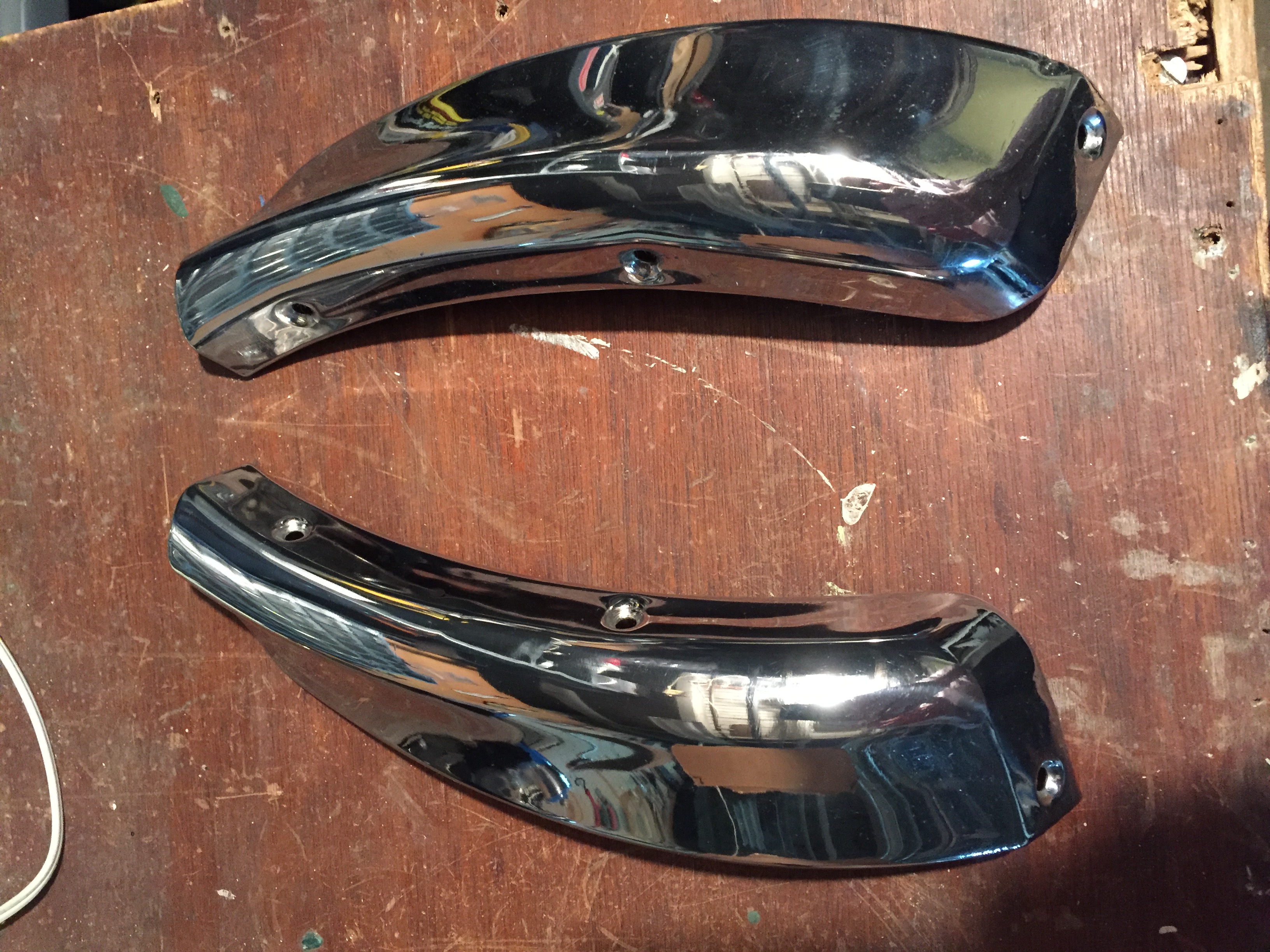

Matthew, I defy you to find the "corrections" in the rocker moldings!

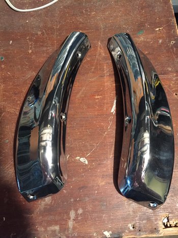

And I thought the stone guards were too far gone. Can these really be mine?!
Dick Koch wrote:The most important thing to me is that you are not disappointed.
Not remotely possible, Dick. You are, simply put: A '59 Plymouth Magician.

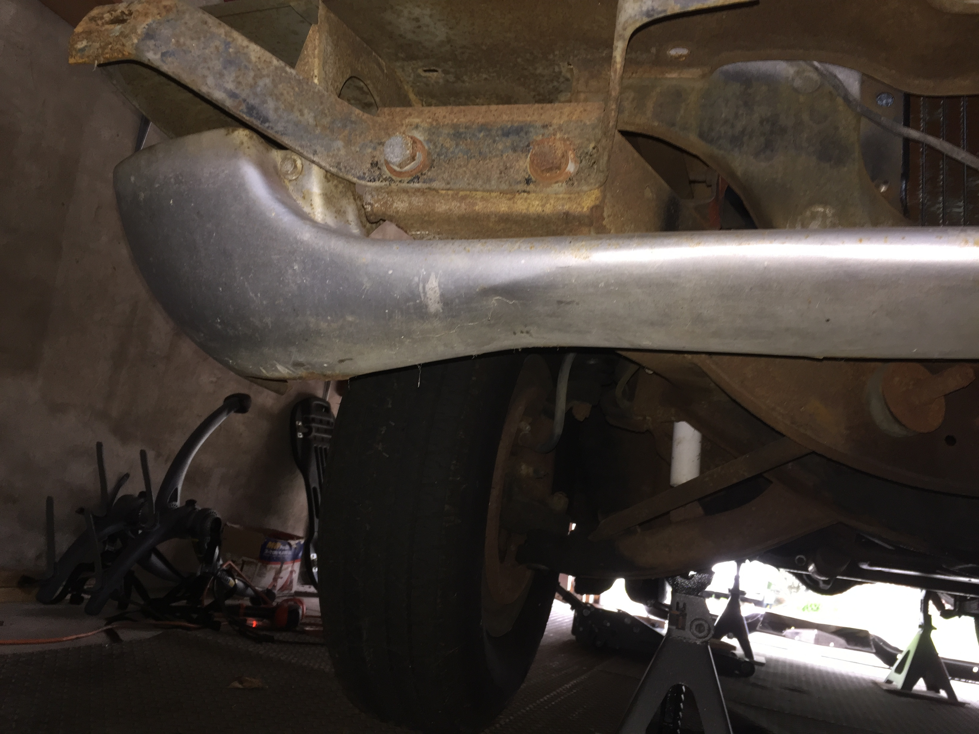

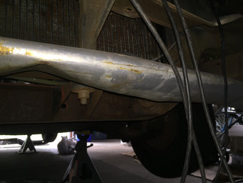

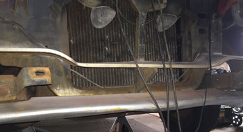

Both bumpers are off. I had replaced the rear years ago, but the front is in decent enough shape that I didn't see the need:

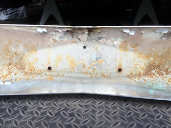

but the back of it is pretty ugly. I'll want to carefully wire brush it, but then what? Ospho, and maybe a couple coats of argent?

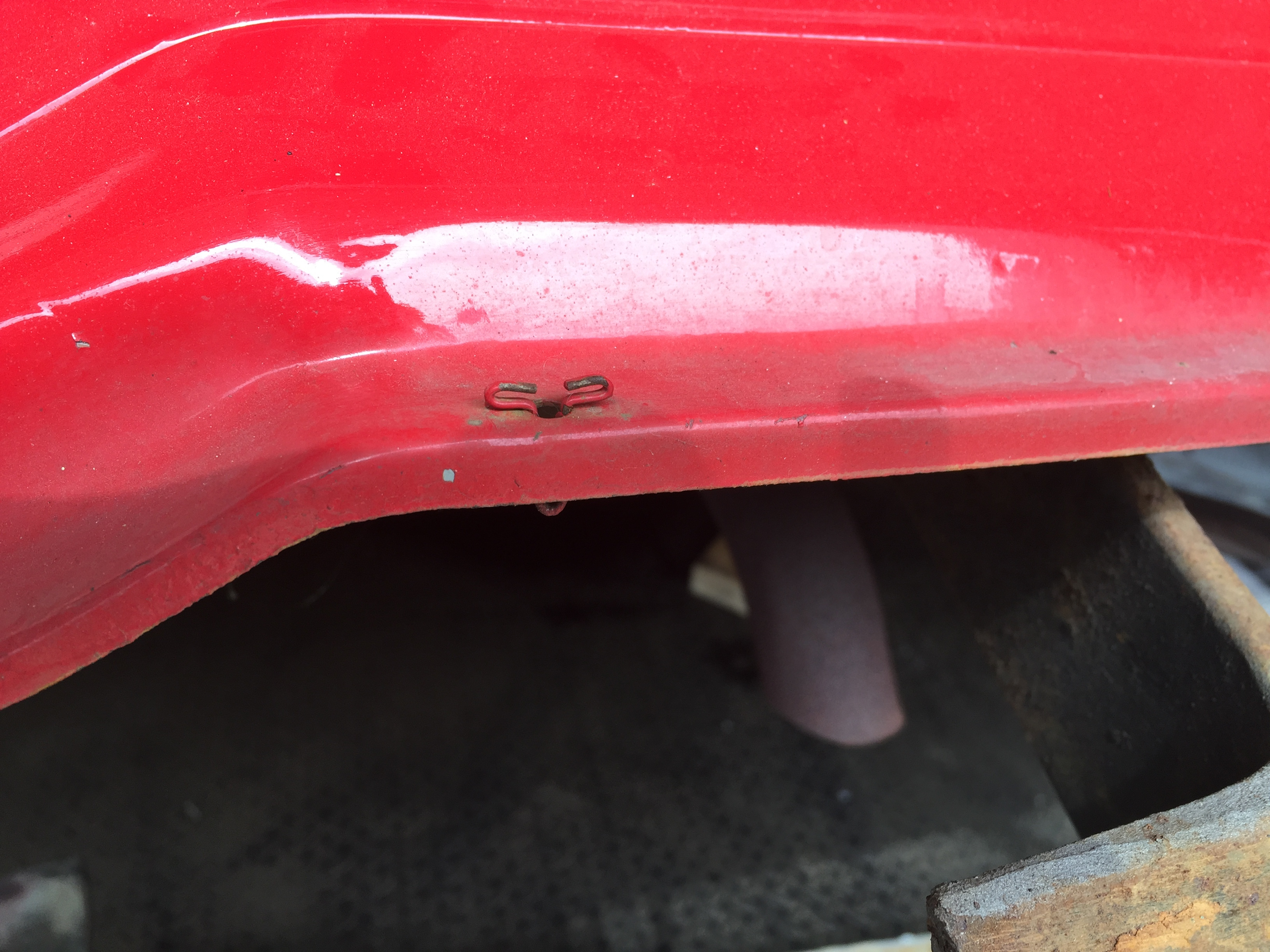

I've got the weatherstripping for the rear shelf under the bumper (Goers), but none of the clips. Except one! Anyone know where these can be had, or what have you used for a substitute?

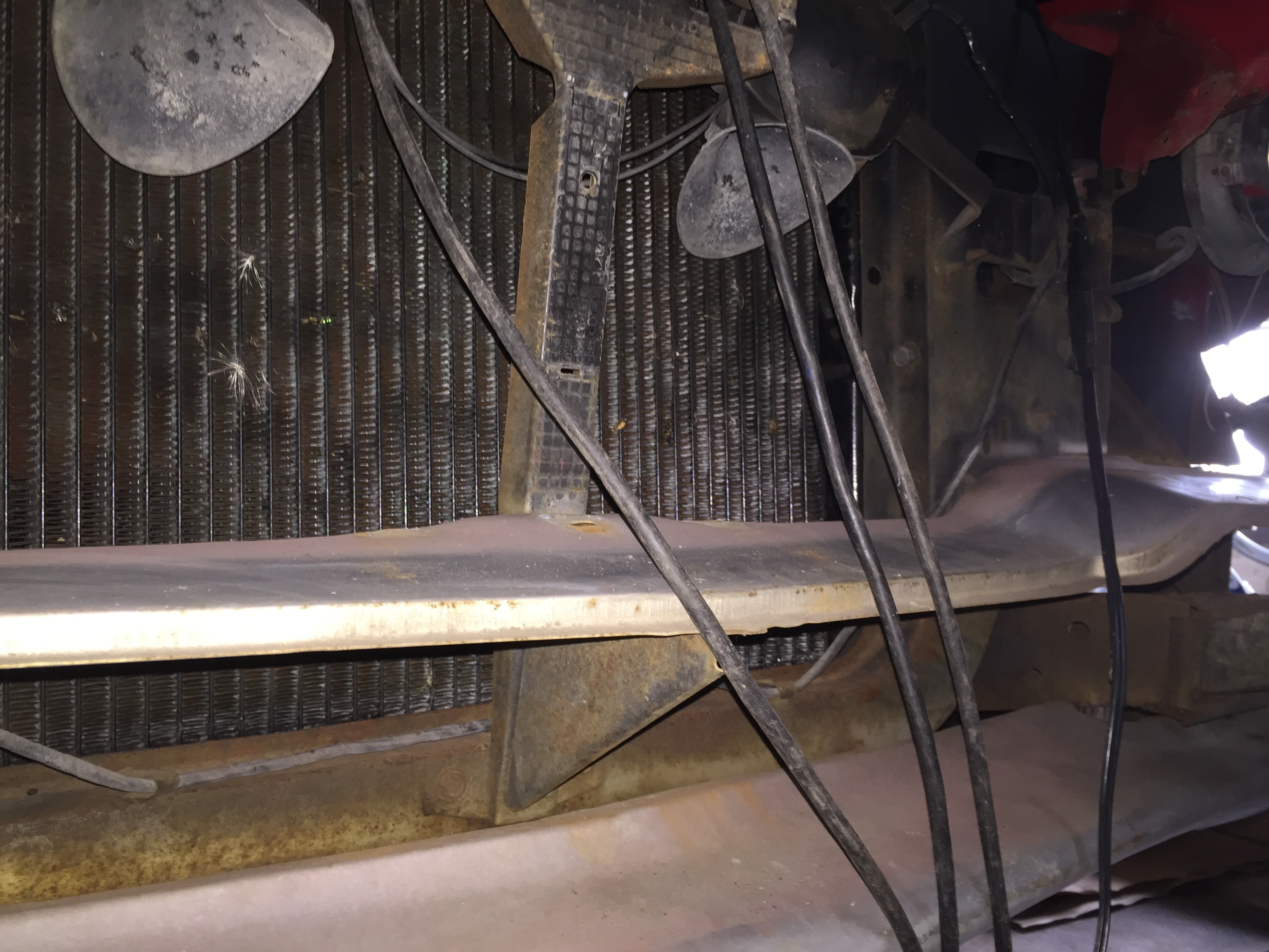

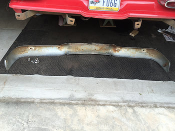

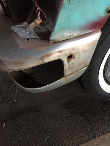

And now, the horror story that is my valance - and the shelf it bolts to, going under the lip of the front bumper. Long may it wave... But not for too long! I just need to find me a good body guy

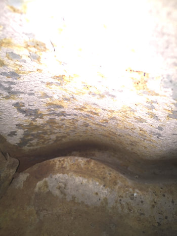

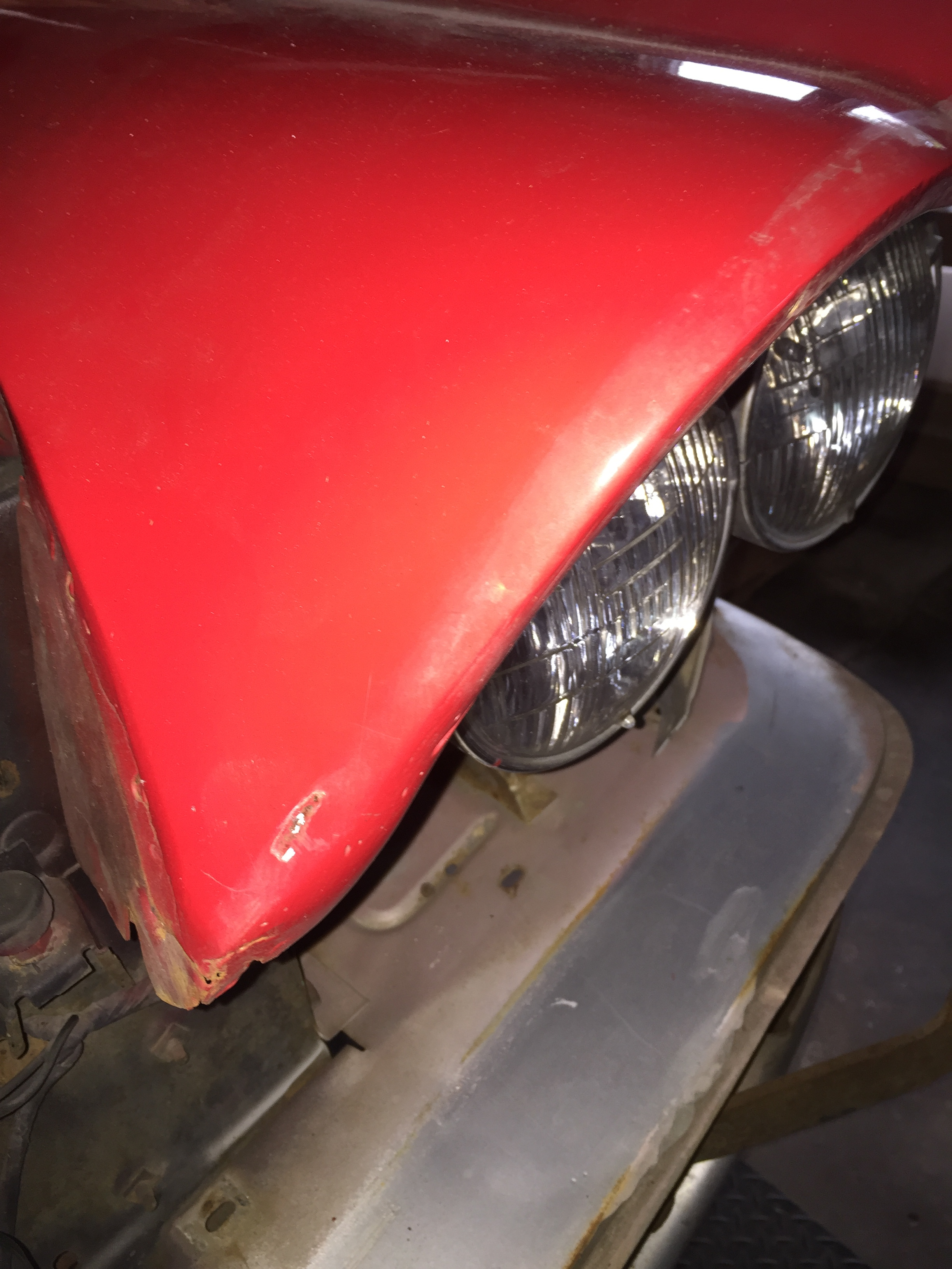

Here's some pix inside the fender, looking towards the eyebrow. The lower edge of the eyebrow towards the engine had apparently rusted out on both sides, but was skilfully repaired with body filler. I've got to clean, Ospho and encapsulate the inside of the fenders, but I don't see the need to get patch panels welded in

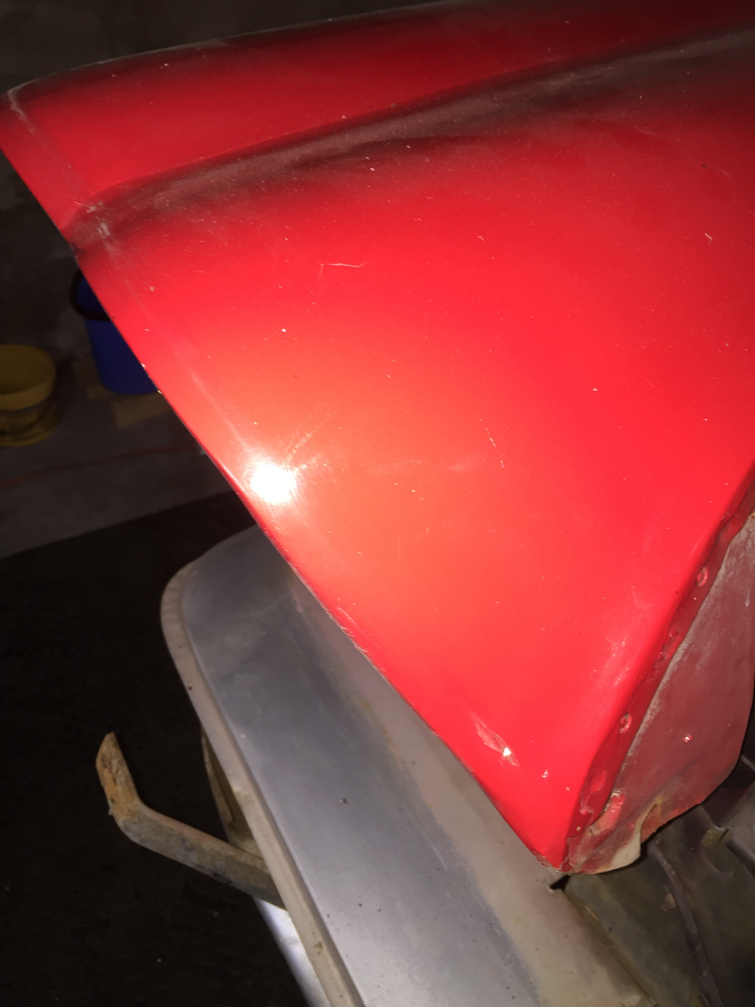

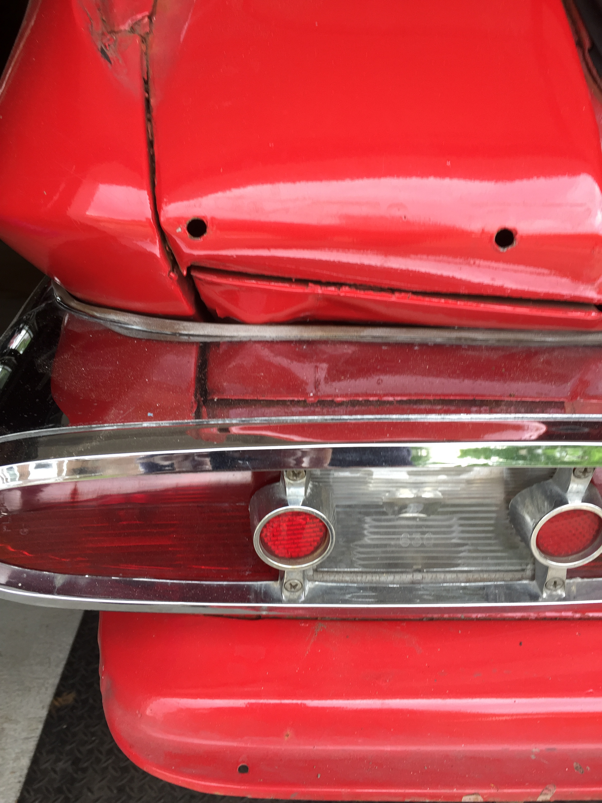

Something will have to be done here, however. I'll have to remove the taillight to see just how bad it is

Dan - On the bumper, use your new cup brush on the rust, then ospho, then silver encapsulator or black encapsulator, then argent. A couple cans of silver encapsulator will come in handy. The clips for the shelf splash guard are the same as the interior weatherstrip, the round one that goes from the sill plate and on the edge of the door panel. Goers is supplying a plastic push clip in place of the originals. ACE has a good selection of various size plastic push pins that may work for you. Any good body shop should be able to repair the valance and front splash shield. Show them some pictures of how it's supposed to look.

Dan; for the rear rubber stone shield I used #10 stainless hardware(screw,nut,flat,lockwasher) Mark

Wish you were closer, I'd fix that valance right up for you. It's actually in great condition compared to most out there. Mine was crushed flat and ripped at one end where something had hooked it, but I couldn't find anything better at the time.

John - That sounds just like the valence you sent me. It was flattened to a knife edge, used my press and impact sockets and got it perfect. Thank God you had one.
