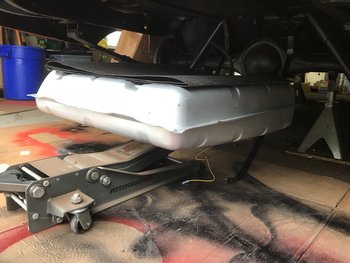

Putting it in the way I took it out - lining it up correctly, with roofing paper between the tank and the trunk

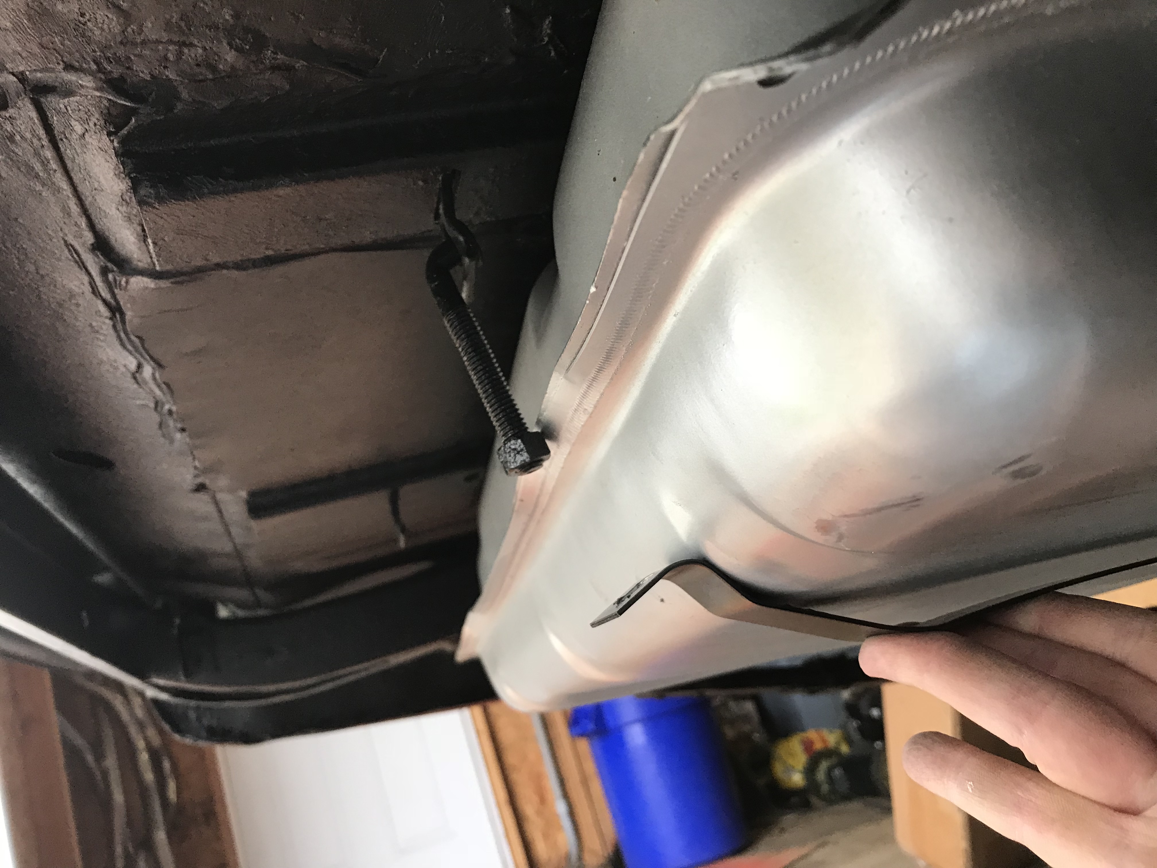

Oh noes! The straps don't quite fit
The new straps are the same length as the originals. No one wanted the old tank, and I got tired of tripping over it - so I fuelishly tossed it, when I could have used it for comparison. But, it can only be that the newer tank is slightly larger than the old. The bends in the straps are not quite where they should be.
It looks like I'm going to have to put my own bends in, and use bolt extenders... (*sigh*).

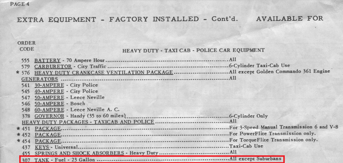

Thanks Dick! Is there a chance they came from a 23 gallon tank? According to the "Accessories and Extra Equipment" pamphlet I copied from the Keijs, a 23 gallon tank was an option on police cars and taxis:

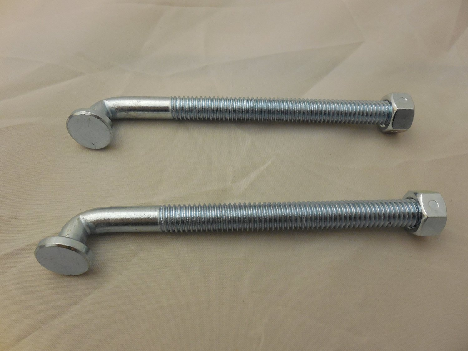

One thing for sure - the Vans J-bolts are longer, if the TPI is the same, and it looks to be. I count 34 threads on my originals, 2.125" long (at 16 TPI). From the Vans picture - which has a nut on the end - they are at least 56 threads, easily over an inch longer. I guess I was supposed to buy J-bolts when I bought the straps.
But, I'll wait to see what you measure, and work on other things today. The Vans straps match my original in length - I'll measure from the top of the slot, to the base of the platform where the bolt goes through.

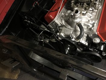

And I realize the heater return pipe in the manifold really needs a molded 90 in it, for air cleaner clearance. Had I thought before I put the thermostat housing on, I would have turned tubing with a 90 in it into the manifold, because the one that's in there is straight up. Unless I piece hoses together, I need a piece of 5/8" heater hose that's at least 26" long, with a molded 90 in it - but dang, if I can find it. Any leads?
And finally, because I'm not sure I'll have all my heater actuators and heater control in place before Carlisle, I'd like to put in an inline shutoff valve that's inconspicuous - lest the heat be on when we're barreling down the Pennsy Turnpike in the dead of summer. Any ideas here?
Not a great day. To support the illusion of progress, however, I did stand the radiator core in place before I wiped my brow and headed to the house for a cold one.
