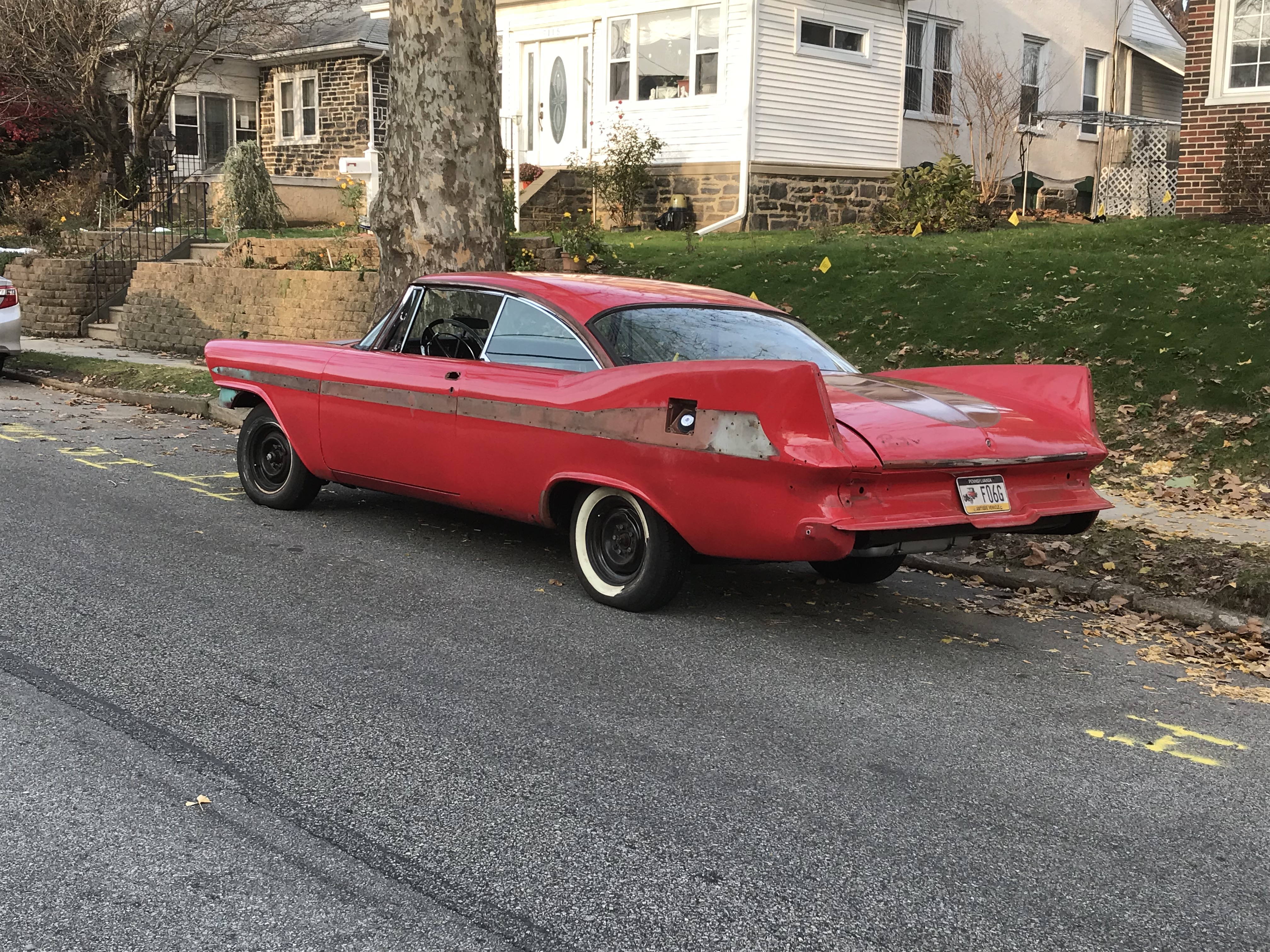

Faulkner was out of the garage for the first time in three years today! Under his own power, brakes working fine, transmission shifting fine...
Yeah, I'm going to let the body shop sort out the hood corners. You still have to wiggle the hood from side to side to get it up, and I don't want to bend the corners
But oh man, he STEERED... LIKE... A... YACHT!! I popped the hood when I got back in, and the pump reservoir was bone dry. It pumped all of the fluid into new empty hoses, and to replace whatever sprayed out when I turned the wheels while undercoating. I filled it back up, hopefully I'll have some power assist on Monday evening when the flatbed comes.
But I feel comfortable backing down the drive now, without taking out the hydrant across the street.

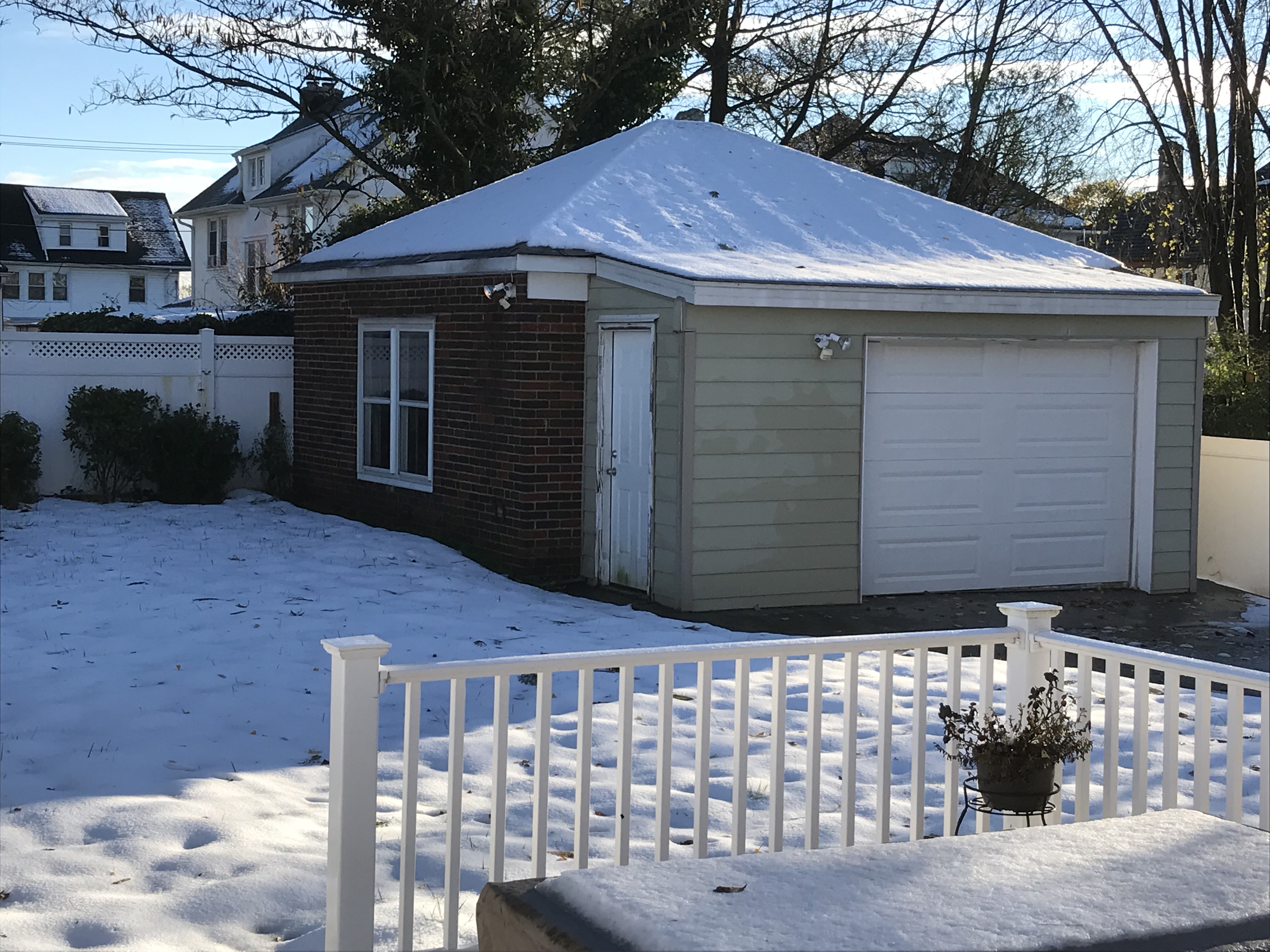

Thanks Mark! Yeah, this was the scene yesterday morning...
But it warmed up a bit, and now it's largely gone. 13 inches?!? Bloody heck, and it ain't even winter yet - not for another month.

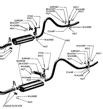

I need some advice guys - before Tuesday.
Here's a diagram from the Shop Manual, along with a photo of someone's undercarriage I saved along with my "To Do" list. See the difference?
When I bought the mufflers from Ed Eckerson, I asked him the question:
Dan wrote:Which end of the muffler is the engine side? The end with the center pipe, or the off center? And, is off center towards the center of the car, or the outside of the car?
Ed replied:
Ed wrote:The mufflers have the center outlet forward-- and the side opening to the outboard side for the rear.
The photo corroborates Ed's assessment, but the Shop Manual does not! Not only are the side openings forward, they are inboard, not outboard.
What's correct?!?
Re: Faulkner gets a Redo
I had a convo with Ed this morning - this is what he said:
Ed Eckerson wrote: I was correct--your exhaust job is correct.
I checked the 57/58 IPB--totally backwards too.
I am going to do some further checking but I do know that in later years--things were reversed (offset inlet and middle outlet).
ALSO--The FACTORY tail pipes were 1 3/4" for the 57-59 318s with duals... But all replacements were 2".
Figure that!!!!
It is therefore possible that original stuff was as the book shows, but later replacements were as we have them.
Here is an afterthought---I was able to get OEM tail pipe hangars for the 59 when I restored her.
I can honestly say there is NO WAY they would work if the tail pipe came from the inboard side of the muffler.
ED
Good enough for me - I'm going with the photo.

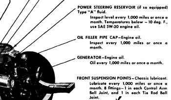

I swear, sometimes I'm my own worst enemy. John asked me tonight if I had put standard power steering fluid in the reservoir, which I had. He said he thought it should be ATF - I checked the shop manual, and sure enough, it is - Type "A", the modern equivalent is Dexron II or III from what I've read:
John's going to drain it and put new fluid in. Ka-ching Ka-ching! Oh well, this is my Christmas gift to myself (wait: That's the Suburban :P ), so let the chips fall where they may.

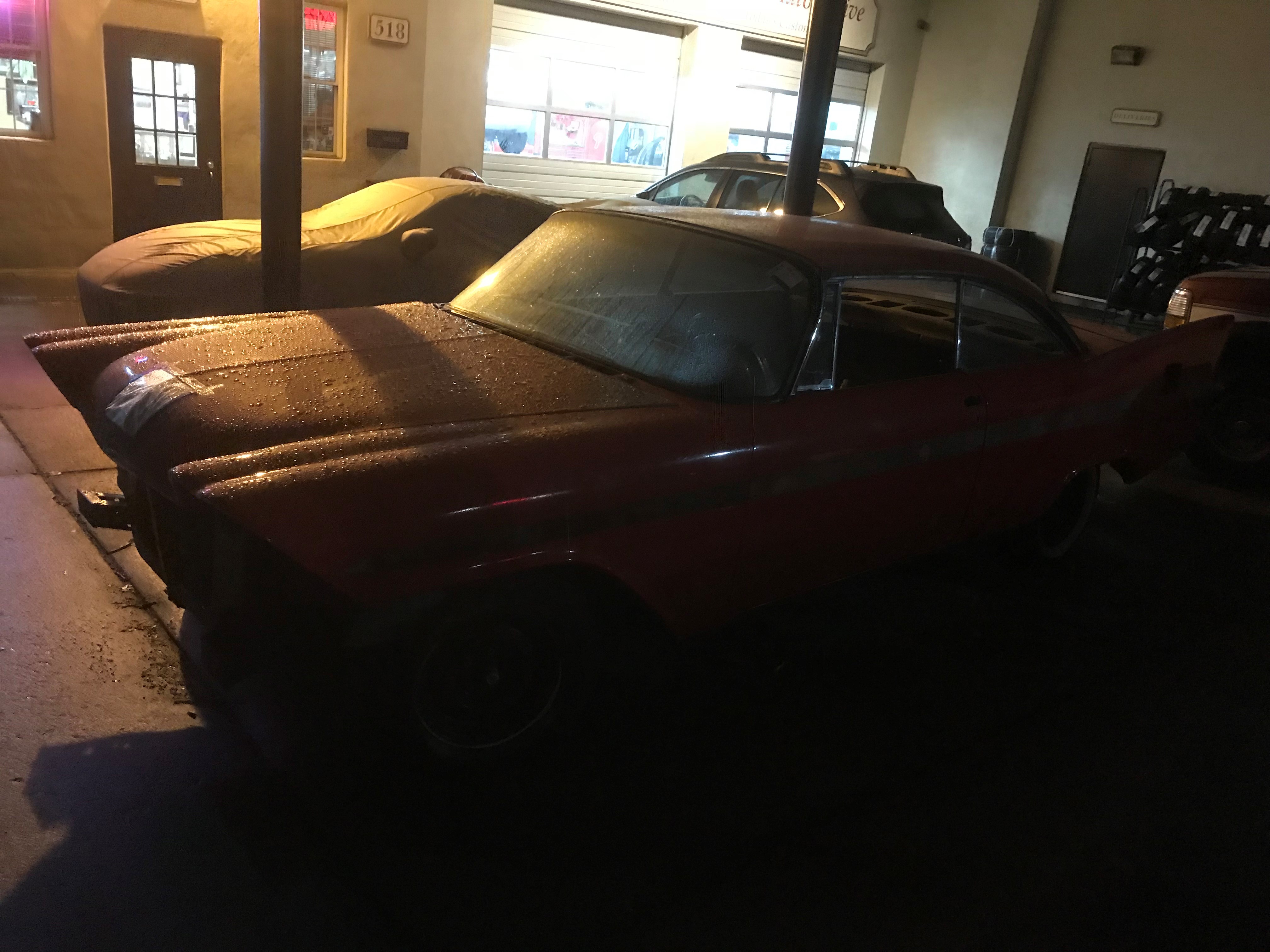

There's a little Toonerville Trolley at the foot of my street - I love it! It brings me home from work each day, but I stayed on to go to Drexel Automotive, a few stops down the line, where Faulkner is. The excuse for my visit, was that I forgot to supply the oil pan washer I bought for the oil change. And there was Faulkner, parked outside, rained on and looking lonesome...
They explained Thanksgiving Holiday, down a man, and receptionist sick so we park a mechanic at the front desk, yada yada. It's clear, I just need to keep my distance and let them get to it when they get to it. In the meantime... Cue Little Anthony and the Imperials:
