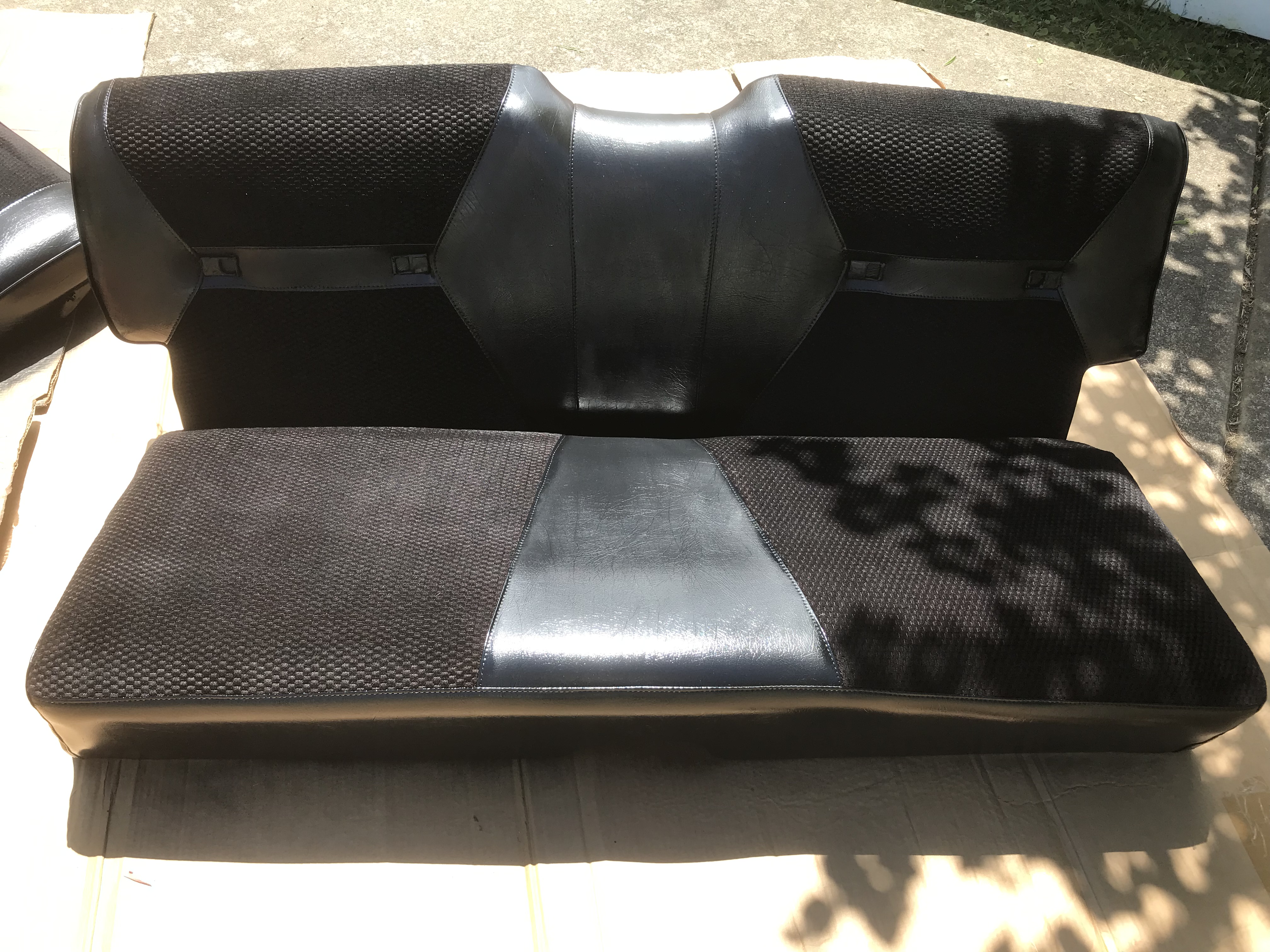

some finished projects

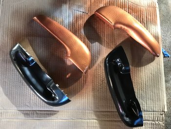

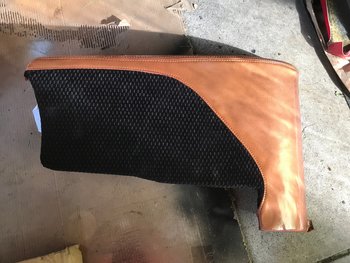

What's covered will get painted bronze

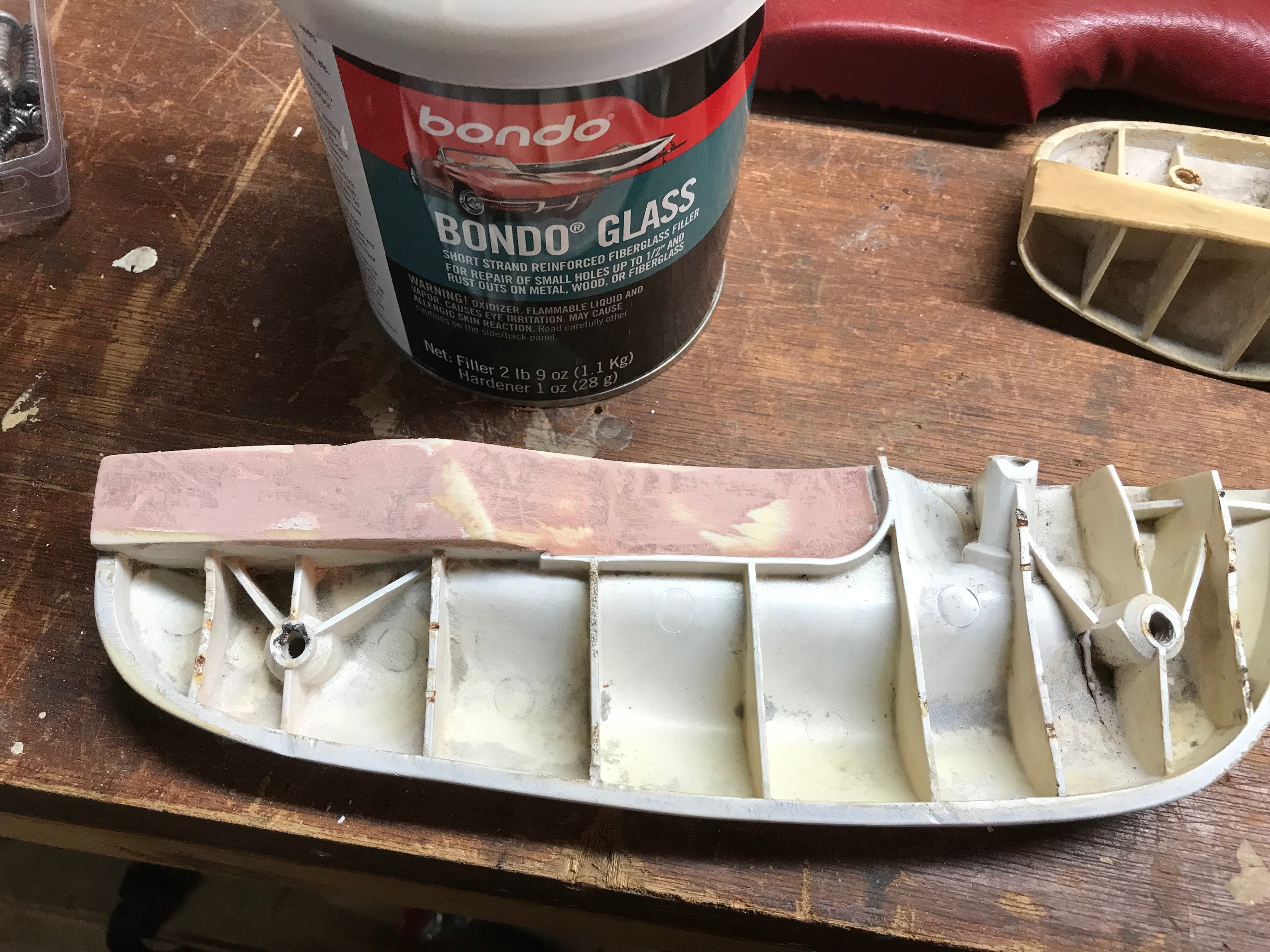

Some more interior painting today. The door handles needed some repair work before painting...

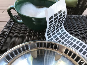

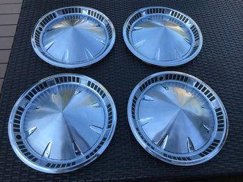

No pix of door panels, but they are nearly complete - need a bit of touchup here and there. I tackled the hubcaps:
This is Tom Fox's idea! You should sue, Tom... What I liked about this stuff, is you put it on with a bit of soapy water. You get to slide it a bit before it sets up, in case you don't set it right on first attempt
This is the 3M product

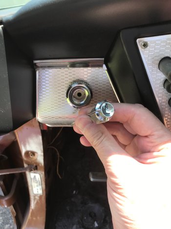

OK - by kneeling on a mat, and contorting my hand behind the headlight switch, I can find the release button. I push it all the way in, pull the knob out, and...
...it hits a stop. I tried twisting it while pulling, but still no love.
Is there a trick I am missing? I have a new switch - and, I have a used knob and post. Should I just sacrifice the old, and cut it off? Time’s a wastin’...
Re: Faulkner gets a Redo
NVM!! It’s out 8)
Yes! Thats how you do it

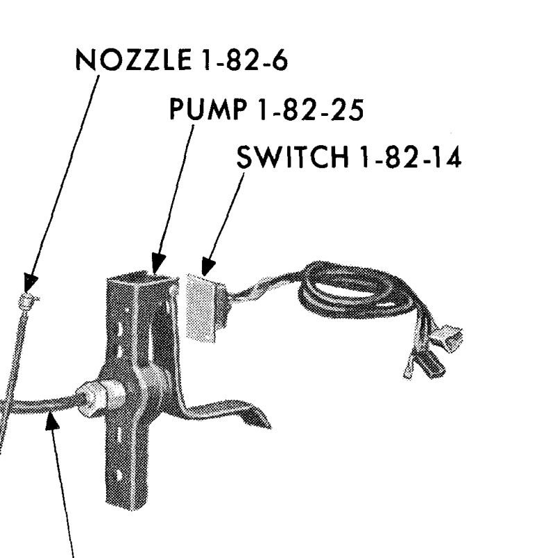

OK, I went down a rabbit hole on my way to reinstalling the dimmer... I had removed the windshield washer pump to clean it up and paint it. Now, I'm not sure if the pin on the switch points up, or down; and if the small lever attached to the foot lever, is up top to release the pin when you step on the pump, or beneath it to push it in when you step on the pump. This picture doesn't show the pin. Any help?

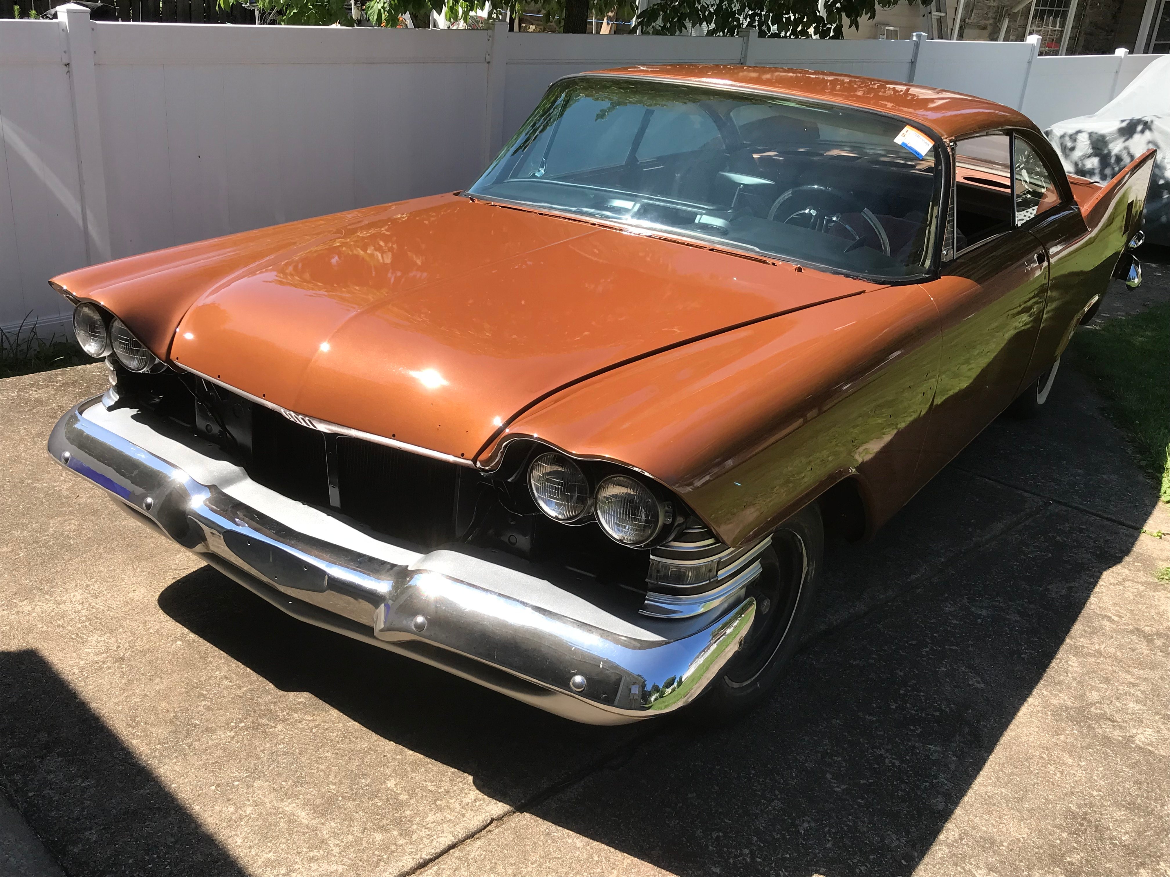

(*sigh*...) Not a lot of progress today. These dang headlights and wiper switch have me befuddled. I did clean up the engine compartment from the paint shop dust (again), and gave Faulkner a good wipe down; and got the hood bumpers and trunk weatherstrip installed. Not a perfect paint job, but I'm pleased for what I paid.
