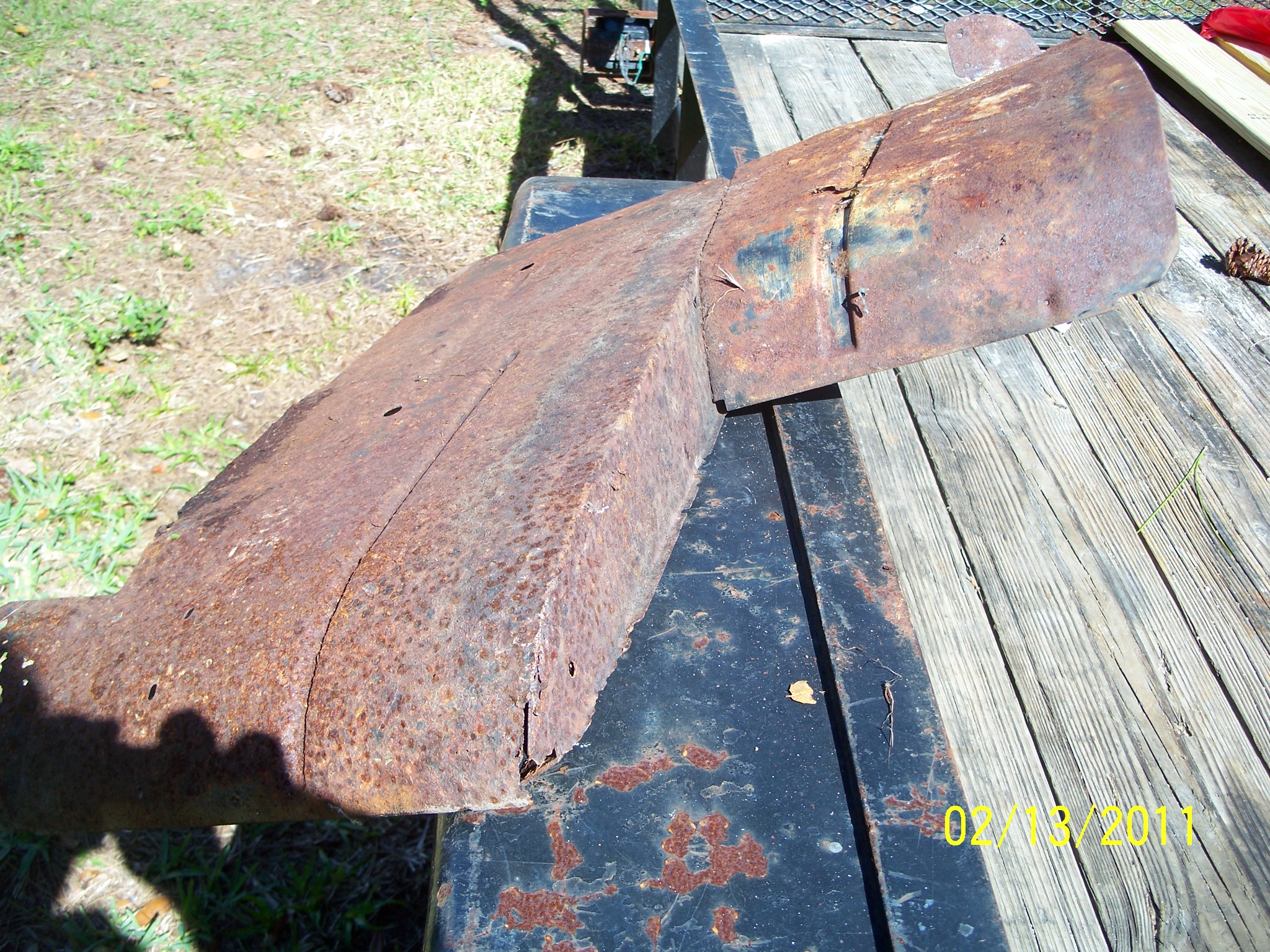

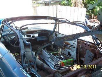

Some more pictures, The top mechanism looks to be in pretty good shape. The cylinder covers are not good, if I can't find good ones, (John - Big M) I will try to find someone that can make them. Looking at pictures of Belvederes the front seat for convertible and 2 dr. sedan seem to have the same front seat, 2/3 back on driver side, 1/3 back on passenger side. The cloth seems to be different from the Sport Fury also. I have the Black and white sport fury cloth so thats what I will use for the cloth part but patterned same as Belvedere. I replace the Deck Lid on the red car so I will try and repair the Key hole on the Convt. Lots to do on this one, it will be a total frame off restoration. Now, total concentration on restoring Reddie so I can start on this one.

Dick, I have a nice set of inner fenders, and possibly a decent front seat core. I'm in the same boat as you with the rear panels, I will have to make some for my own car, as they are rusted away. I also just got a car in yesterday that has a repairable front valance.
All sounds good to me John. Contact me with private message. Is that front seat core 2/3, 1/3. I am taking mine around to several metal working firms to get prices on fabricating the panels, wil let you know.
