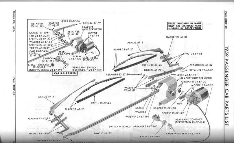

The wiper arm pivot housing gasket #451, is on Pg 39. I checked my car and I don't have them either. Don't really see how they go on (3 holes) but it's probably makes sense when you take arms off and install them. By trying to find #451 I found a few items for my car that I didn't know Gary had available.

Regarding the pivot gaskets, I too do not understand where they install..I've taken a few of these apart, but I've only re-assembled one, and I don't recall the seeing gaskets..perhaps, John, they go on the shafts before you install the mechanism (arms and motor) from under the dash.

I just flipped thru the 59 Parts Book (p. 23BF-10), and sure enough, the flat 3-holed gaskets install over each shaft plate, before they are pushed thru the firewall and secured. You cannot see these gaskets from the outside of the car.
Later Mopars..i.e. mid-60's Mopars did use rubber grommets to seal the shafts.
Now, I see... Here's the page Roger is referring to (attached). The gasket is on the inside, there's nothing that goes around the post in the well.

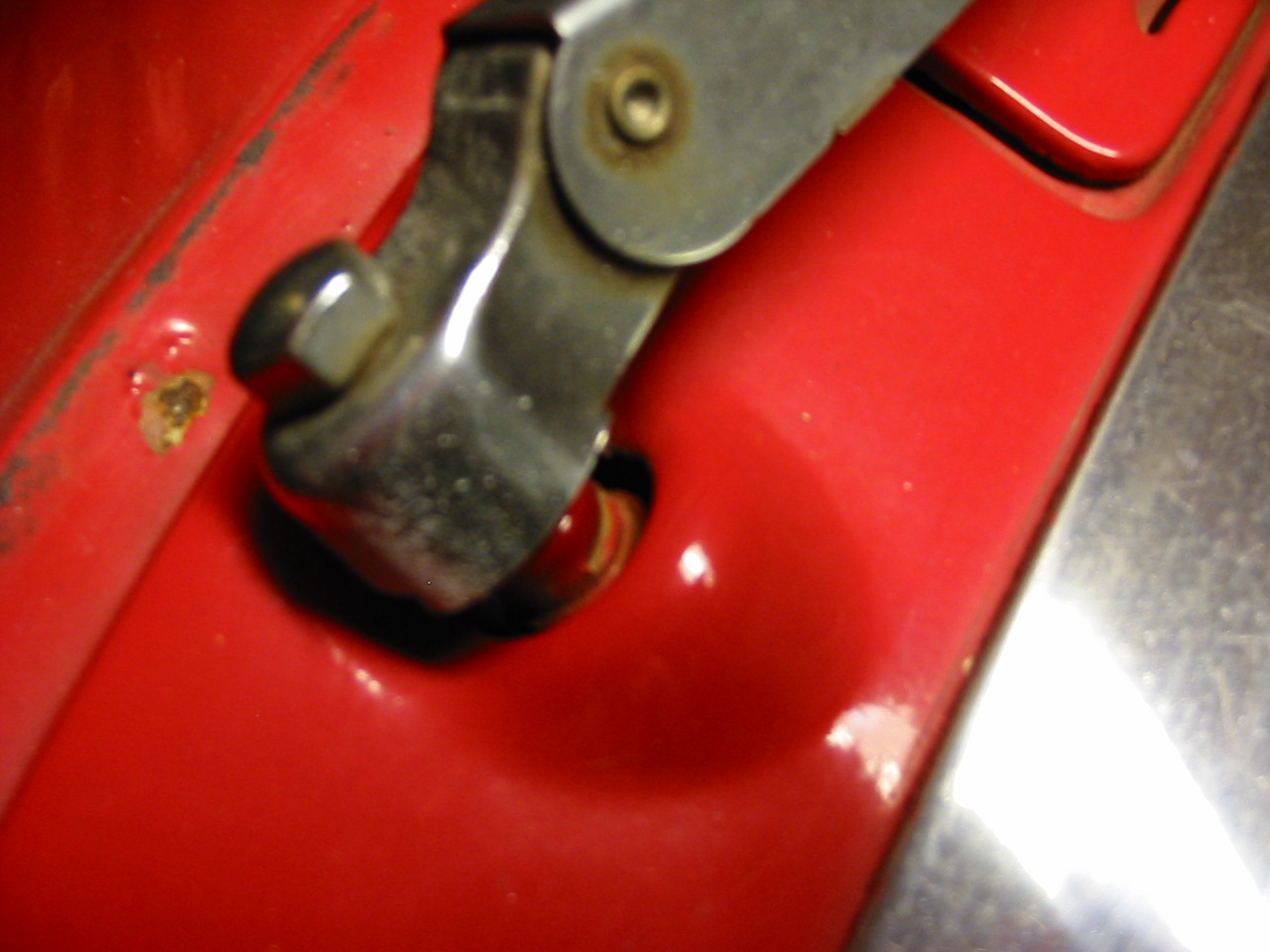

Well, shouldn't there be?! Can't water accumulate in those little wells, and rust out?

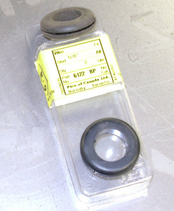

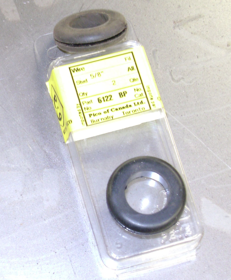

The second pic here is of a grommet that Darryl Gaspardone plans to put behind the well, between there and the pivot plate, in order to fill the gap. But, might not something like this work if inserted from the outside? Granted, it wouldn't be original... But, Ex couldn't think of everything. (Reading his bio, by the way.)

I think I'll just not drive in rain and when I wash car I'll plug the gap around wiper arms.
Or (I just thought of this) devise some kind of temporary plug that'll stay in place and when you wash car, use them, and if it starts raining when you're out cruising, attach/insert temporary plugs and when it stops raining, simply remove them.
I think you are being kind of silly...your car has not had these grommets for 48 years, why would you fuss with to install them now? Water collects and stands on many areas of our cars...the worst place is down in the cowl... have you all inspected your car's cowl drains...the cowl drains out thru the firewall, engine-side. These drains are covered, for some reason, by small rubber flaps. Flush these drains out with a garden hose, esp if you park your car under evergreen trees.
