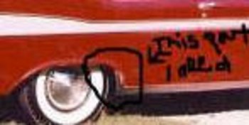

Daniel Tunell wrote:I'm working on the rust that is on my car, it not much but i must fix it! But my problem is that the rust is right behind In front of the wheel well! ...do you know anyone that has a parts car, that want to sell that part to me, but only if it is rust free and nice condition!
Does anyone know of a fabricator that could provide this part for Daniel -- or know of someone with a parts car that could cut it out? Daniel includes this picture...

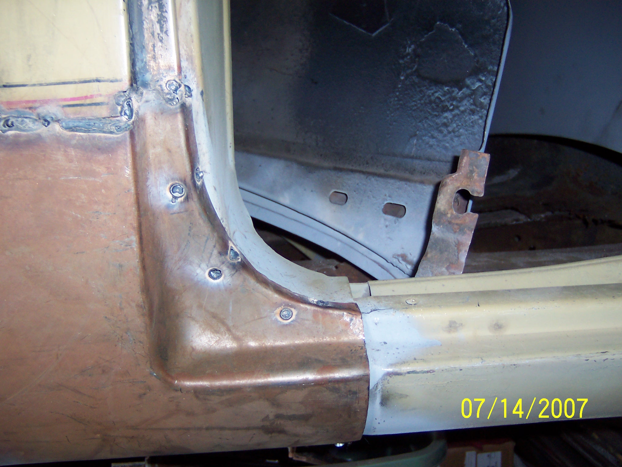

I have attached a picture of the area in front of my passenger side rear front wheel opening that went to the B pillar area and wrapped around inner door jamb of that B pillar jamb.
Is this the area he wants to repair? How high up does he need to go?
passenger rear wheel well opening to door jamb

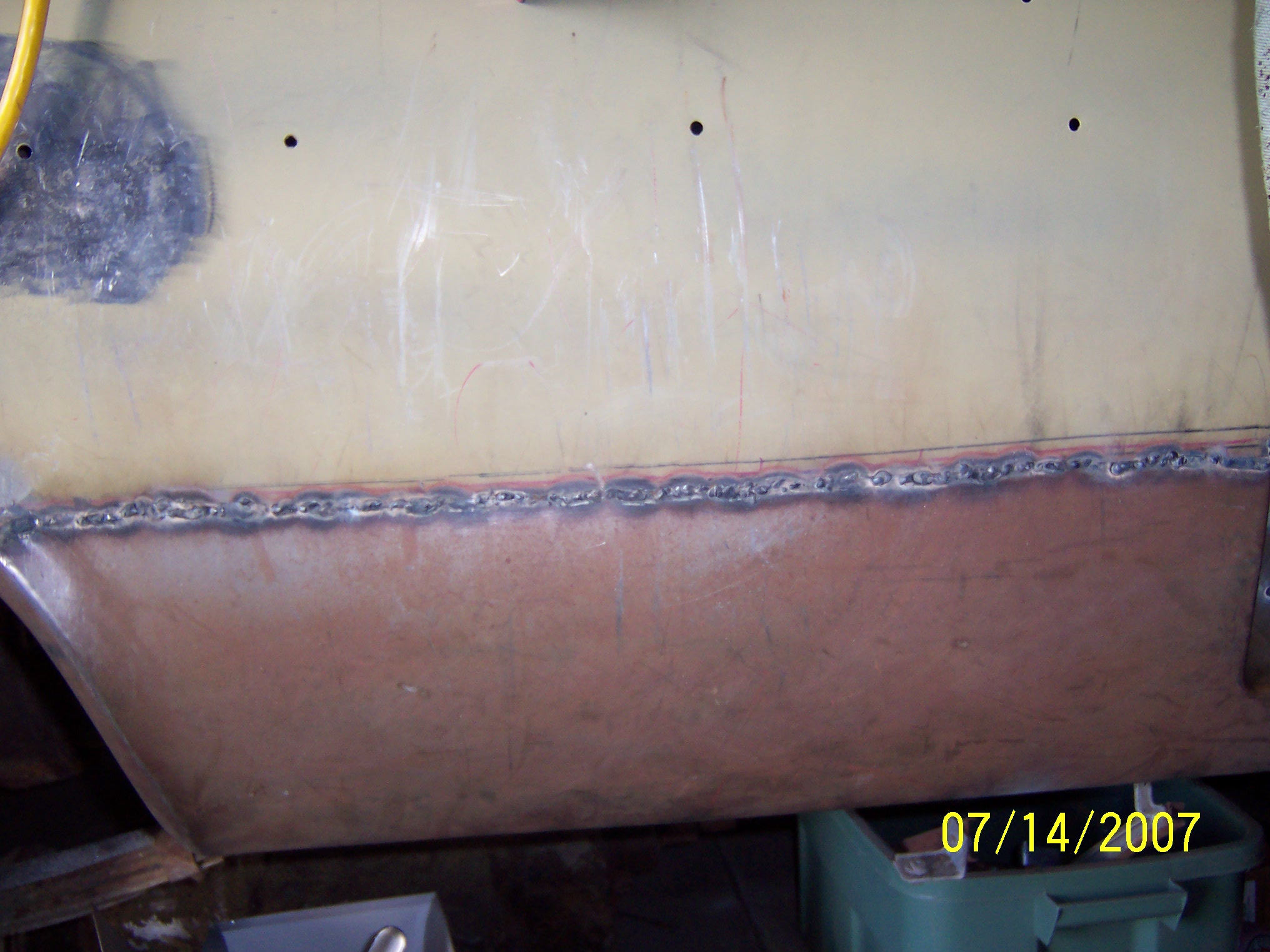

Here is a better picture of how the leading edge of the patch panel fitted into the lower part of the B pillar jamb area. I did not have to go that far as I did, since the rust was just forward of the wheel opening where the Stone guard went, but by going further forward with the patch gave me a good point to anchor the patch inside the jamb. and less body filling.
I belive this is what Daniel is trying to repair...
leading edge of repair panel after intial welding, no grinding yet..

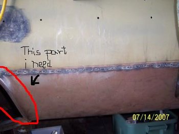

My names is daniel and ther is i that have problem with the rust! It is only the right side that is defect and need to be fixed! The link that someone sent me on ebay does notfit on my car do you meen? The part on ebay are for a 4dr do you meen? I sent a better photo on the part i need soo you understand!
I hope you understand me! :)
Thanks Daniel Tunell sweden

Daniel, I have no problem understanding your written English. Can you tell me how far foreward in (mm/inch) from the wheel well lip you need? If it is just 70mm or less, then you can use the part you see on ebay and trim it off for the importand part, the wheel lip area, and then discard the rest of the patch.
The forward part of the patch panel is the part that won't work on your car. But the rear wheel lip part of the patch panel will.
Even if you need more metal area, you can put a secondary sheet metal rolled formed patch in next to this part that has the wheel lip, to fill in any space missing.
Hopefully this helps... :)
