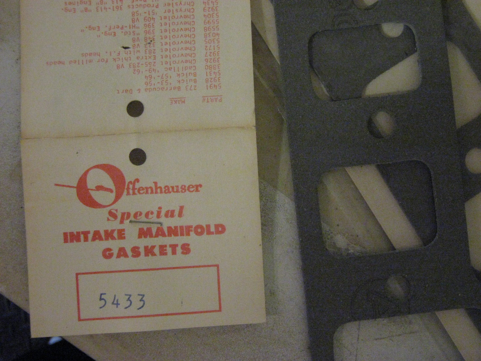

En route to Carlise 2009, I sprayed those behind me with antifreeze leaking from my recently repaired intake manifold. I had it repaired, because it was leaking... (*sigh*) I'm resigned to the fact that sometimes, if you want something done right, you have to do it yourself. So after consulting with Ed Eckerson, I bought a set of NOS Offenhauser intake manifold gaskets from Gary Pavlovich:
Ed since learned that they are available new from Phethean Racing Products, P/N 5433 for $11.50:
http://www.offyparts.com/
[This link appears to now be busted; and a Google search does not yield a result... (*sigh*.) Best to check with Gary Pavlovich. -Dan]
These are "composite" gaskets, not metal (as are the FelPro kits available from NAPA) -- and are more forgiving of minor fluctuations in the intake mating surface. The important difference, however, is that they must be retorqued -- not only after installation, but after burn-in.

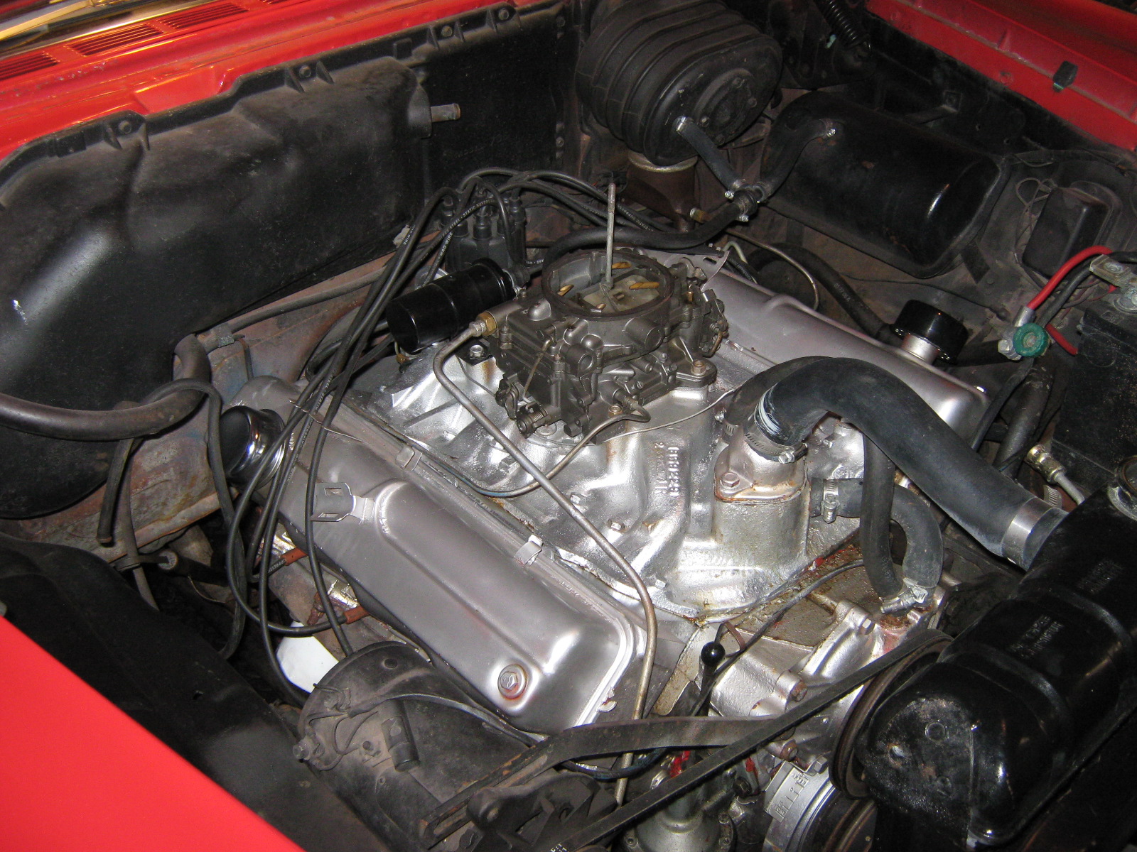

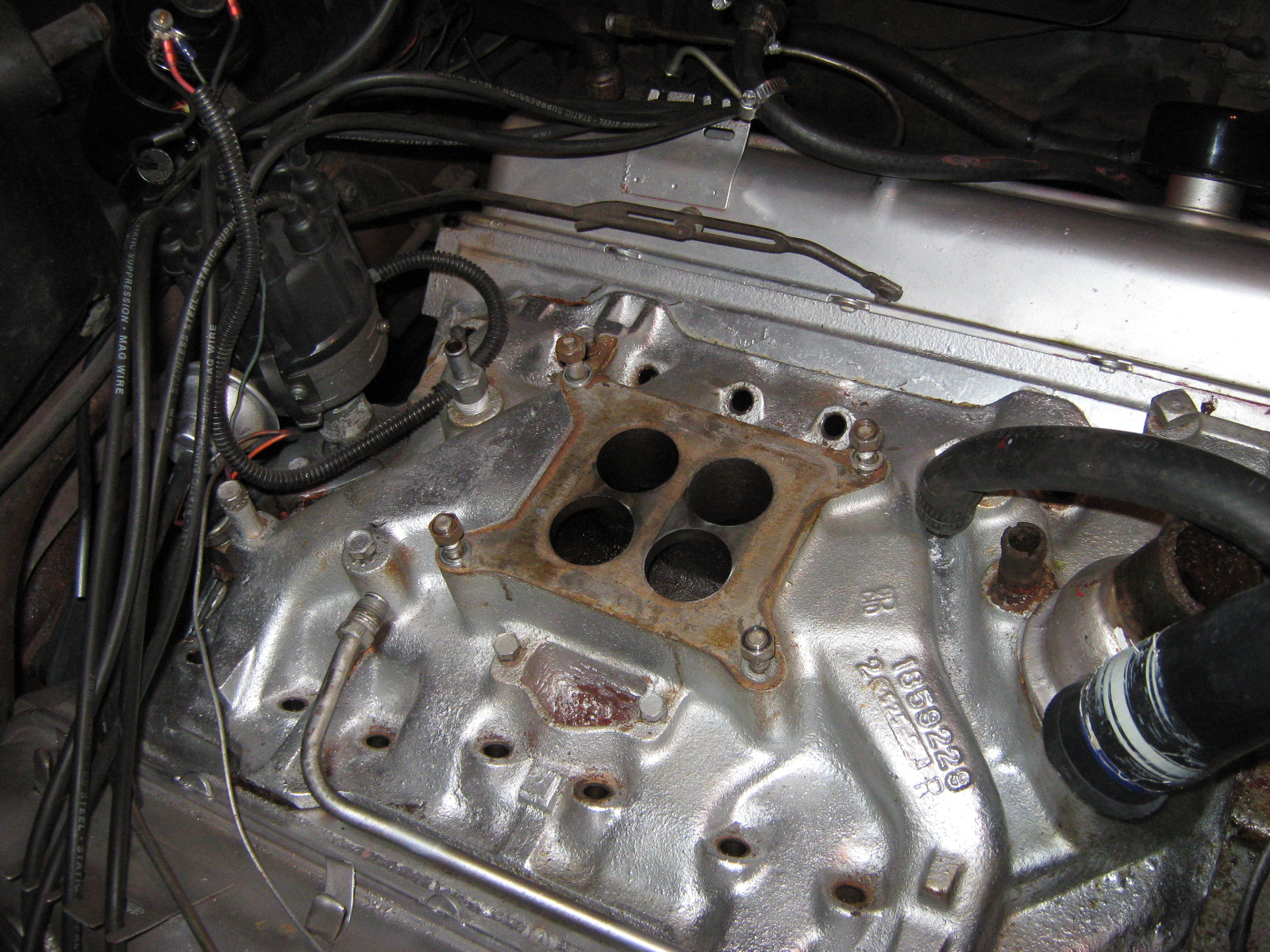

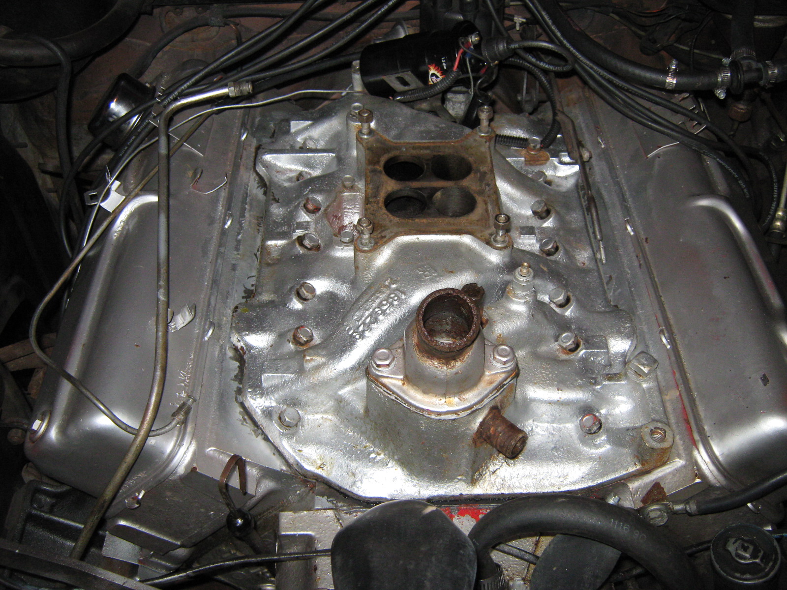

Here's the 318 before I started:

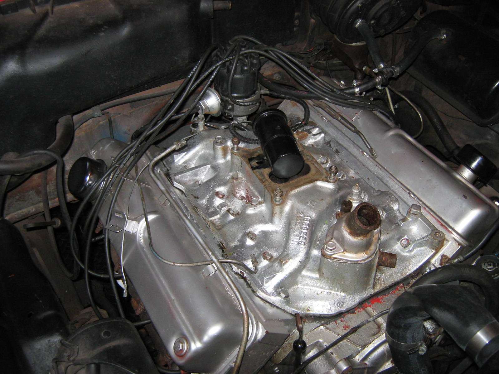

Stripped of parts and manifold bolts, the manifold is ready to remove:
I work a thin-blade screwdriver through the sealer at the front end, and the manifold pops loose. Yow! That sucker is heavy! I end up lifting it off at an angle, and setting it on the floor. Then I peer at the block...

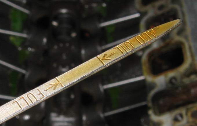

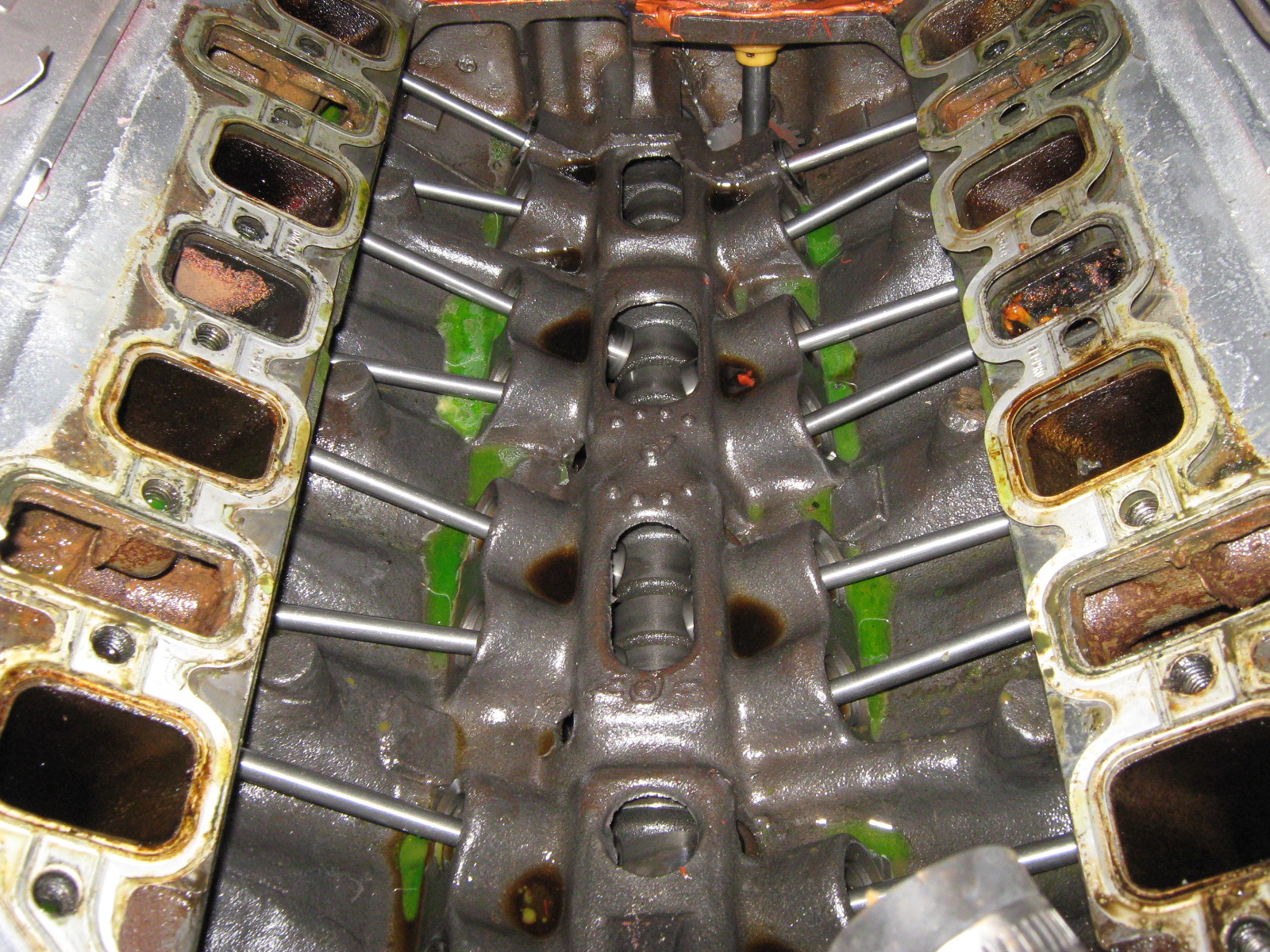

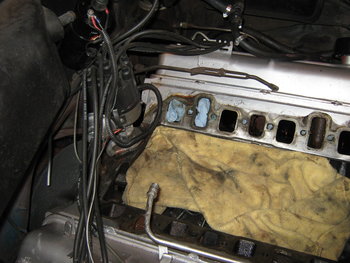

Oh no! There's antifreeze sitting in pools, next to the lifters! How did this happen? I check the dipstick...
There's no water in the oil. Whew! A quick phone call to Ed; this happened when I removed the intake manifold, likely from a pool of antifreeze within the manifold. Sure enough, where I set the manifold on the floor, there's a little pool of antifreeze. I mop it all up, and per Ed's advice, I "chase" it with oil poured liberally over the cam and ports; I'll drain the pan and refill before I crank it up, and there should be no harm done.

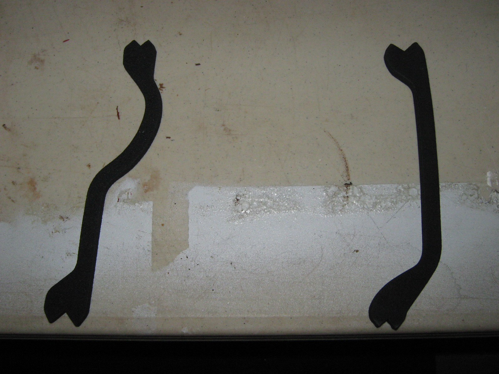

The FelPro kit I had also bought -- and ended up not using -- has front and rear "spongy" gaskets, that dovetail into the left and right gaskets:
Ed has a great suggestion: Lock down the left/right gaskets to the head with short cap bolts, and glue down the spongy gaskets in position, knowing their exact placement with the left/right gaskets -- let them set up, so that they don't squiggle around when the manifold is reset:
Enough for tonight -- tomorrow, I'll reset the manifold, do the first round of torqueing, and let it sit again. Ed discovered that, within a couple hours, the bolt torque with the composite gaskets dropped -- even without firing up! Whatever it takes, to get this finally right.

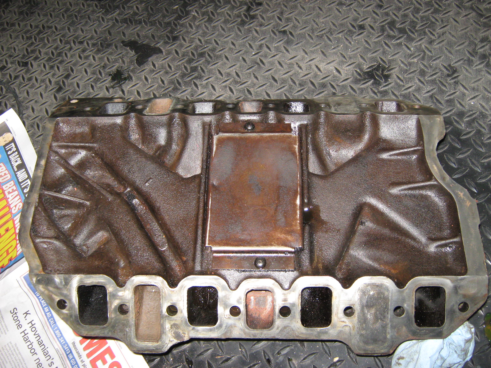

Here's a pic of the intake manifold, all cleaned up:

a perfect time to take some visegrips and "unscrew" the two "nuts" holding that cover plate on the intake...under that cover is the "Crossover"...a chamber that aids in pre-heating the carb esp. on those cold days. After 50 years. the carbon builds up in here, inhibiting its purpose. (don't take my word on it, anybody esle think my idea is timely?)
Re: Replacing intake manifold gaskets
I wondered what that plate was for! I'll give that a try, Roger.

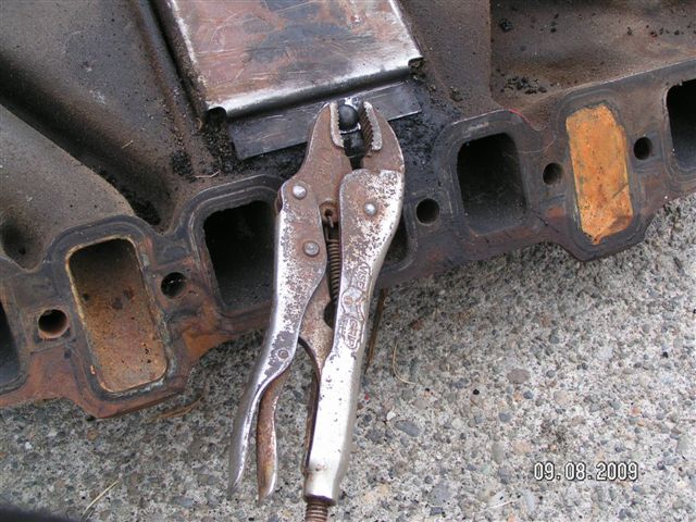

Well, it's hard to get a pair of vise grips on them... Roger's since sent me this tech note. Hmmm... I sure don't want to break one of those suckers. What to do, what to do...
"It's relatively easy to break a rivet." OK, that's probably not what I wanted to read; the thought of drilling cast iron and tapping it (with a tap set I don't have) is not a place I want to go. So, in the "what not to do" department, I'm going to leave well enough alone. I hope this doesn't come back to bite me! C'este LaVie.

Against my better (?) judgement, I tried to work a thin blade under each rivet, tapping all the around each perimeter...
Nada. These guys ain't budging.
Perhaps this is sour grapes; but, I bought this as a rebuilt engine (from an eBay seller whose client for the rebuild never showed). Is it possible that he cleaned this when he rebuilt it? I don't feel any crud when I stick a little finger in the openings... Definitely, I'm going to leave well enough alone. My advice to you when you replace your gaskets, is to pry out the rivets! :P

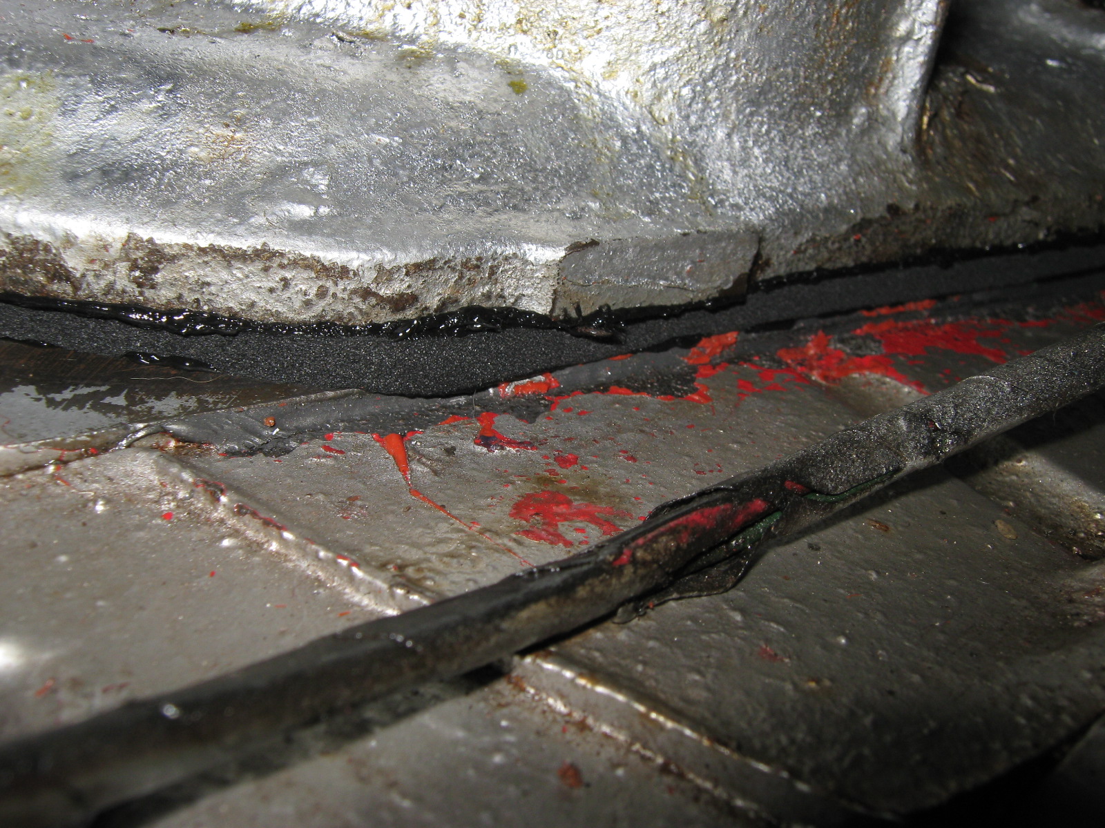

The sponge gaskets have set up nicely, and the composites are in place with just a little dab of sealer at each end. Now I coat the ends and top of the sponge gaskets with sealer, and prepare to put the manifold back. This time, I enlist Marie, and I hang two chains on the carb bolts to assist in managing:
Up and over the fender it goes! Keeping it aloft we lower it down almost exactly in place. A little translation towards the front, and... There. Lined up perfectly, and bolts find purchase in the head. Nothing moved!
Look at how nicely the sponge gaskets align with the manifold! No slippage at all. Great tip, Ed! :wink:
And now, I go for a walk: From right side to left side, torqueing a bolt at a time, working from the middle out, first 15 ft. lbs, then 25, then 30. I must have walked 5 miles in the garage!
I'll let it sit for a good while, then I'll torque them again at 30. Off to Pep Boys to get some oil!

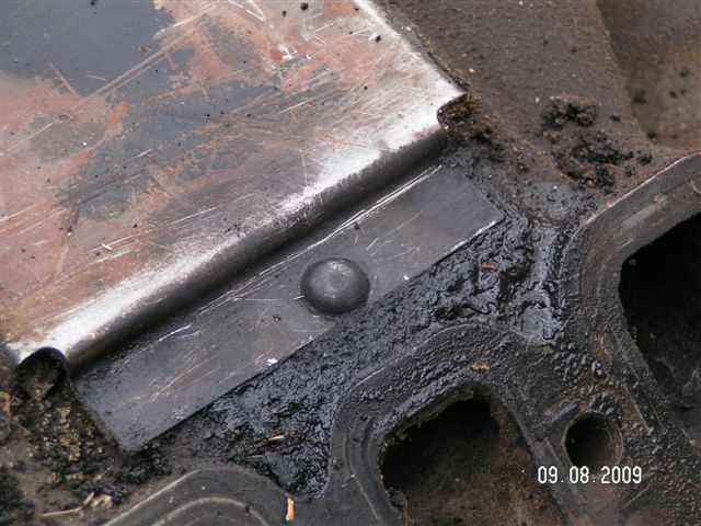

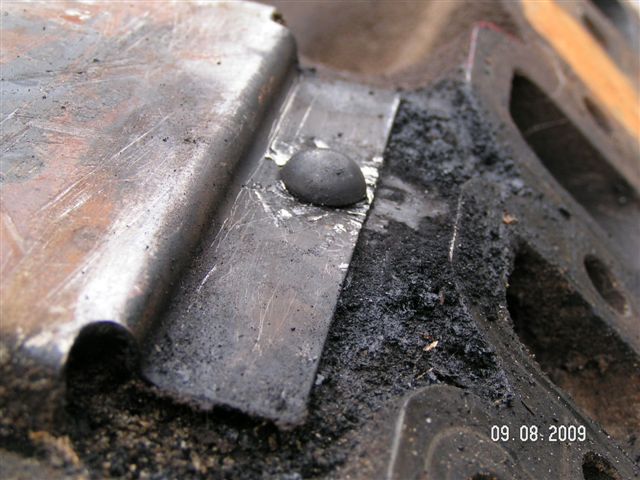

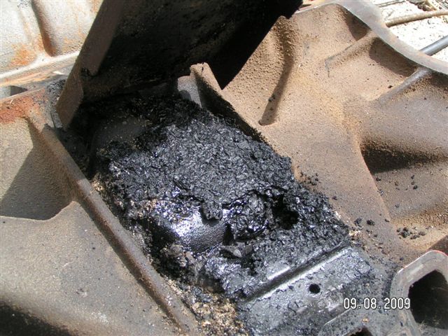

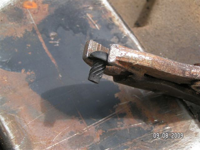

OK, for those who want to do it the right way, here's a set of pix from Roger, with some commentary:
Roger wrote:I have an intake here in the driveway and I wanted to demonstrate the cover removal, but you are already back together...

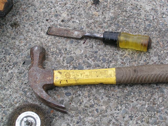

The rivet WAS difficult to loosen..it took repeated taps with hammer and old chisel both at the rivet edge and then at the edge of the cover itself.
Once it loosened, I put vicegrips on it and twisted it out easily.

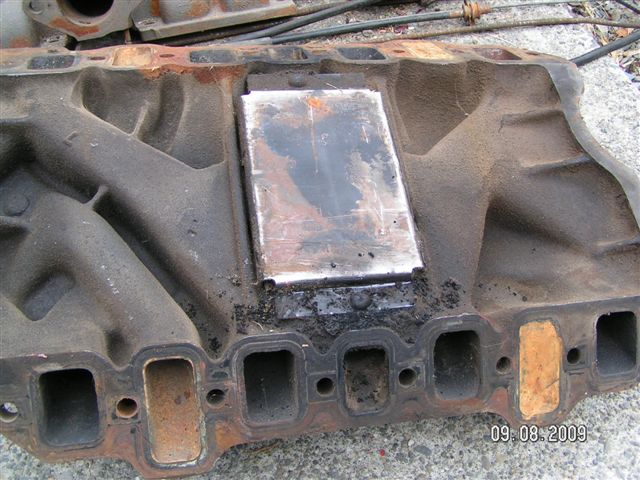

I was supposed to loosen the other rivet, but got impatient and just lifted/bent the cover enough to reveal what was inside.
My goof was in thinking that exhaust gasses passed thru here. That of course would be ridiculous, but the area somehow permits heat transference or dispersion or both...under the carburetor. The heat helps pull off the choke sooner. Maybe excess crud here causes heat to remain in the area, leading to vapor lock on hot days. I do not know.
I didn't clean the area out. I put it back together. However I must tell you there is no way to feel with finger if there is crud in there as no ports open into that area.
Wow, that sucker really is crudded up, even at the perimeter where you can see. My manifold looked nothing like that -- let's hope I'm OK. Nice shot of the rivet -- so that's what they look like. Thanks, Roger!

Dan, that metal plate/shield actually keeps the oil in the valley area from splashing up hot oil directly to the underside of the intake manifold.
As you can see when you removed the shield it still traps some oil and eventually cooks it to sludge like carbon build up. My 413 and my 440 engine has this same shield and the same sludge. Even boiling the intake does not remove all this stuff.
Without this baffle shield the underside of the maniforld heats up quicker and the non-electric choke comes off earlier then expected.
