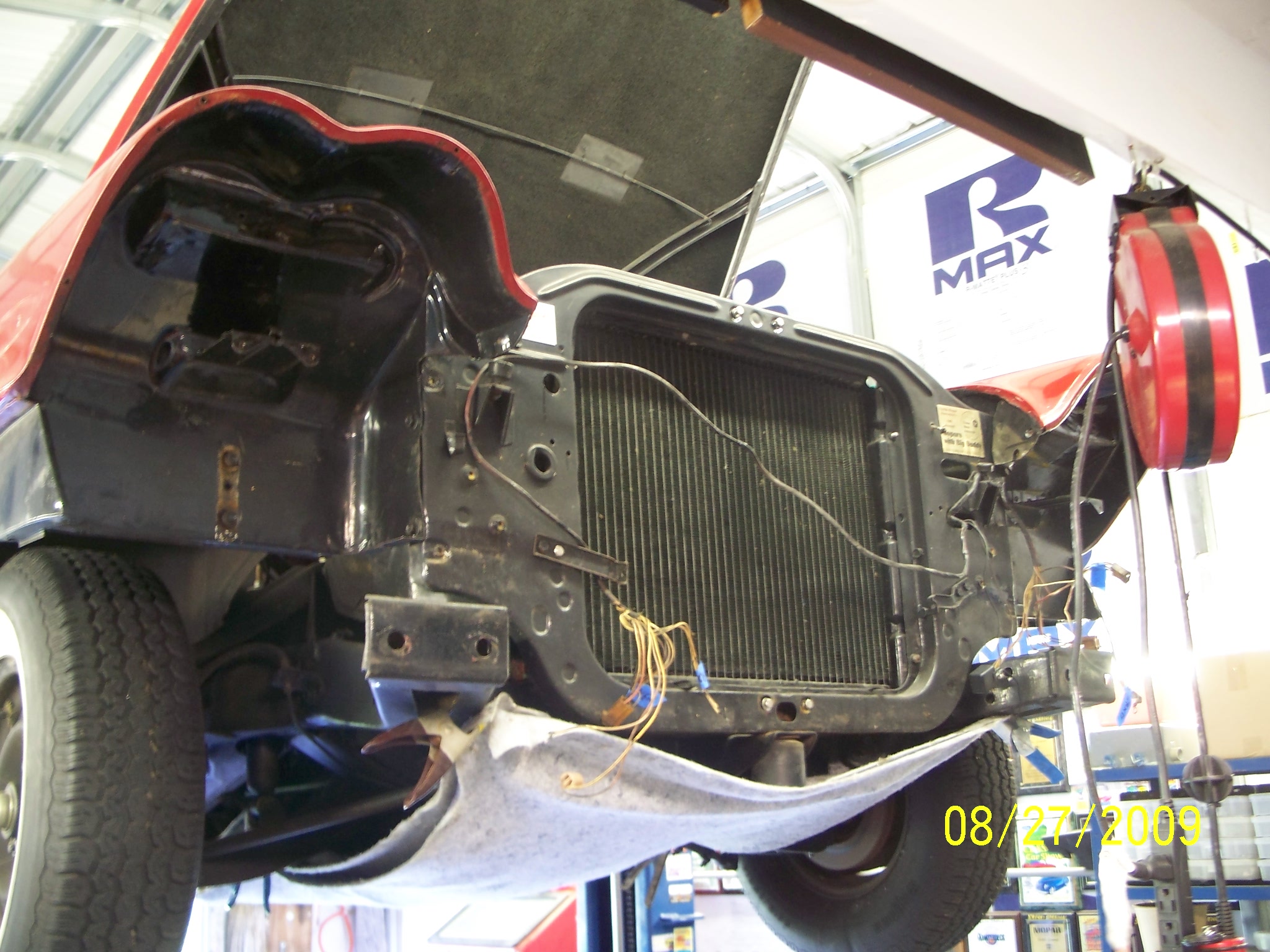

The engine started yesterday on second try. will take out gas tank today and fix brakes. Will replace trunk floor,

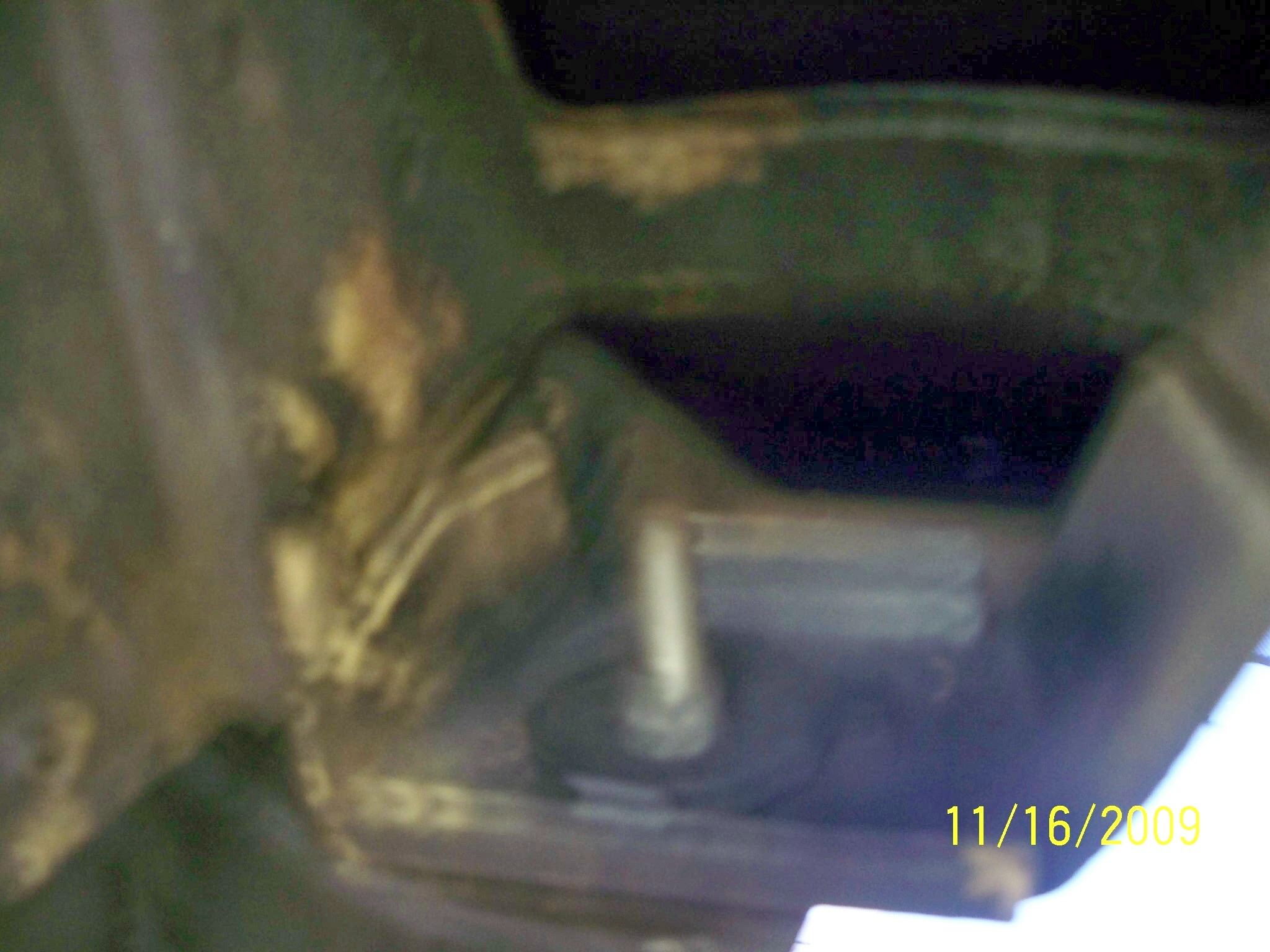

Replace all body mounts, only 4 are there, even the bolts are gone, clean and paint frame and underside before starting on anything else.
I will try to do a frame on if possible. After preparing the exterior and before painting I plan to remove the

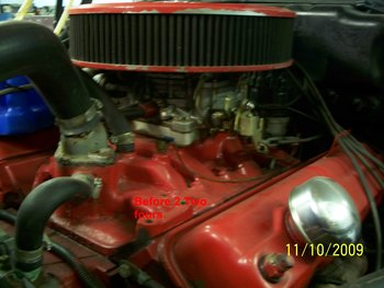

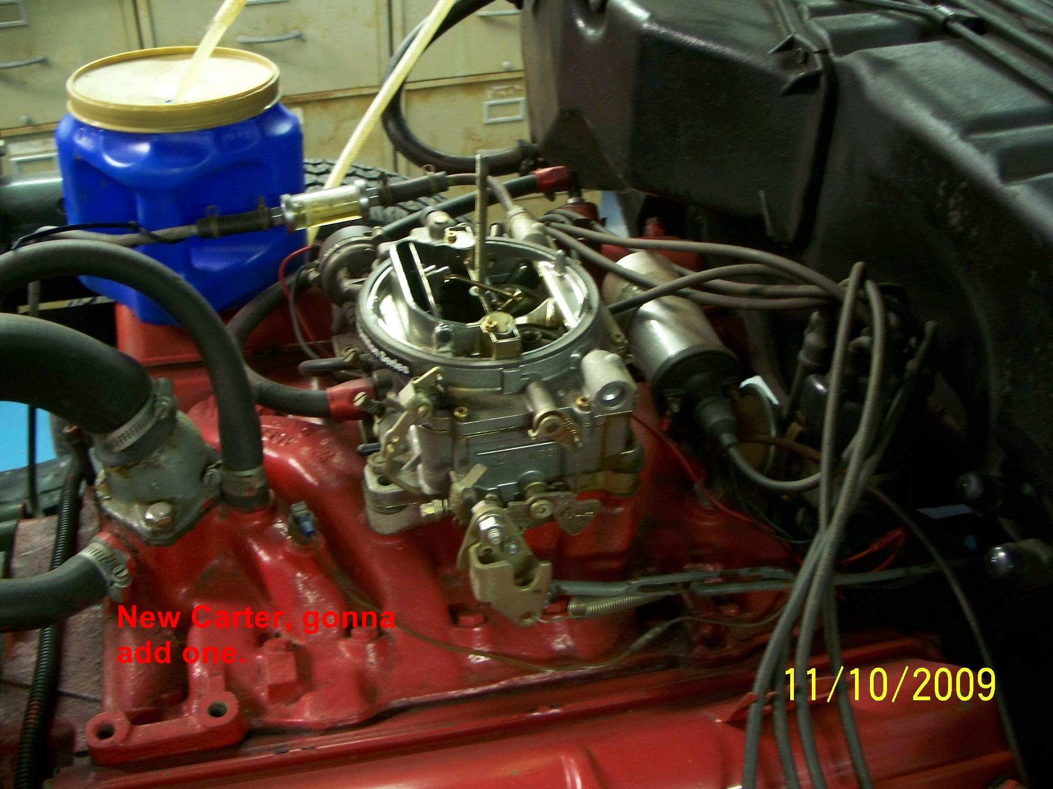

engine and clean the engine bay, the previous owner sprayed undercoat on everything, even the firewall, then I'll freshen the engine, new timing chain, new freeze plugs, and install the dual carb setup. After getting the car up on the lift it's a lot worse than I thought. Drivers side rocker panel in front of rear tire badly rusted, rust hole in panel rear of door. More to follow.

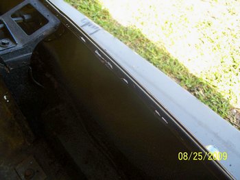

This is the tool for removing door handles.

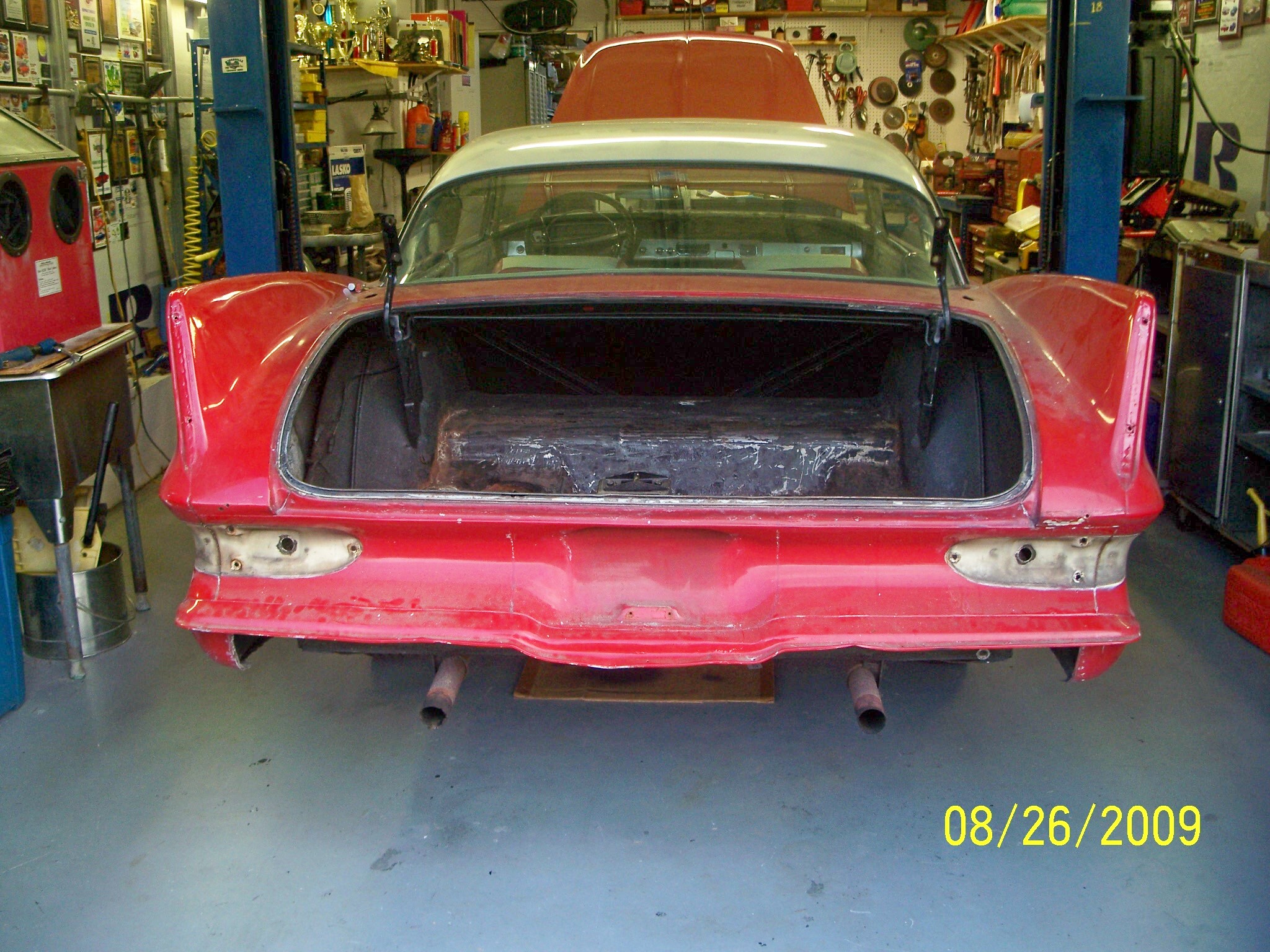

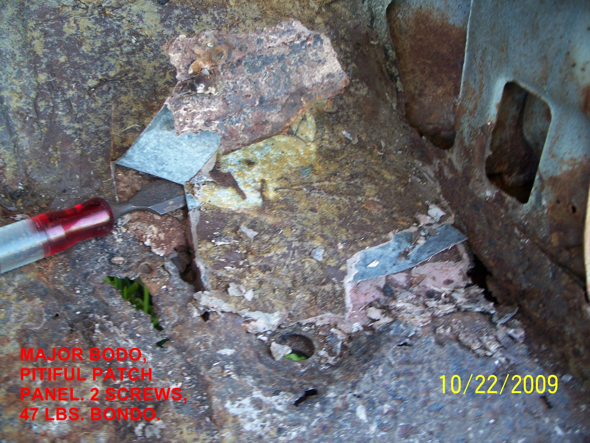

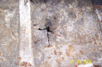

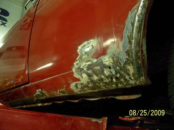

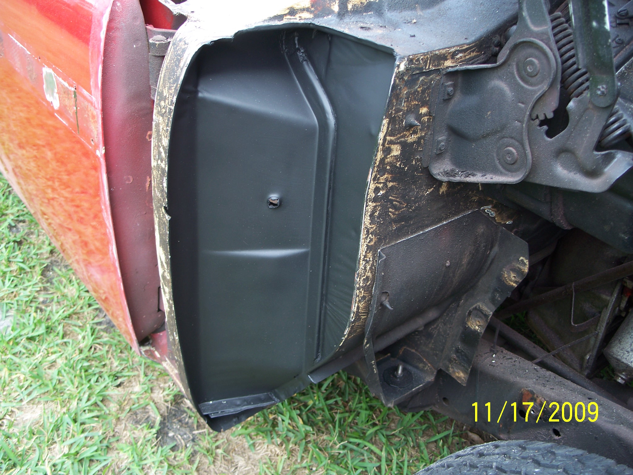

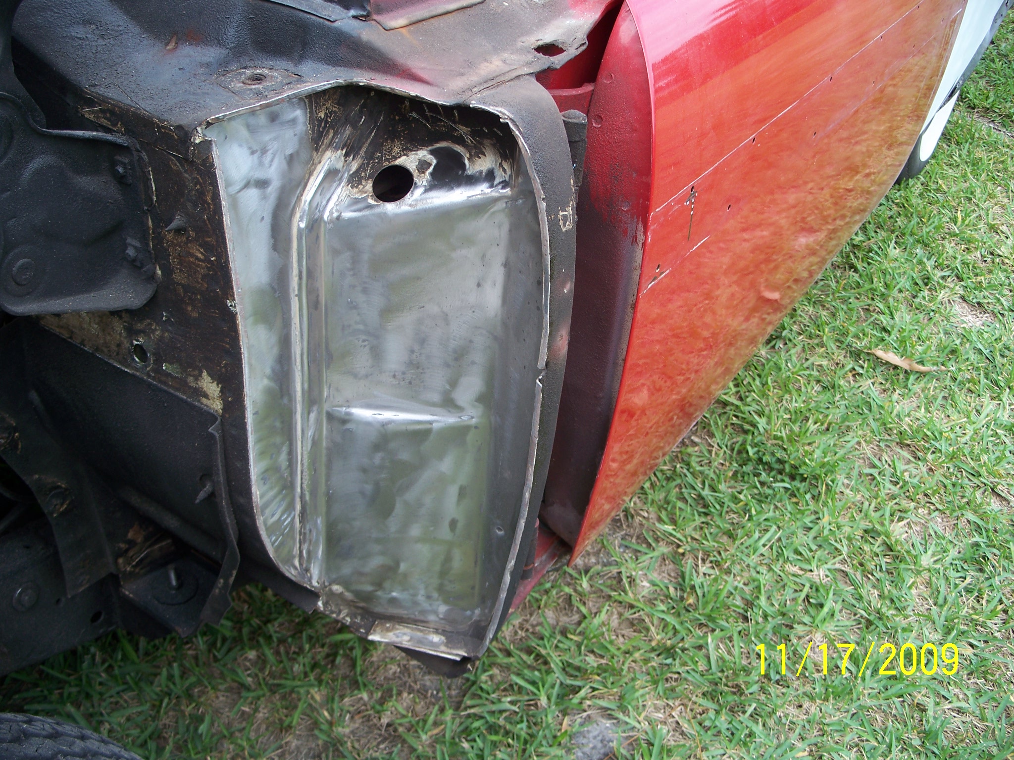

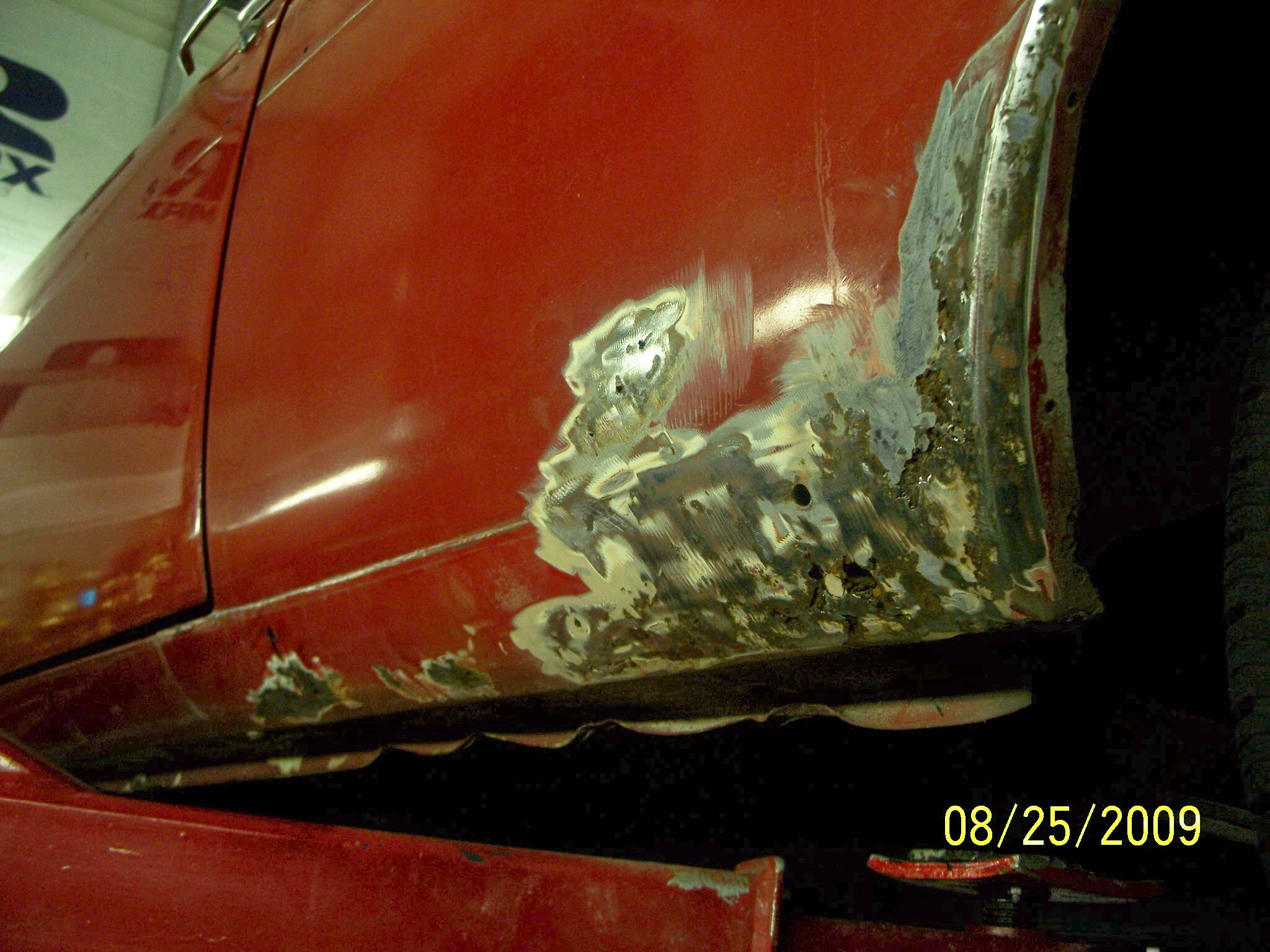

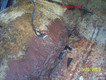

More pichers, the rust worm has really been at work. The rear panel and stone deflector had bondo were you see the holes, the car was last painted around 20 years ago. At least the bondo retarded the rusting somewhat. John (Big M) or anybody, if you can help me with the Metal Stone Deflector let me know.
Cleaned up good enough for a year or so but Bumper Boyz is off the list.

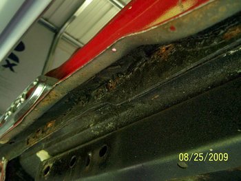

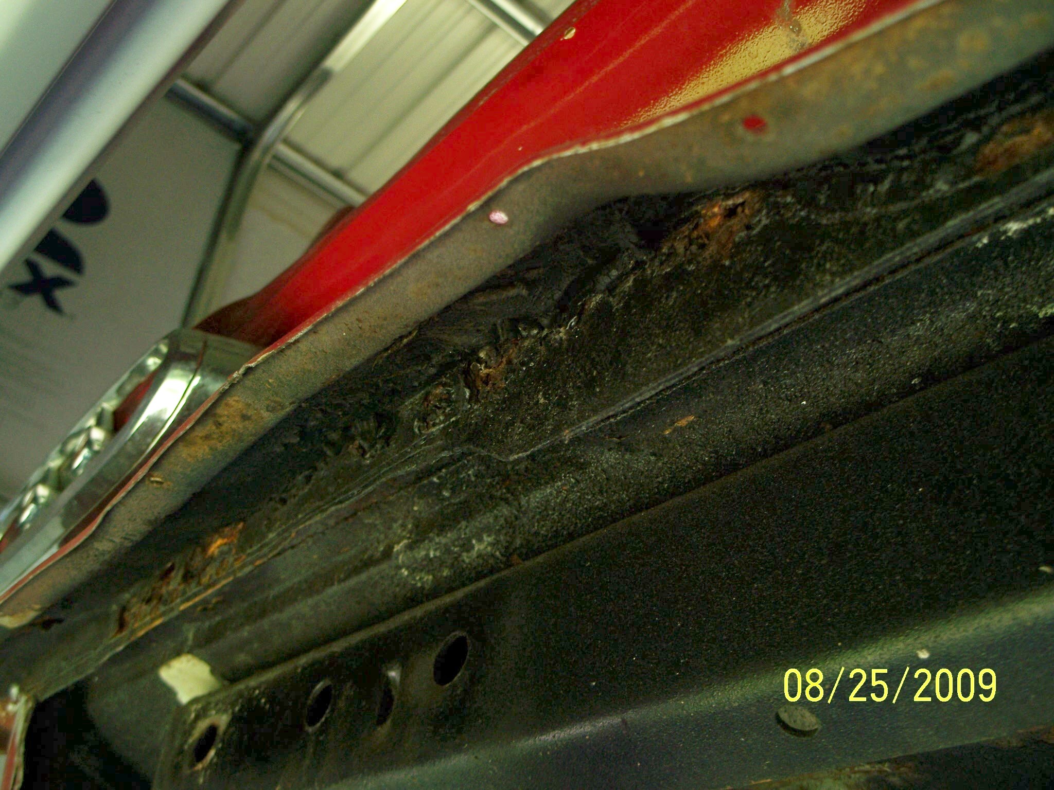

I found extended rockers on ebay, from the front door all the way to the tire well.
This will be tough to fix
Hopefully, not bad enough to need repair panel.

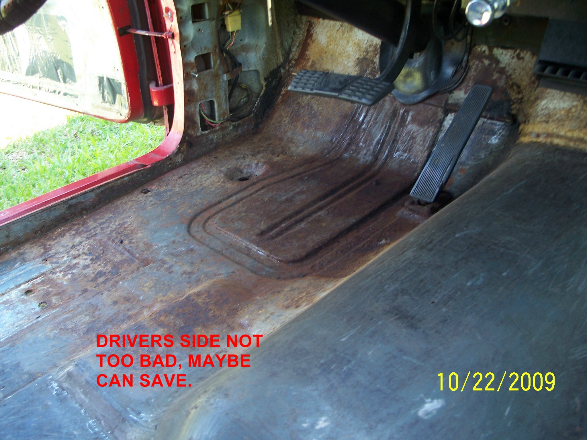

Found these repair panels on ebay.
ugh! What a mess.
How you like my new gas tank.
Car was originally white.
I painted this about 5 years ago.

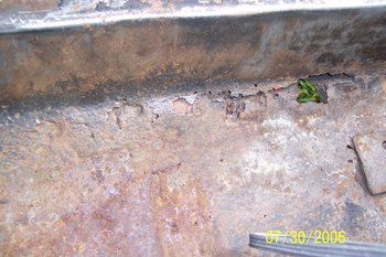

Rust Worm.

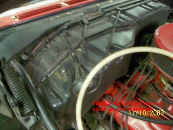

Paint Remover is a wonderful thing. I then clean with Simple Green then It gets Osphoed.
More rust worm, this is the piece I would like to replace, can anybody help.

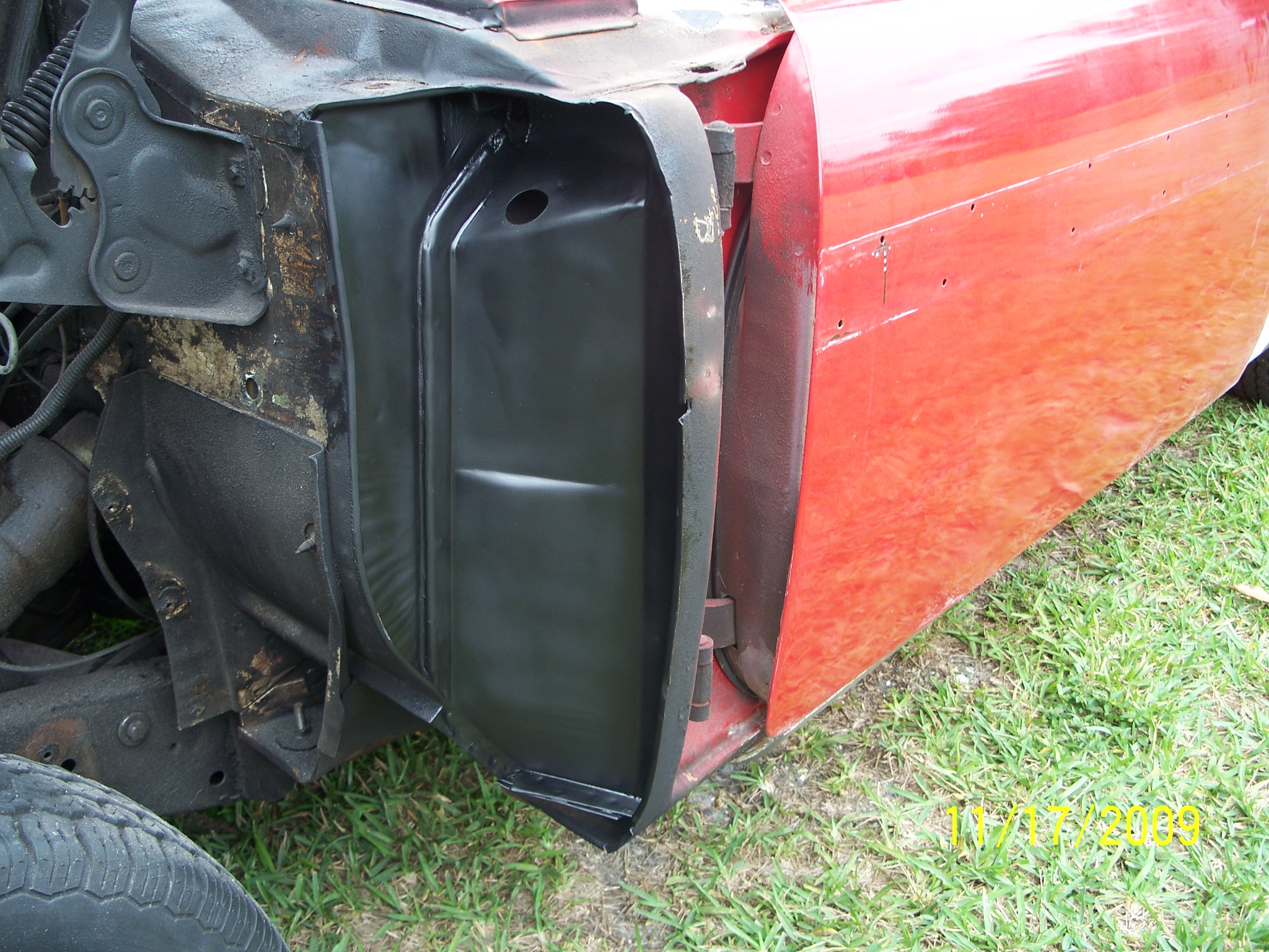

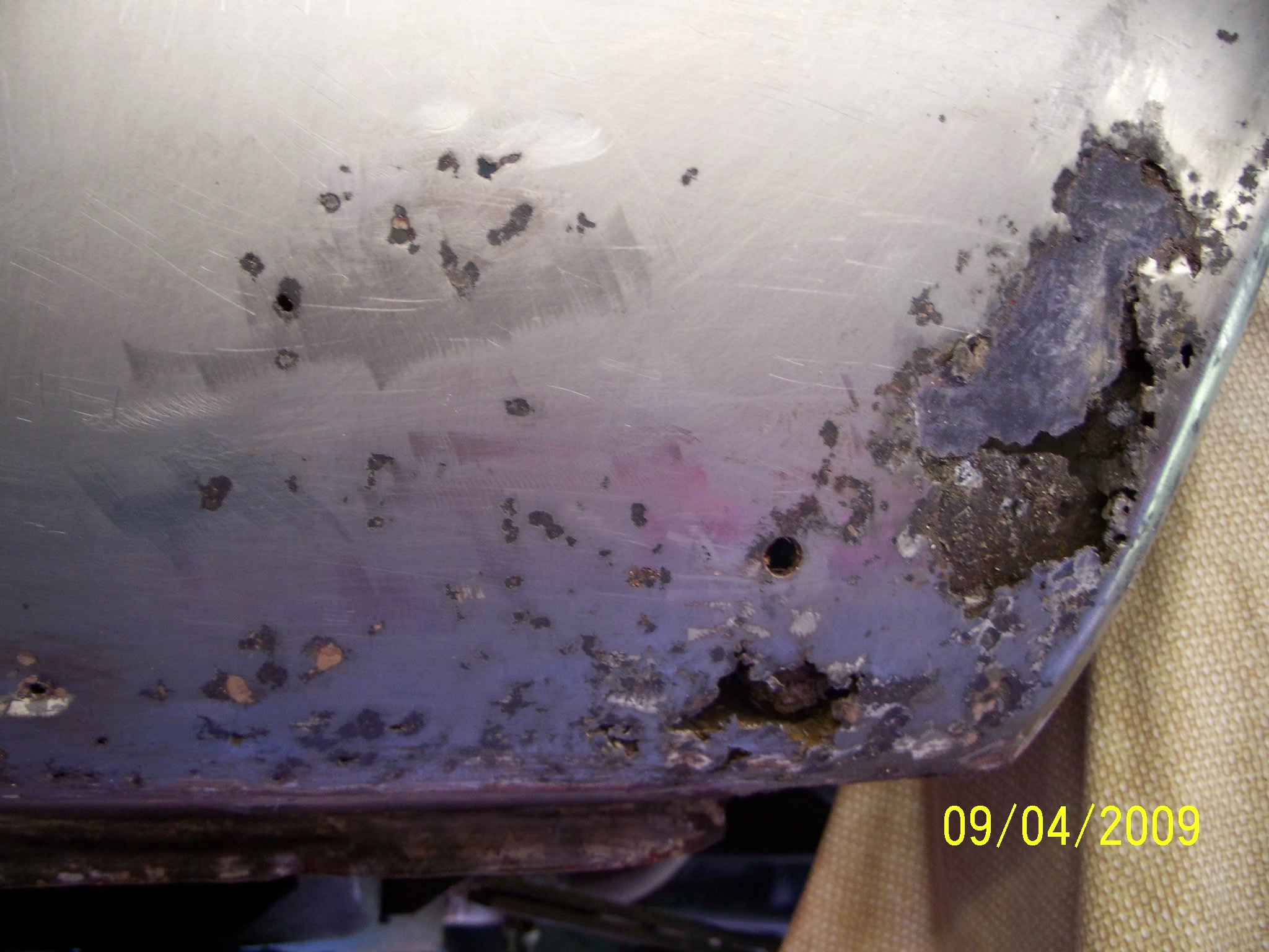

WO IS ME!! It's going to be a long winter and spring and I'm loving every minute of it. Mo pitchers of the removal of approx. 47 lbs. of Bondo. Car was painted approx. 20 yrs. ago. They did not replace any metal, at least the bondo retarded the spread of any rust somewhat. Amazingly I found every patch panel I need. To save money I'm going to do all the grunt work and my friend is going to do the fitting and welding.
Re: DICK'S 59 RED & WHITE SPORT FURY RESTORATION.
Some of the worst rust I've ever seen on a still-roadable car. I would give up in despair, were that car mine. Keep us posted.

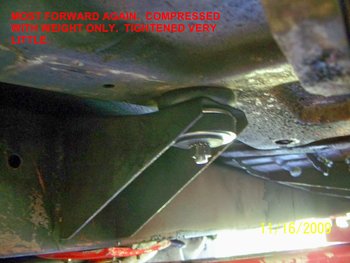

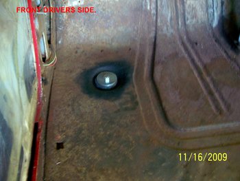

Roger - Pretty bad huh, but still very salvagable, I have all the repair panel and elbow grease needed. The most amazing thing is that all the body mounts were gone or desintegrated so badly they were useless. When I get finished you will be proud of me.
A little bit here, a little bit there, I got the body mounts in, started car to move out of garage and felt the difference immediately in the amount of vibration. Almost none.
