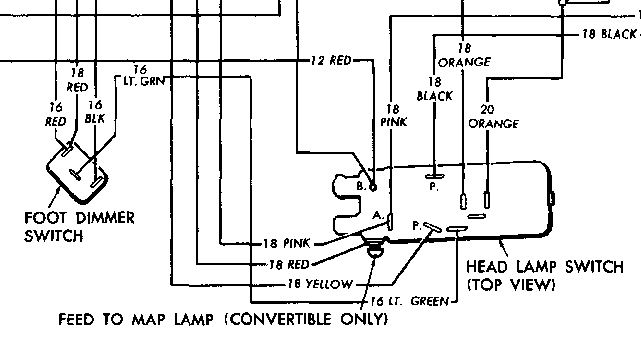

Dick Koch wrote:Art - The extra yellow wire with the connector is not needed for your car. Just hook up your wires same as on the old one and you should be OK. It doesn't matter which side the main post is on. I am going to forward your email to Dan and ask him to post your question and pictures on the 59 site so you can get the expertise of others and a better answer than mine. I think the switch you have is for a Chrysler or Imperial. I have one like that and l always wondered what that extra wire was for.

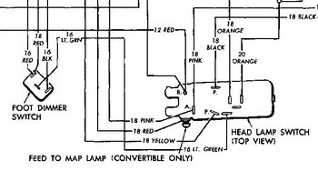

I'm inclined to agree with Dick - there's nothing I see on the schematic (below) that indicates anything but the yellow wire for the rear parking lights, already called out elsewhere on the switch. What do you think?
