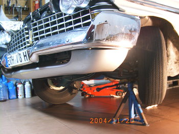

One of my major concerns this winter was to improve the handling of the Sport Fury. During the general restoration a couple of years ago, all the ball joints and bushings had been replaced, all the hangers had been reworked and the caster and chamber were readjusted. Nevertheless in harsh curves the body “rolled” very strongly and sometimes it almost pulled me out of the seat. The solution showed up a couple of month ago, when I got an original Sway Bar with all hangers and bushings. The only parts that didn’t fit were the brackets to the frame. They had been cut off and therefore I had to weld them on again. Here’s the pictures of what I did:
My SF didn’t have a sway bar, so I had to find the right place for the brackets.

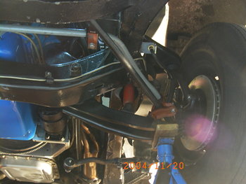

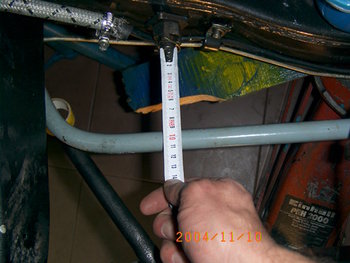

With a tape and some plastic straps, the sway bar comes in position.

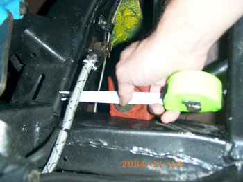

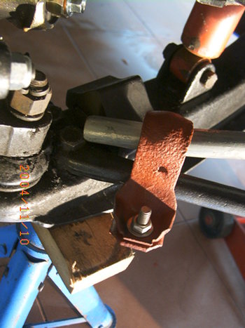

The bolt of lower control arm strut is a good reference point and allows a precise adjustment.

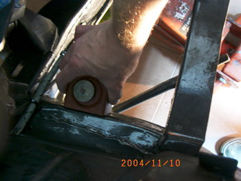

The original bracket is in the right position, or is it not? I have to check the clearance in all directions now.
Last check – everything still in the right position?

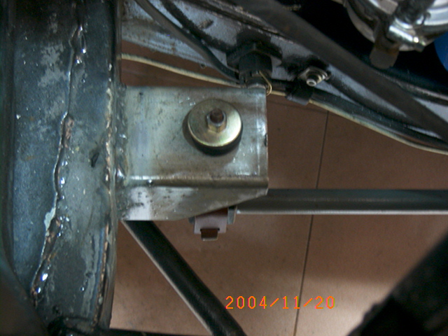

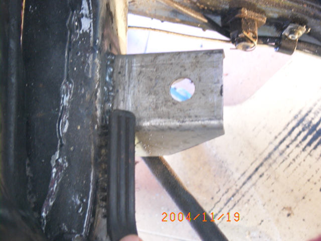

A new bracket is on the frame.
Clean the welding seam
Good enough for now. Later, after the first test drive I’ll do it better (hope I don’t have to change it)

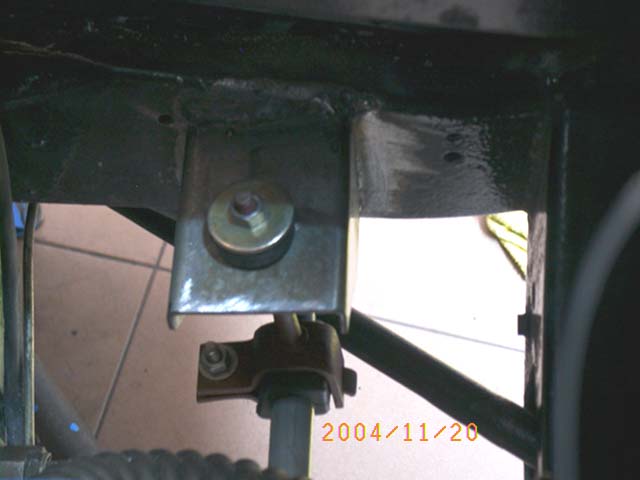

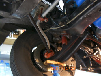

With hanger and bushings on the right and left side – it already looks pretty good.
The little hole on the right corner or the bracket is a perfect reference point.
Drivers Side
Passenger Side

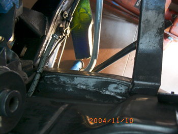

Clearance between Frame and lower control arm strut

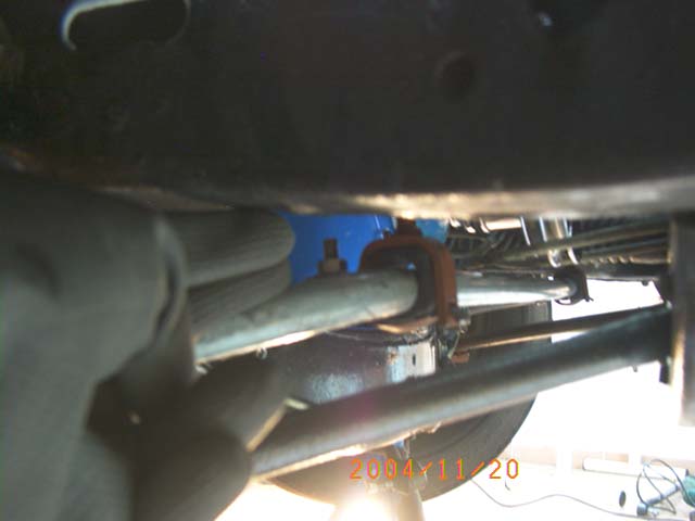

The moment of truth – does the sway bar move freely in extreme situations?
