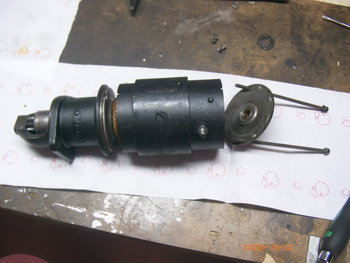

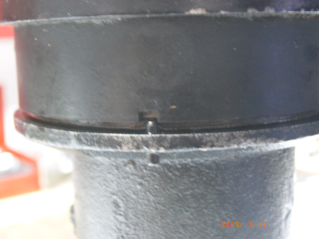

To begin, the battery and the starter cable should be disconnected. It takes three bolts to romove the starter from the bell housing. To dissassemble the starter unit remove the two screws on the back of the unit. If it doesn’t fall apart immediately hit it softly with a plastic hammer around the housing.
The housing is removed and the spindle slips out.

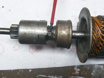

To disassemble the bendix from the head two screws have to be removed…
... then the bendix is free.
The splint can easily driven out with a punch. Then the bendix unit can be removed from the rod.

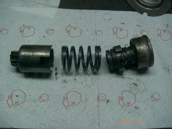

The rear clamp must be pulled back and …

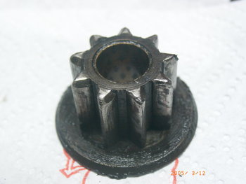

... the starter drive comes out. Check the drive for bad teeth! When reassembling the spring should be greased.

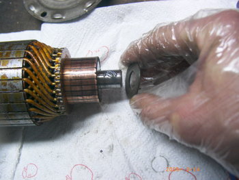

If this disc has a gap, then the bearing is worn out.

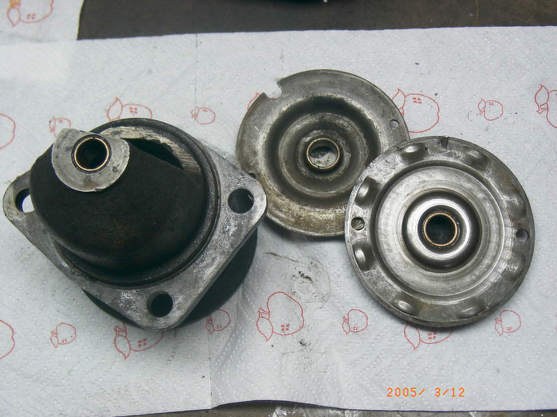

There are four bearings to replace. One is in the head section, the second is in the starter drive, the third is in the middle plate and the last one is in the backing plate...
...Most likely all four of them are worn out during the years. Ask for oil-impregnated bearings!

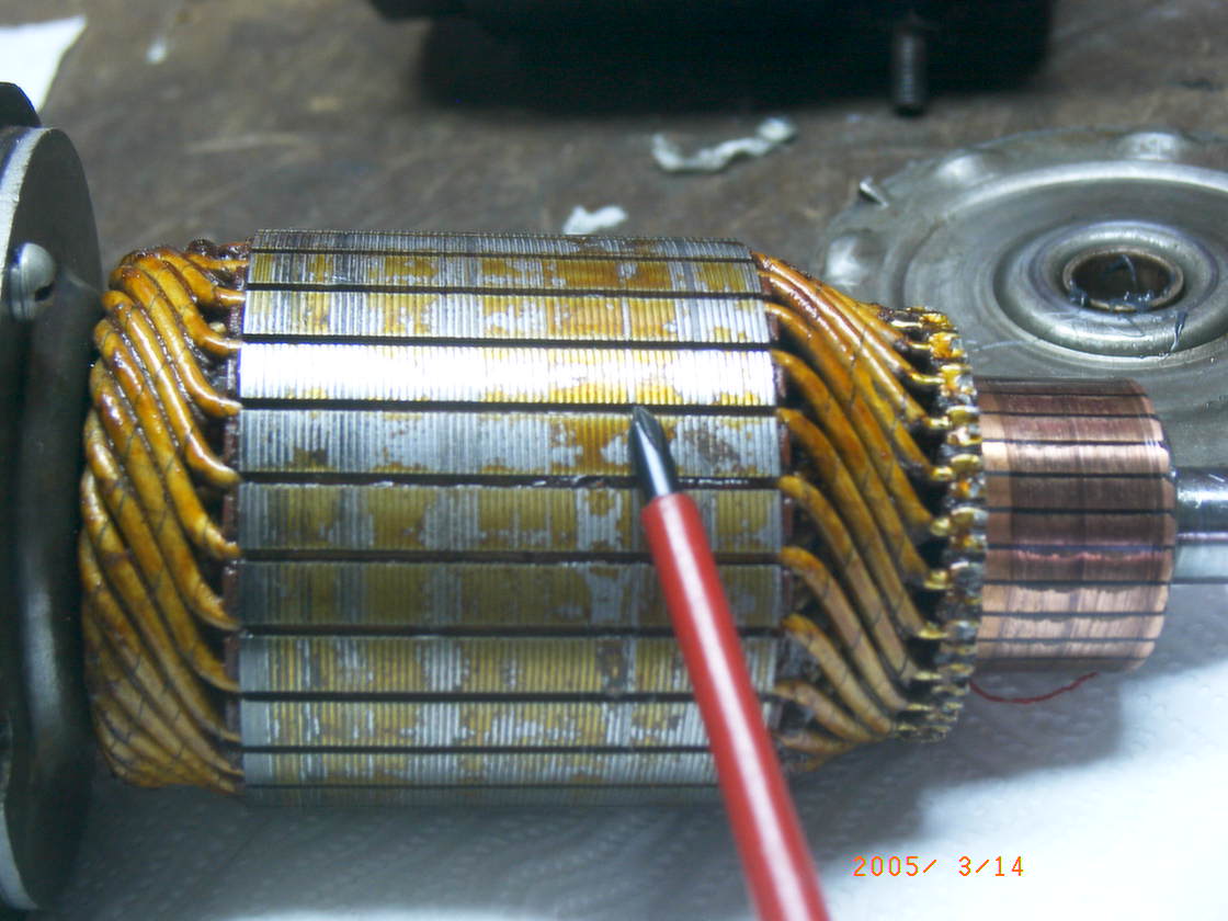

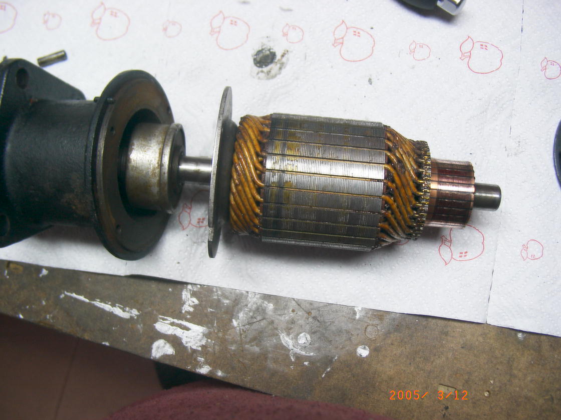

Check also the main rod, just in case! Usually the bearings are much softer than the main rod and it should be ok.
This is what happens after a while if the starter is driven with bad bearings. The metal plates of the spindle may strike against the magnets in the housing.
Here, three pieces with new bearings. The old bearings are laying next to the new...
Starter drive and middle plate reassembled and equipped with new bearings

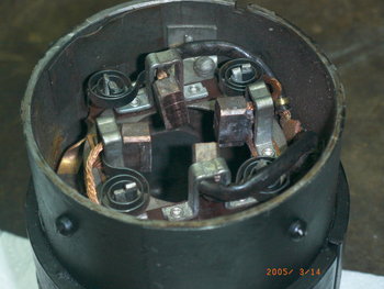

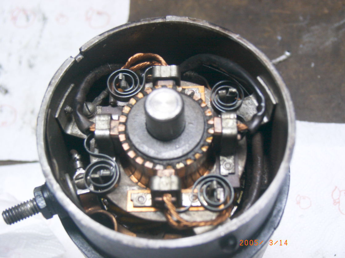

Check the brushes. If necessary, now’s a good time to replace them.
Four screw drivers hold the brushes in position – just another way to assemble the unit with two hands only.

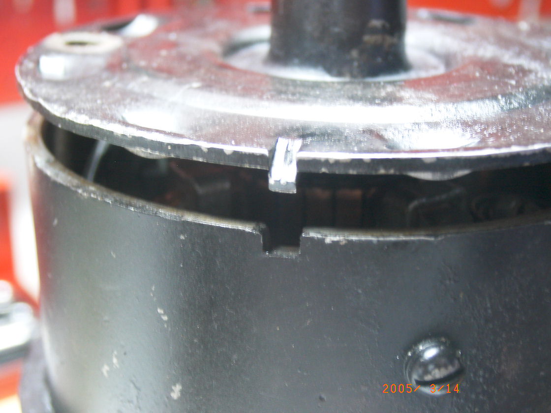

The front of the starter housing slips into a rod on the head ...
... while the backing plate slips into the slot on the housing – no way to fail.
