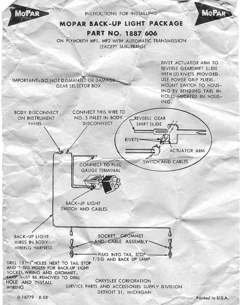

I recently bought the kit to add backup lights. It has the two sockets with their connectors, and the bracket that mounts on the pushbutton assembly. The switch, however, is missing. I've located one, but the guy wants $25 for it.
Does anyone know the part number for the switch itself? I'd like to call around to a couple of places before I pay this. I tried looking in my parts book, but could only find the number for the standard shift switch. The part number for the package is 1887 606, as you can see from the attachment. (If someone has a switch they'd be interested in selling, that would work for me too! :) )

Do you mean the switch that is in the circle? It says "switch and cables"
Yup, that's the one.

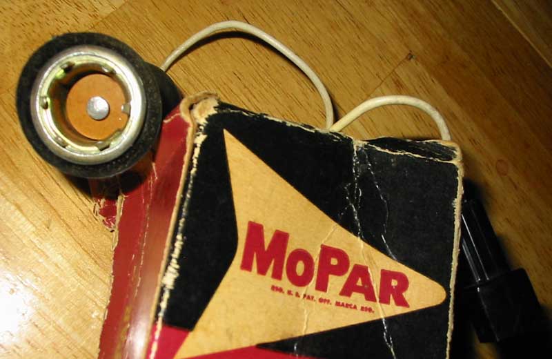

Makes perfect sense, Dan. I have two Reverse switches..one installed in a parts dash and another loose unit in the shed..the latter one is much easier to access and ship. I would send you the complete shifter unit..no sense in stripping it out of something I will never need or use. Guess I ought to test its' operability first! I also have junky tailight pods with Reverse lights still in them, if you can figure out how to remove them! Can you post a picture of your Kit? I'd like to see how they dealt with the retrofit of the sockets. At the factory, they machine-pressed them in...
rogerh wrote: Can you post a picture of your Kit? I'd like to see how they dealt with the retrofit of the sockets. At the factory, they machine-pressed them in...
Sure, I'll do that tonight. Say, do you think my pods might need holes drilled in them?
No, you won't have to drill holes. The pods have the holes there already, they have been plugged with spring-fingered plugs (if I remember correctly).
I put reverse lites in my last Plymouth, using aftermarket light sockets, purchased at the auto parts store, having springy-fingers on them. I will send you a picture.

Here's a pic (albeit, not a good one). Looks like they just have little fingers that snap into the socket...

okay, what I expected, but wanted to be sure
Thought I'd complete this thread.
I sold Dan a used shifter pod with attached switch. I had to cut one wire, as it was permanently attached to the Disconnect block. The kit's Reverse lights will snap into holes which are already in the taillight housings (the holes have snap-in covers which are easily removed). Dan's trunk wiring harness should include the necessary plugs to add the Reverse lights. It is a relatively easy project.
