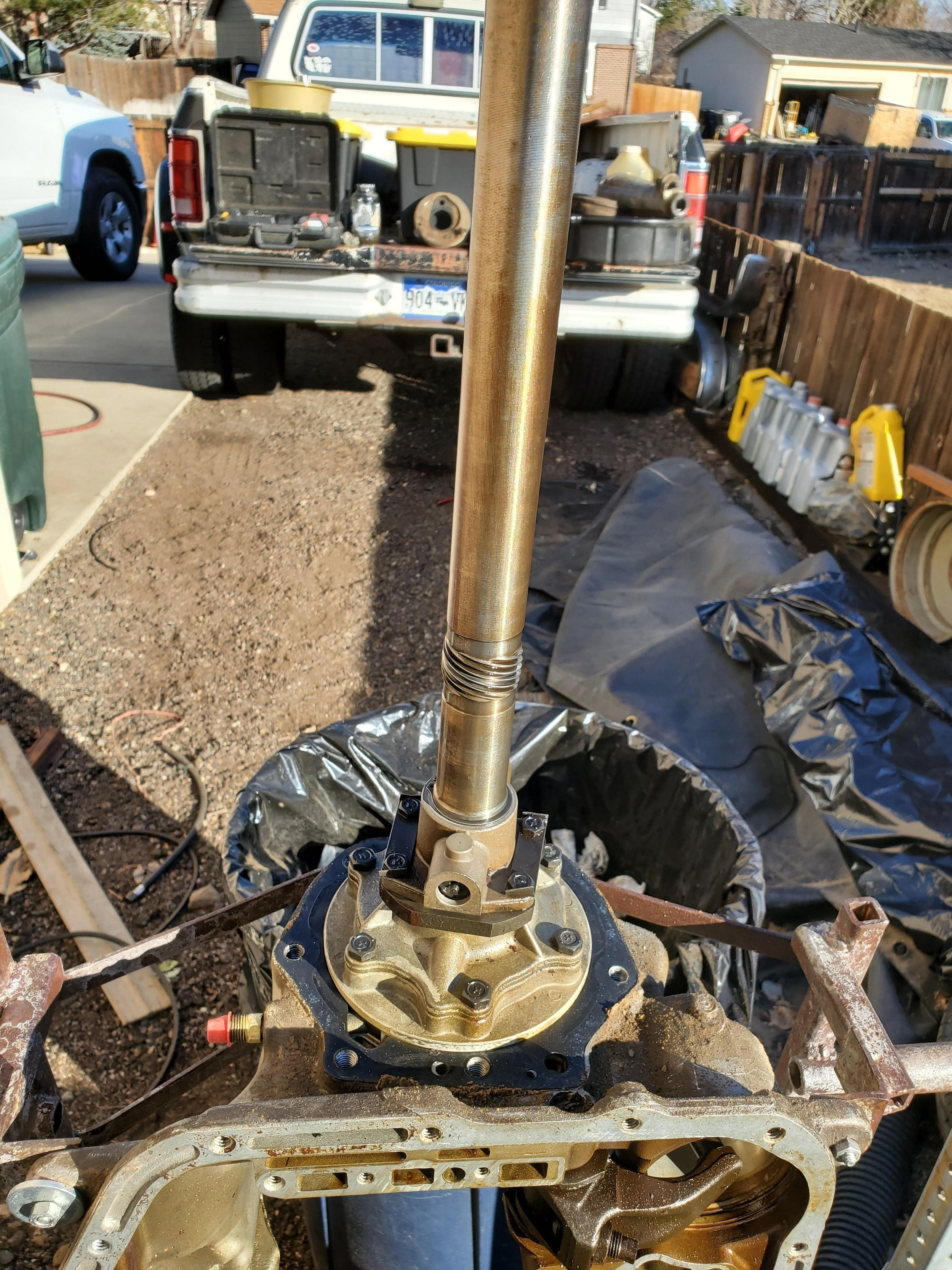

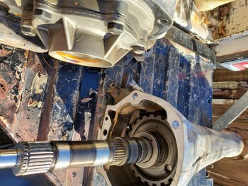

Converting A-466 to A-727 push button 62 to 65. I performed this conversion many years ago, and are revisiting it now, helping a friend of ours resurrect a non-moving forward look convertible. after pricing front pumps and torque convertors as well as rebuild kits, We decided to up grade to a still serviceable A-727 push button operated transmission. I like this conversion being it works so well and still can push start the vehicle if necessary, and uses a starter that is easy to find.
Known problems in conversion;
Crank shaft length difference and number of flex plate bolts. Finding the 62 E brake tail housing some trucks used this also and later years.
Solutions;
Change out crank shaft with 62 or newer, take your old crank shaft to engine balance provider and have it indexed and match the old balance.
use an adapter kit.
We are using and adapter kit being retaining the long stroke A engine. Hot Heads on the left and R&D Power Engineering right Gold B&M 426 Hemi flex plate. Prefer the on on right for many reasons.
will continue as work progresses.

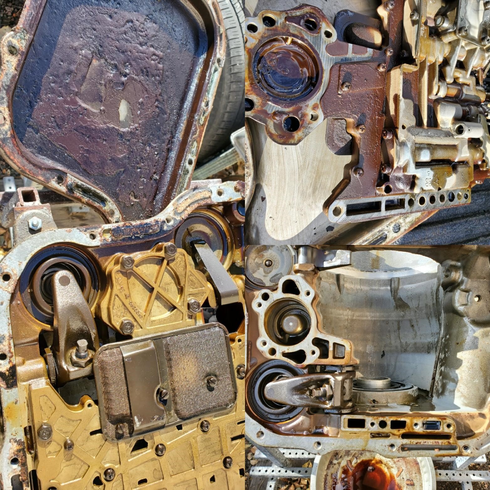

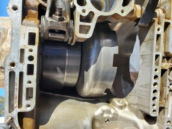

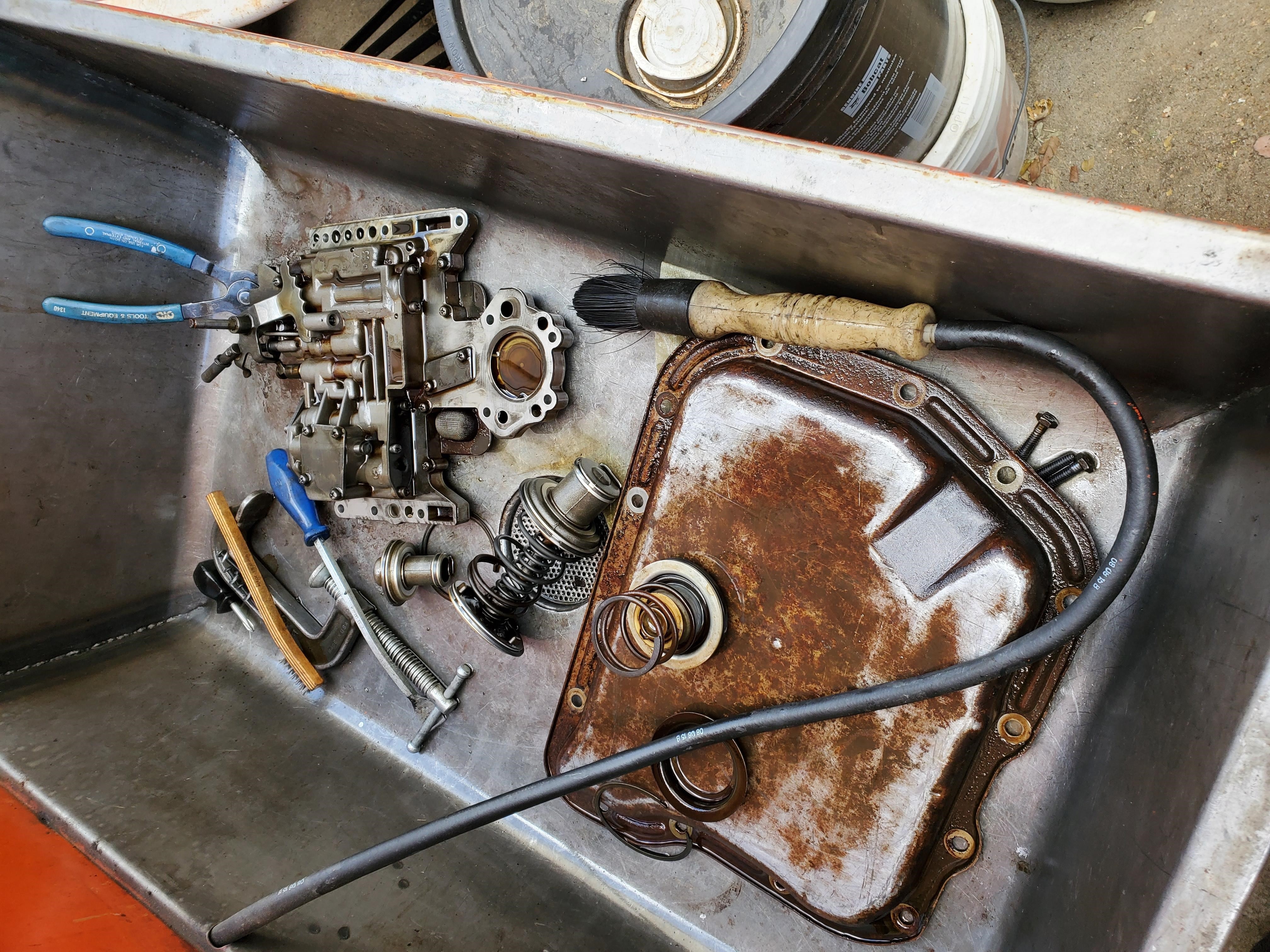

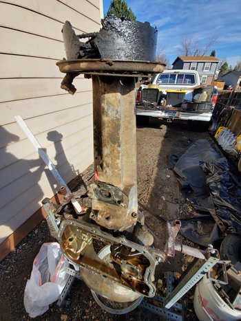

Sunny today but not warm. Decided I'd better continue this endeavor and not find my human remains on the couch. I found a huge mess of brown shoe polish coating everything and about 1/8 inch deep in transmission pan, and clogged filter screen. Disassembled everything including band servos. Scrapped off all the brown shoe polish I could get to trying, not to ruin my solvent tank. Found rear pump check valve also to be clogged, but the rear pump survived and is still useable. Yes I did spray off the valve body with brake clean before removal. Planning on changing second gear band apply lever to a better ratio, and installing a drain plug in the pan, an inline transmission cooler line filter not just a magnet as well as a Gil Younger shift kit, so we can select the RPM when the transmission shifts. Pictures below

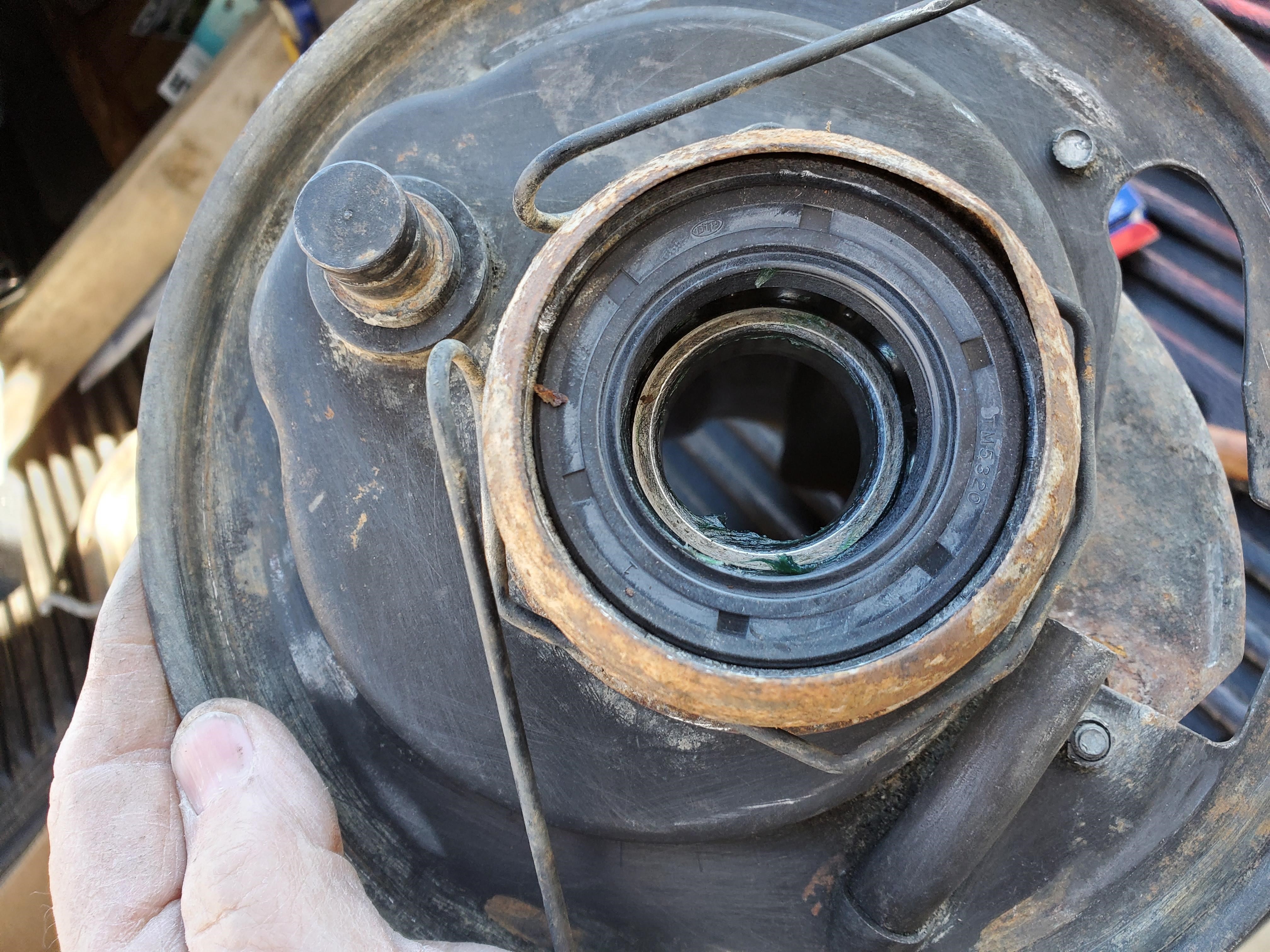

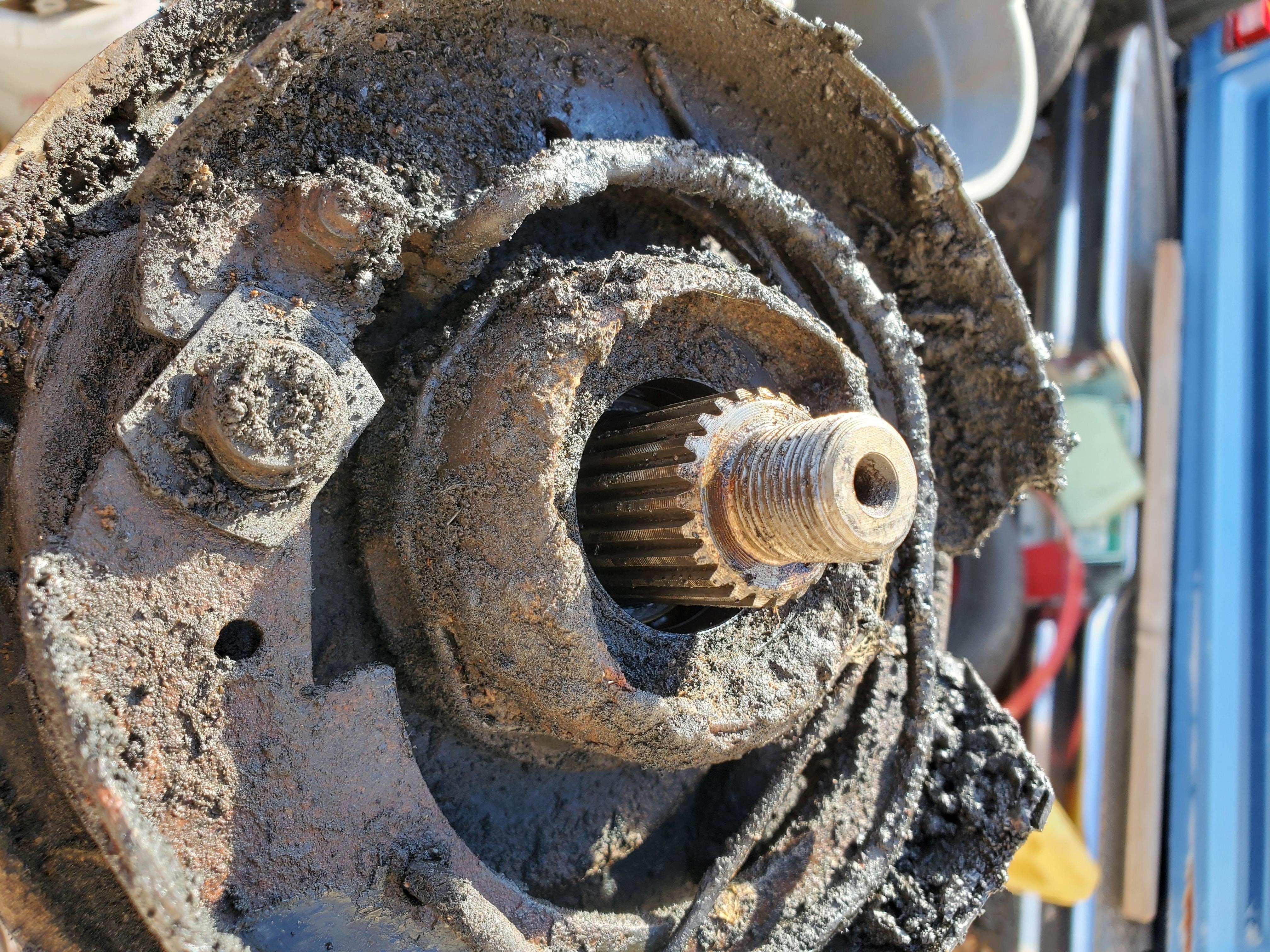

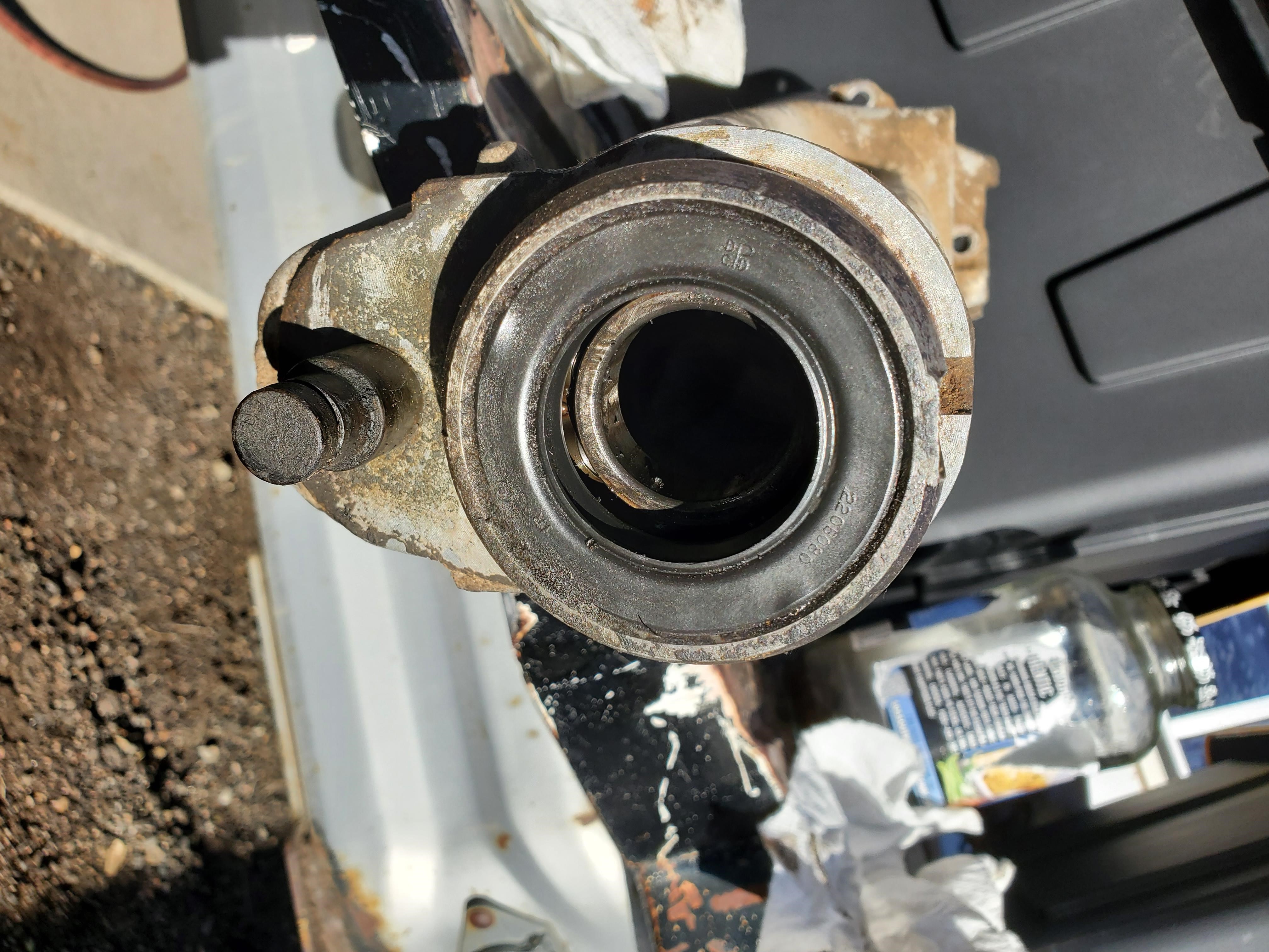

Continuing E brake repair and cleaning, found pieces to be missing, like adjuster wheel and pivot shaft and bad E brake shoes. Lots of cleaning to finish. More pictures below.

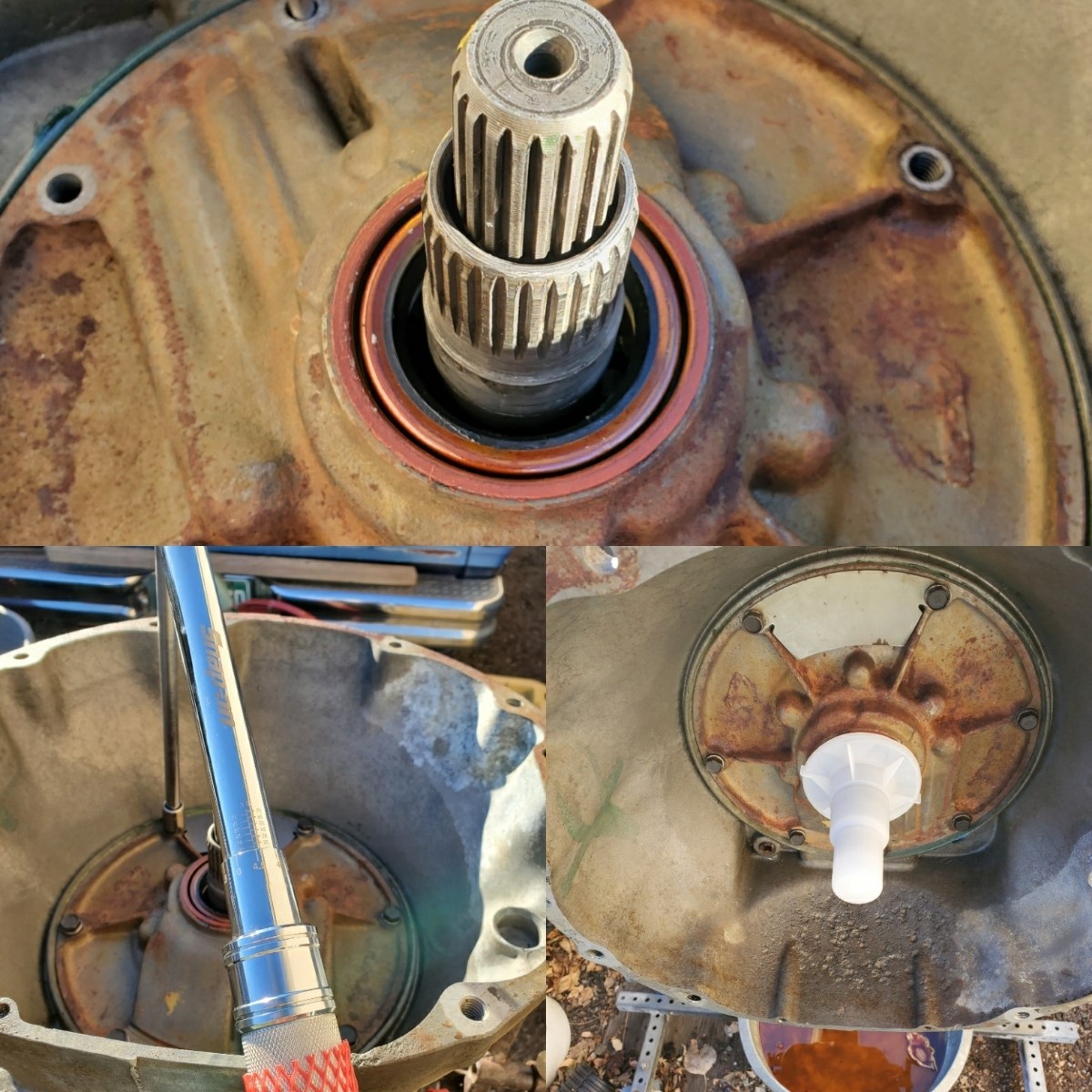

Finally a warm enough day to continue on the project, fun project. Just making sure everything is going to work, so far everything is great..

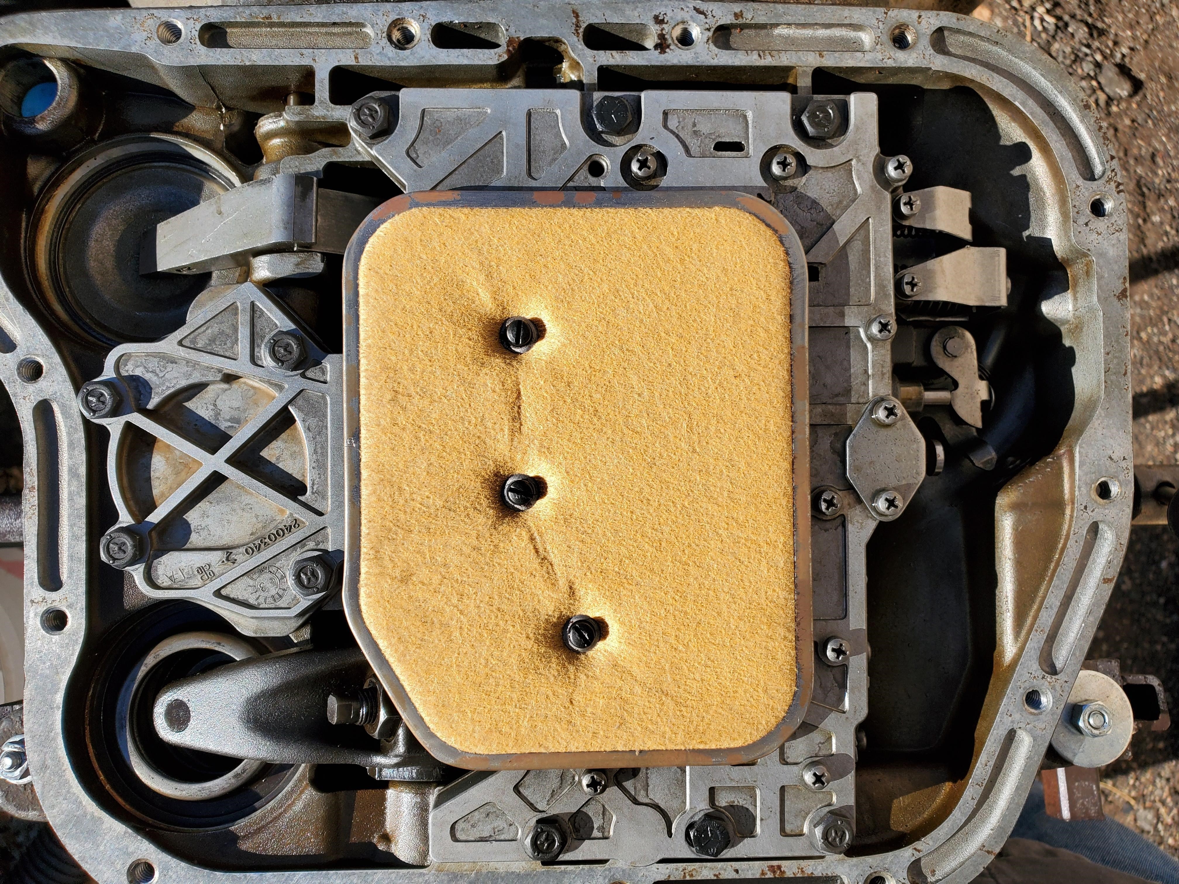

Cold and windy still, sunny though. Starting on valve body cleaning, repair and modification. Found some water damage and will require attention. Note the reverse lock out safety check, exclusive to push button or cable shifted transmissions, and the dual pump check valves, for front and rear pumps. I try not to expose my lungs to solvents if possible, working outside helps the most. you would be surprised how well paper towels clean, just by rubbing yuck off of the parts. Cloth rags forbidden, on valve body work. Nitrile gloves are the best. As you can see we have a small amount of rust damage, lucky we can steal parts from the 62 valve body.
5 Filter screen debris, pressure regulator springs and regulated spool valve.jpg

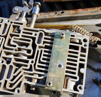

Celebrated New Years Eve and Day in Sheridan Wyoming and southern Montana. Arrived back yesterday evening, driving through a horrible wind storm for hundreds of miles on the return trip. This morning I went to John Quinn's to see what was happening and we went to check on vehicle storage and to repair a gate there. John wanted to check out the transmission project, so we retuned to my place and John supervised the operation being we had a nice warm day. Valve body modification and spring changes started, with separator plate drilling and filing required to illuminate any burrs and repair check ball seats, as the pictures show note valve body drill guide plate. John noted the forward look emblem cast into the valve body. I like the Gil Younger kits for the early A-727 transmissions.

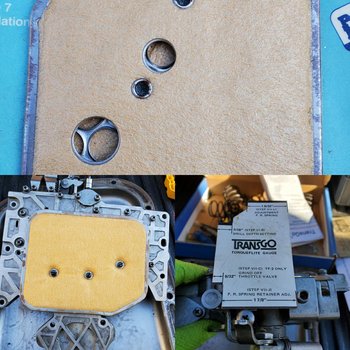

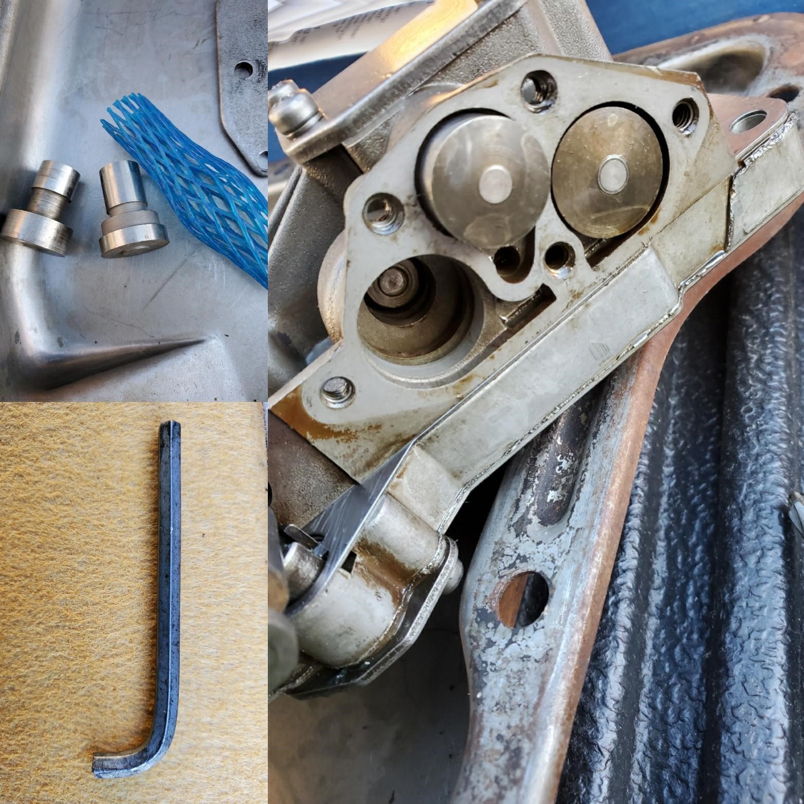

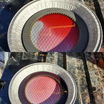

Completing valve body modification, New pressure regulator spring, 1-2 shift governor valve can be down shifted at high speed, I do not recommend this on push button transmissions it's too easy to have a surprise, if you select the wrong button. Cut down 3/16 Allen wrench for in case pressure adjustments, if needed. Note the Forward look and DPCD cast into valve body. cardboard adjustment help keeping everything square on pressure regulator and torque convertor switch valve. Dacron with two hole filter replacing rusted screen, I still used the cooling line filters a $45 dollar insurance policy, worth every penny. I will post breakdown of all cost parts and labor at the end.
