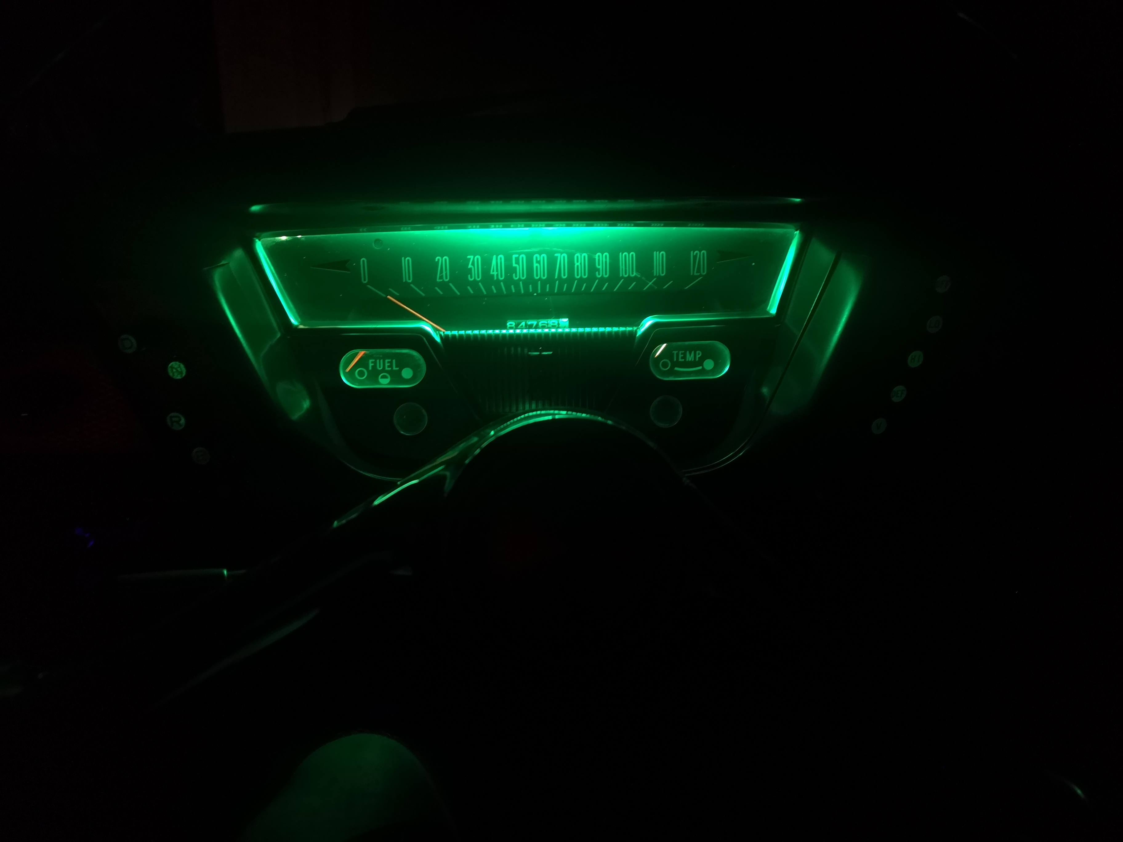

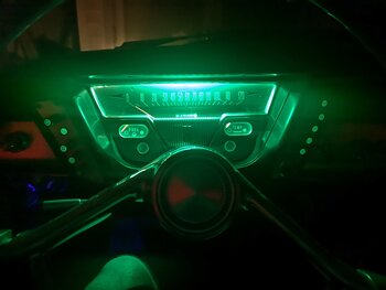

I too being a young 48 years old had trouble changing all three especially that high up center one with the tiny bit of wire. I lay on my back with my head squeezed in behind the gas pedal to get access up behind the console. NOT an easy way to do anything behind the cluster.
I changed out the bulbs with LEDs. You don't retain the dimming feature with LEDs of course, but hopefully last longer so I don't have to deal with that again for some time!
