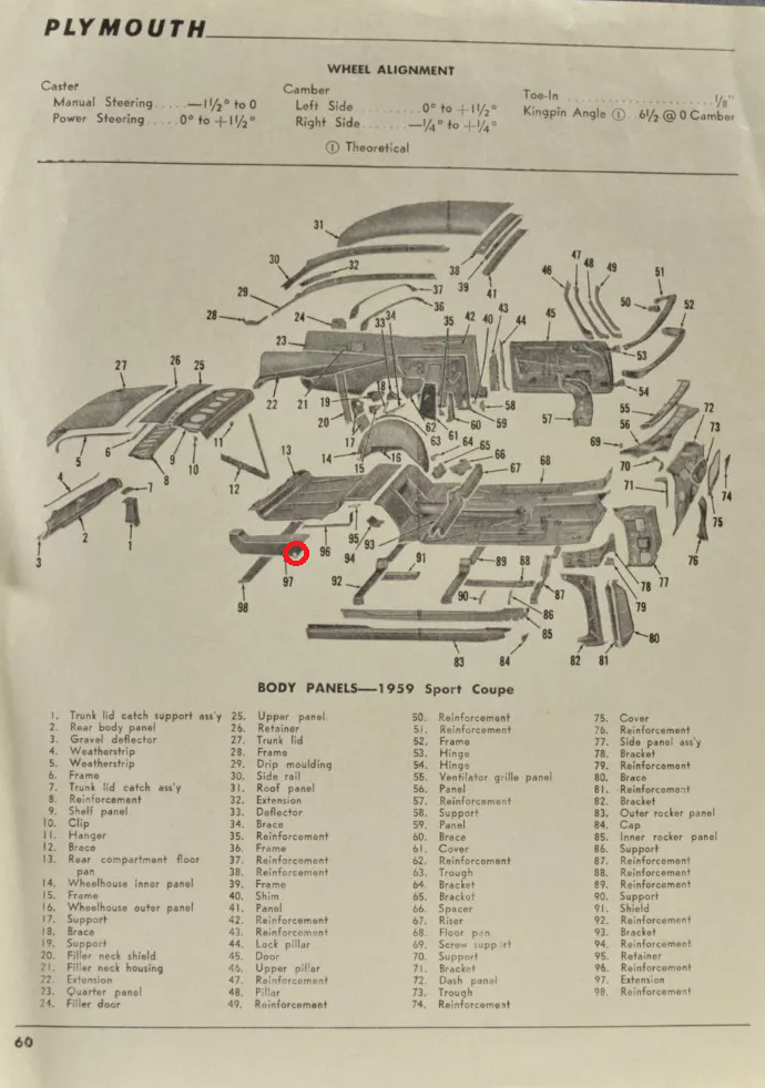

I'm unclear on what you mean by "trunk floor well extension panels" - do you mean, the vertical sheet metal panel that forms the inner side of the fender well, on either side of the car? Or somewhere on the horizontal surface of the trunk itself? Might you have a picture?

Surfing eBay, I found this collision parts list just tonight! Is 97 the "extension panel" you refer to, Dennis? In this diagram, there's a white circle that I've circled in red - is the that approximate position of the plug in your four-door parts car?

That's the one. listed in the parts catalog as "Extension, Rear Floor Pan Side" . Picture clearly shows a drain plug hole on the panel, but my 59 Fury does not have a hole there on either side. No repairs were done to these panels during the restoration process, and the rubber plug listed in the catalog (1836798, two piece drain type--whatever that is) is not the number I removed from my 59 Fury sedan parts car.(1810273) This number shows as being used in Dodges and Desotos only in 1959, and the number is molded into the rubber plug. I know stuff gets switched around during assembly; that might account for the numbers being different. My hardtop shows to be a Detroit assembly car, and I wonder if other assembly plants might have done something different.
